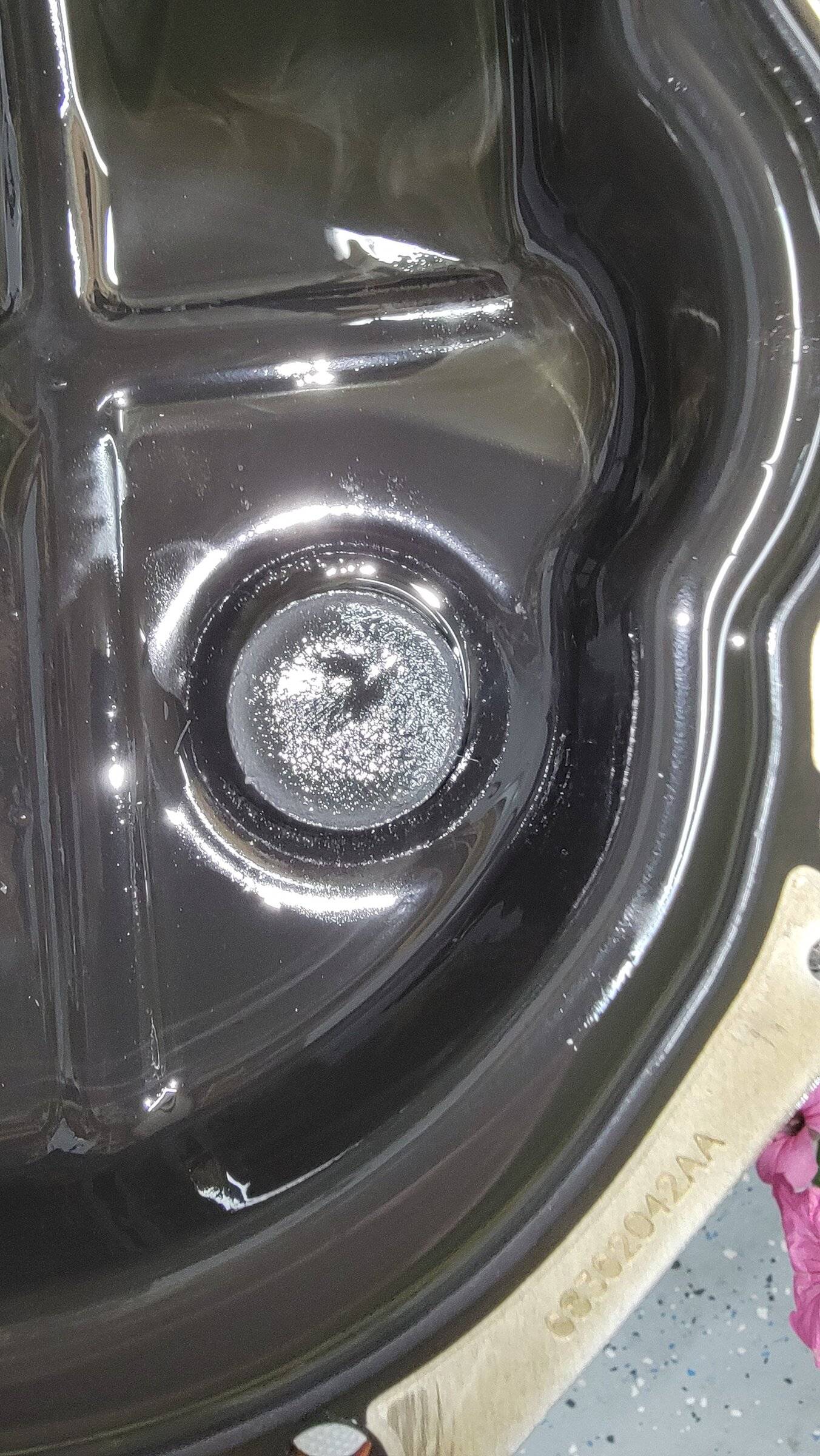

5. Clean the pan and magnets with lint-free cloths (make sure they are lint free).

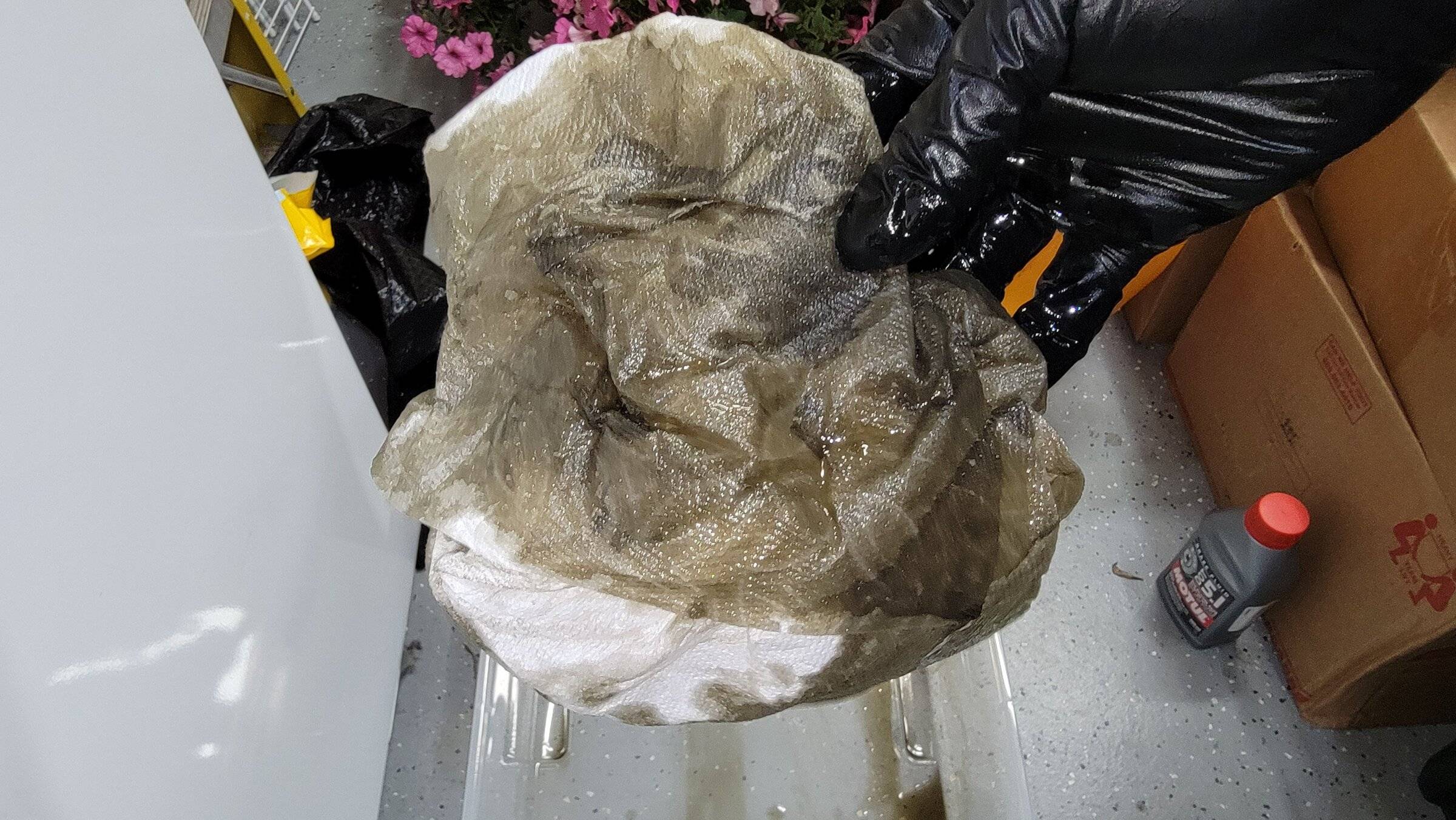

With all of that said, the fluid was VERY dirty as compared to the new fluid (see pictures). I would not under any circumstances run the fluid and filter for 100K miles or "lifetime" as FCA states. I think that FCA is doing a serious disservice to owners when they say "lifetime" fill--which is complete and utter bovine scatology.

Clean Pan and Magnets + New Filter:
Jeep Wrangler JL ZF8 50K Mile Transmission Service -- DIY How-To Instructions 20220521_153050

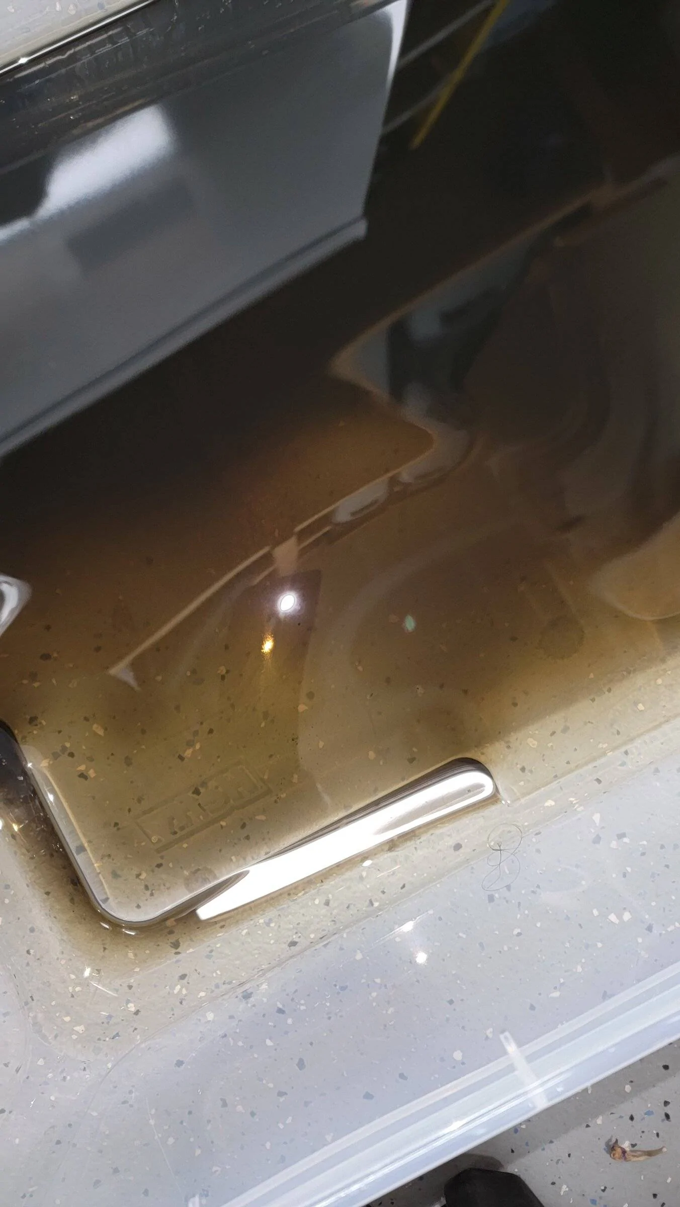

Old Fluid in Drain Pan:
Jeep Wrangler JL ZF8 50K Mile Transmission Service -- DIY How-To Instructions 20220521_163355
Old Fluid on White Paper Towels:
Jeep Wrangler JL ZF8 50K Mile Transmission Service -- DIY How-To Instructions 20220521_173030
Comparison of New and Used Fluid:
Jeep Wrangler JL ZF8 50K Mile Transmission Service -- DIY How-To Instructions 20220521_175322
