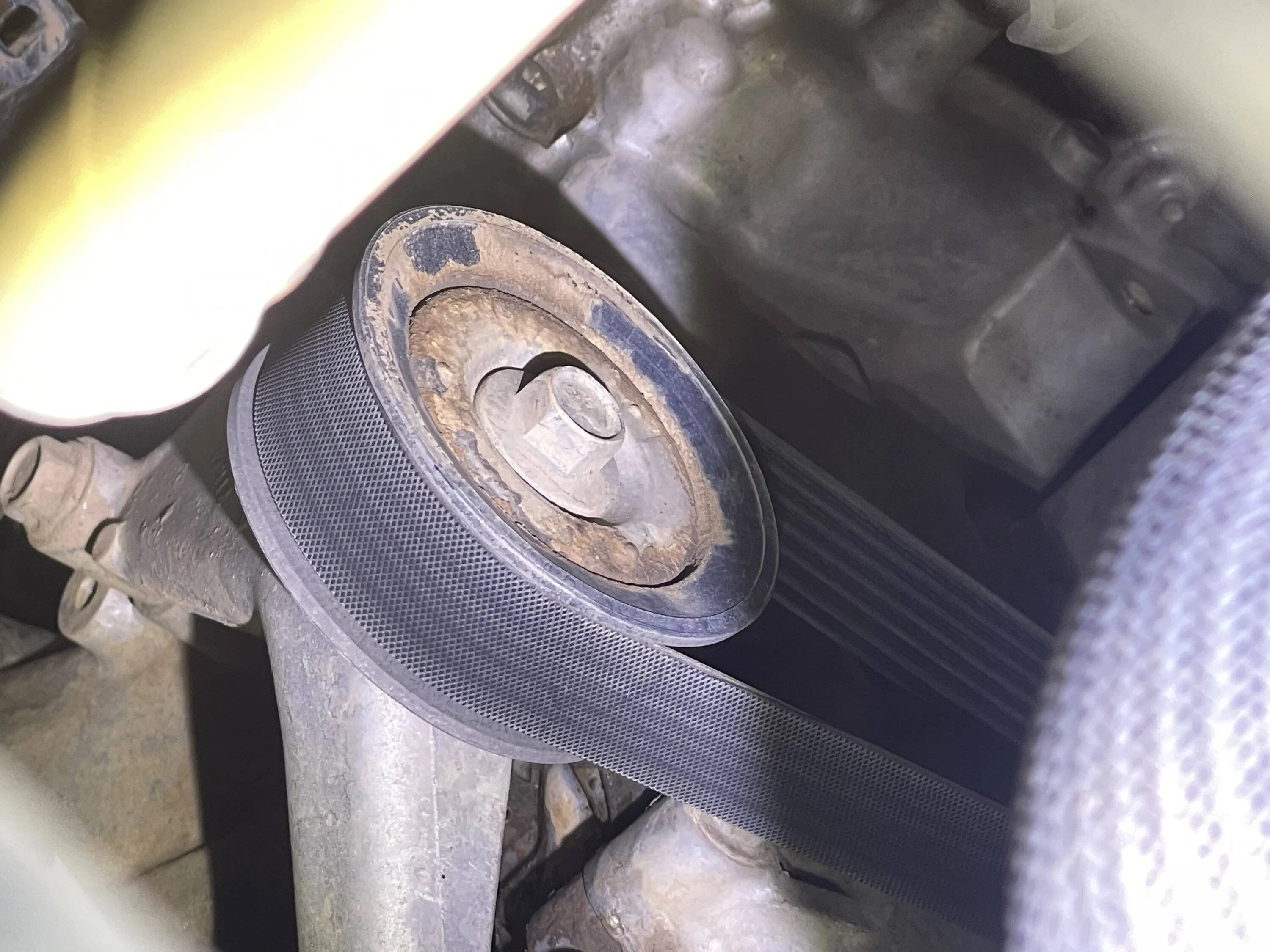

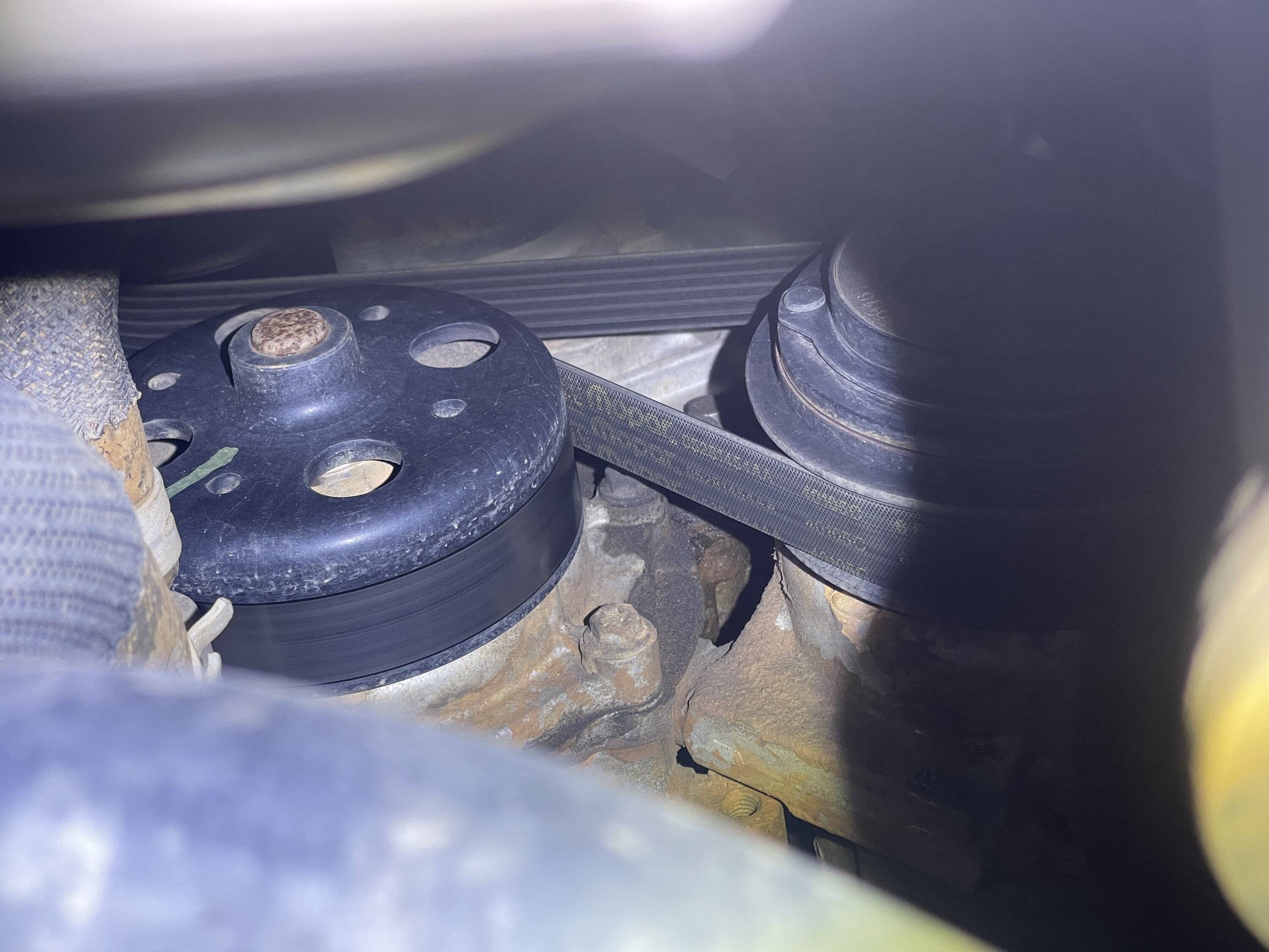

Jeep Wrangler JL 8spd Whine? Low Trans Fluid? IMG_6381
Jeep Wrangler JL 8spd Whine? Low Trans Fluid? IMG_6380
Found a couple possible culprits today. I noticed that one of the lower pulleys was super caked in mud around the bearing. I also noticed that my water pump has a small deep around the mating surface. Lastly one of the pulleys on top seems like it is moving in and out. No noticeable noise at idle/startup or while reving Let me know that you guys think! ?

I'll second the idea of investigating bearings and pulleys, as you've already started to do.
As for the 850RE, that's a whole 'nother conversation. Briefly, ZF themselves recommend fluid and filter replacement at approx. 60K miles. I've done it twice now. This thread is an excellent resource for if or when you decide to go down that particular rabbit hole.

When you go to check it out again, if RPM dependant, use a helper on the gas peddle... get yourself a decent 3-4' piece of water hose or a 1/2" diameter 2-3' dowel to help you pinpoint the noise, just hold either up to your ear... the noise will jump out at you.

That engine bay is filthy man, I would start by cleaning it off. If the noise does not occur in park with RPM ~2000, check the driveshaft. It wouldn't surprise me to see the rzeppa joints failing due to mud intrusion.
Doing a deep clean today! Going to clean and try to throw some lube in the bearings and joints. Will inspect the Rzeppa joints too.

Update! The whine is gone! Looks like the whine was just her screaming for a good engine wash?. definitely learned my lesson regarding cleaning after off-roading.
I think ones of the bearings on the pulleys is still bad though. I put a long screwdriver on each one and noticed that the one that the one furthest of the passenger side sounds a bit more rough than the rest.
