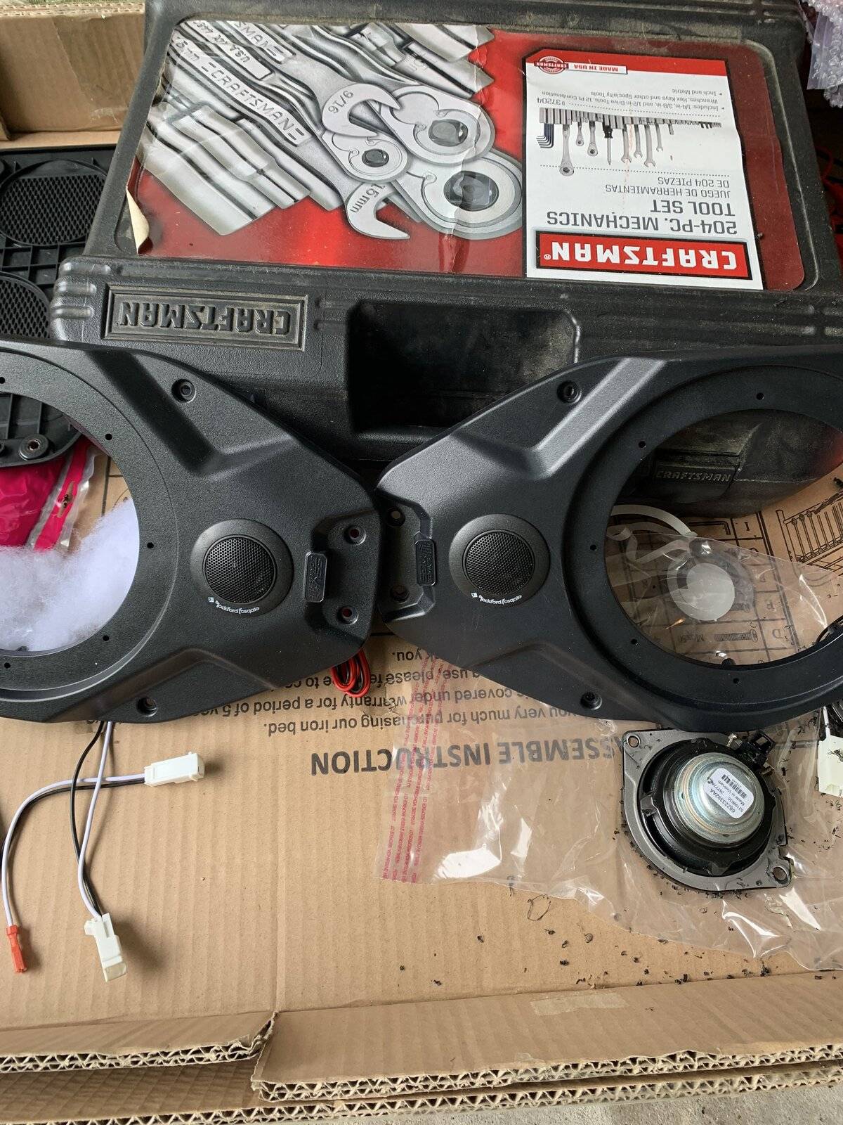

Soooo...these Fosgates have to go back. Reason being: they are TOOO SMALL!
Spent an hour on the phone with crutchfield, who is awesome talking about it. They were convinced that I was doing something wrong.
contacted SSVWorks, who informed me that while it is for a 6.5” speaker it actually needs to be a TRUE 6.5” speaker which is actually a 6.75” speaker.
the Fosgates I got was only 6”...they used the mounting tabs to make it 6.5”. I ordered the P1675-S component set and before I drill out the larger tweeter hole, will mount in the speakers. I am seriously contemplating removing the sound bar to do this but it seems like it’s a tedious ordeal.

New speakers should be here today and I think I am going to remove the soundbar. I think it will be just a ton easier to do talk the speakers that way can fighting gravity while installing...
that said the speakers should actually line up this time and maybe it will be easier. We shall see

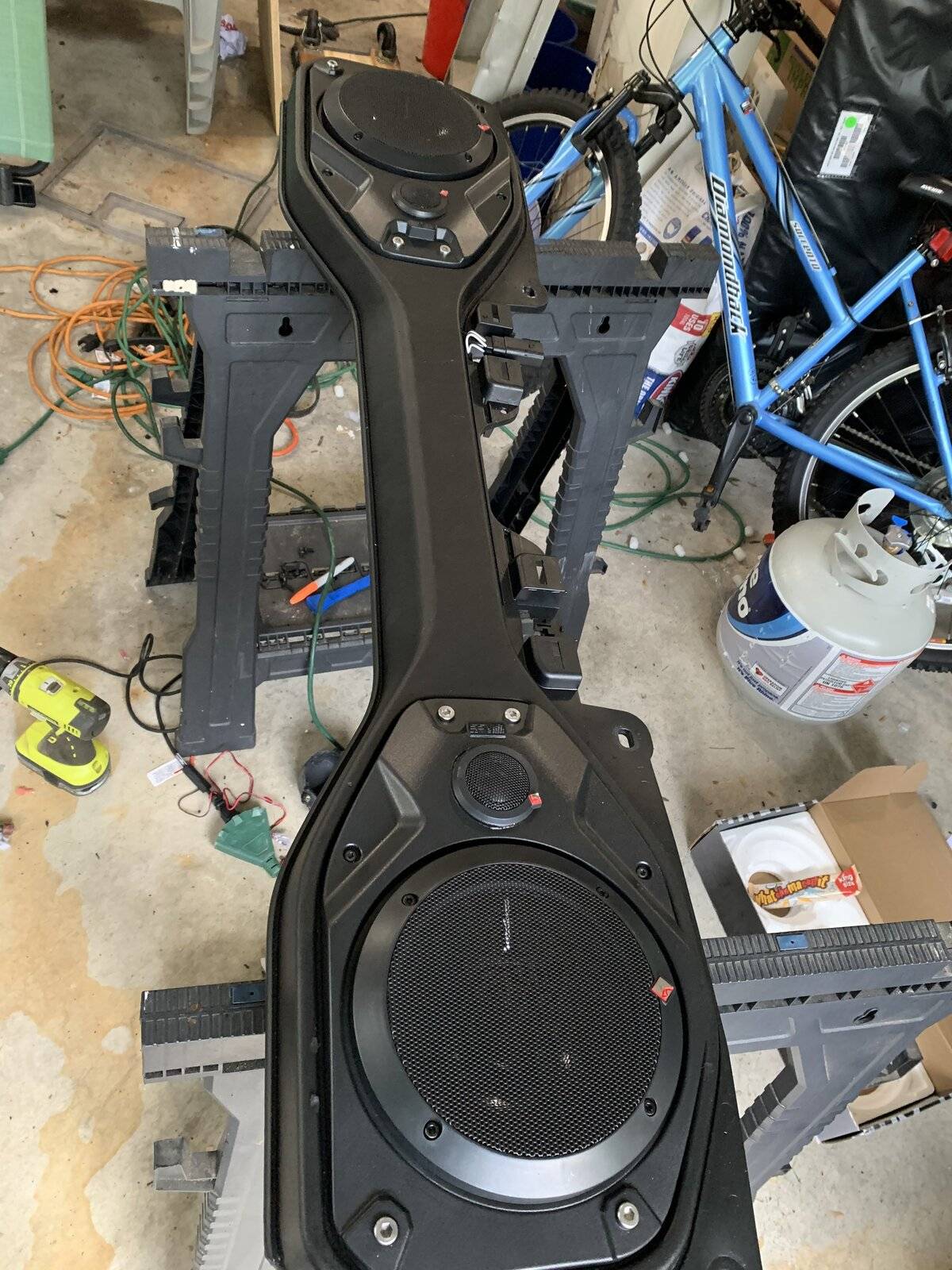

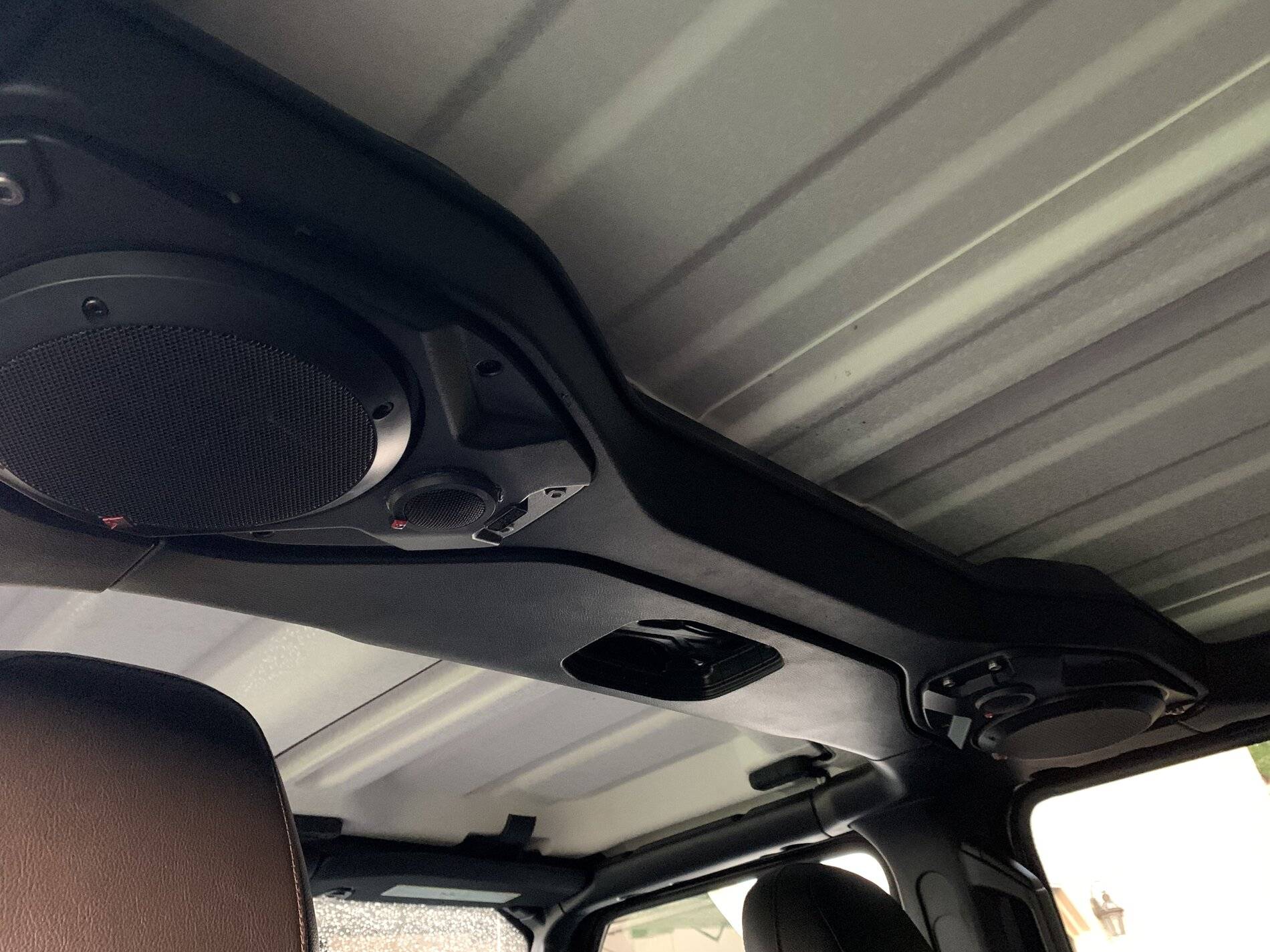

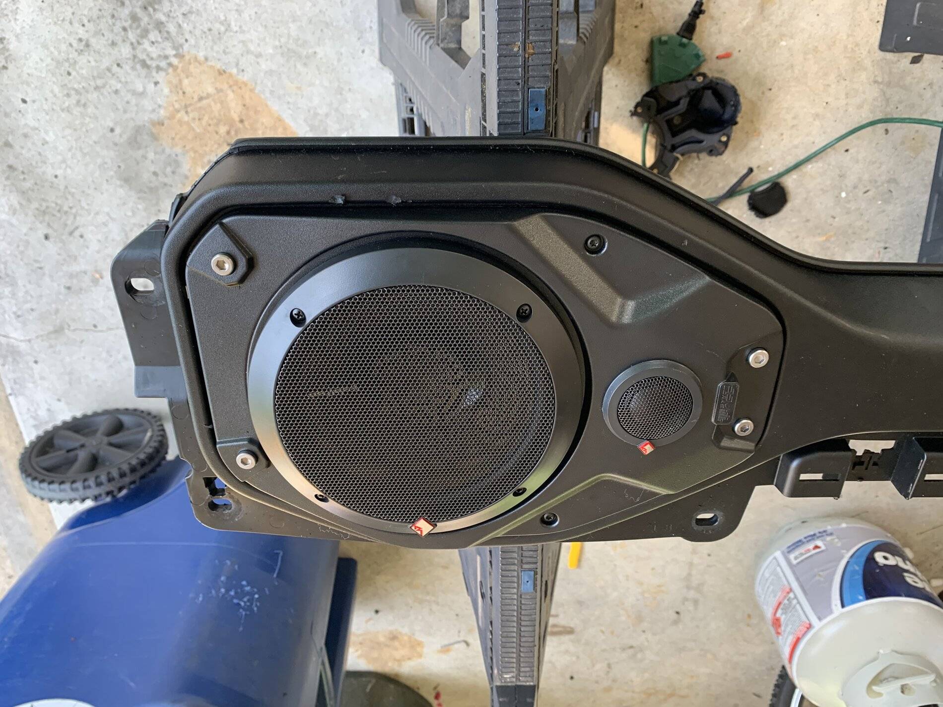

All done. Removed the sound bar. And did my trimming. Install was a breeze and the only casualty was the dome light clips broke. I need an oil change this week and may have them just put one in.

Just a couple of questions. First, how was the removal of the soundbar? Second, what did you use to for the cutting? Nice job, btw.
