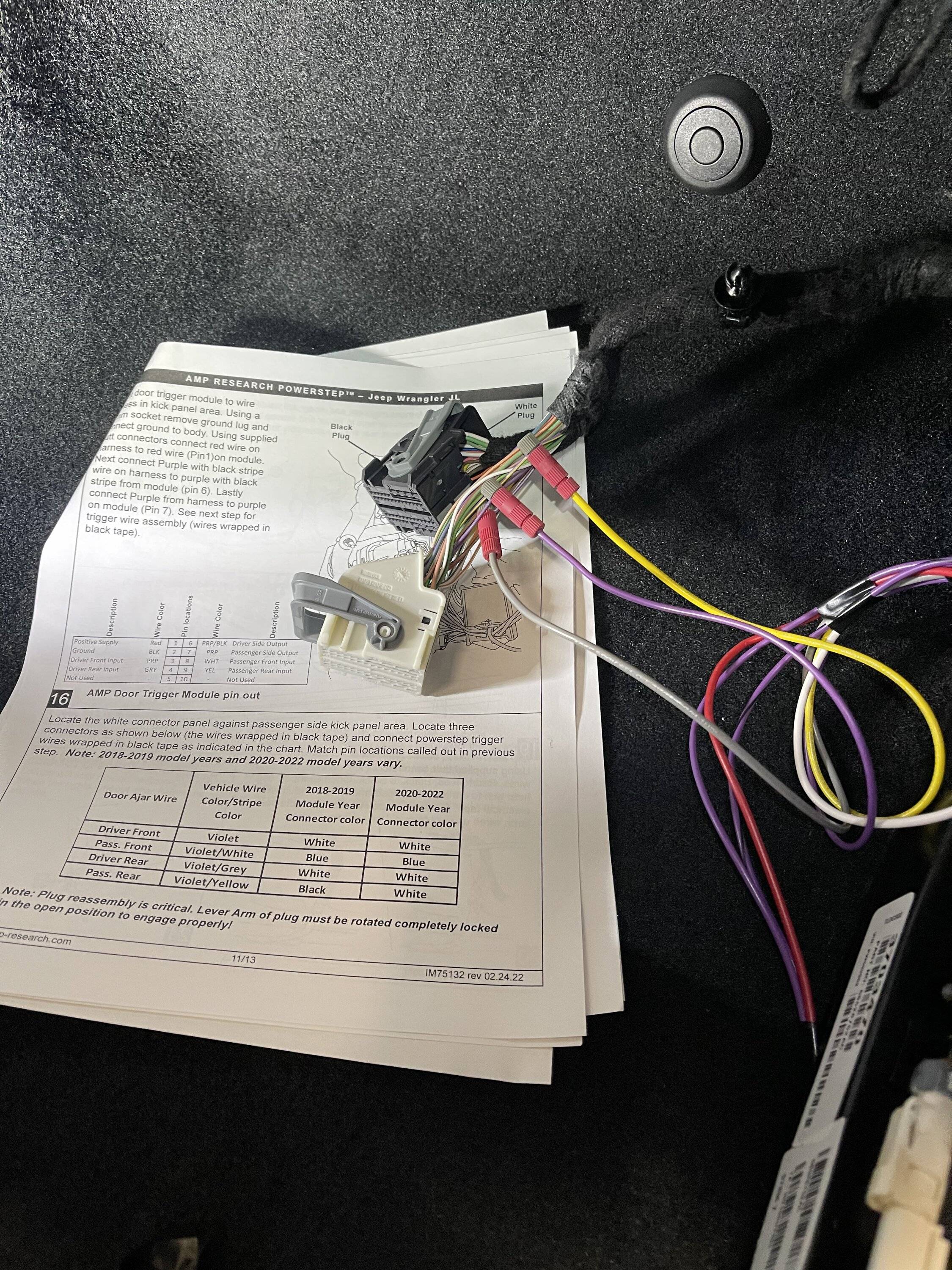

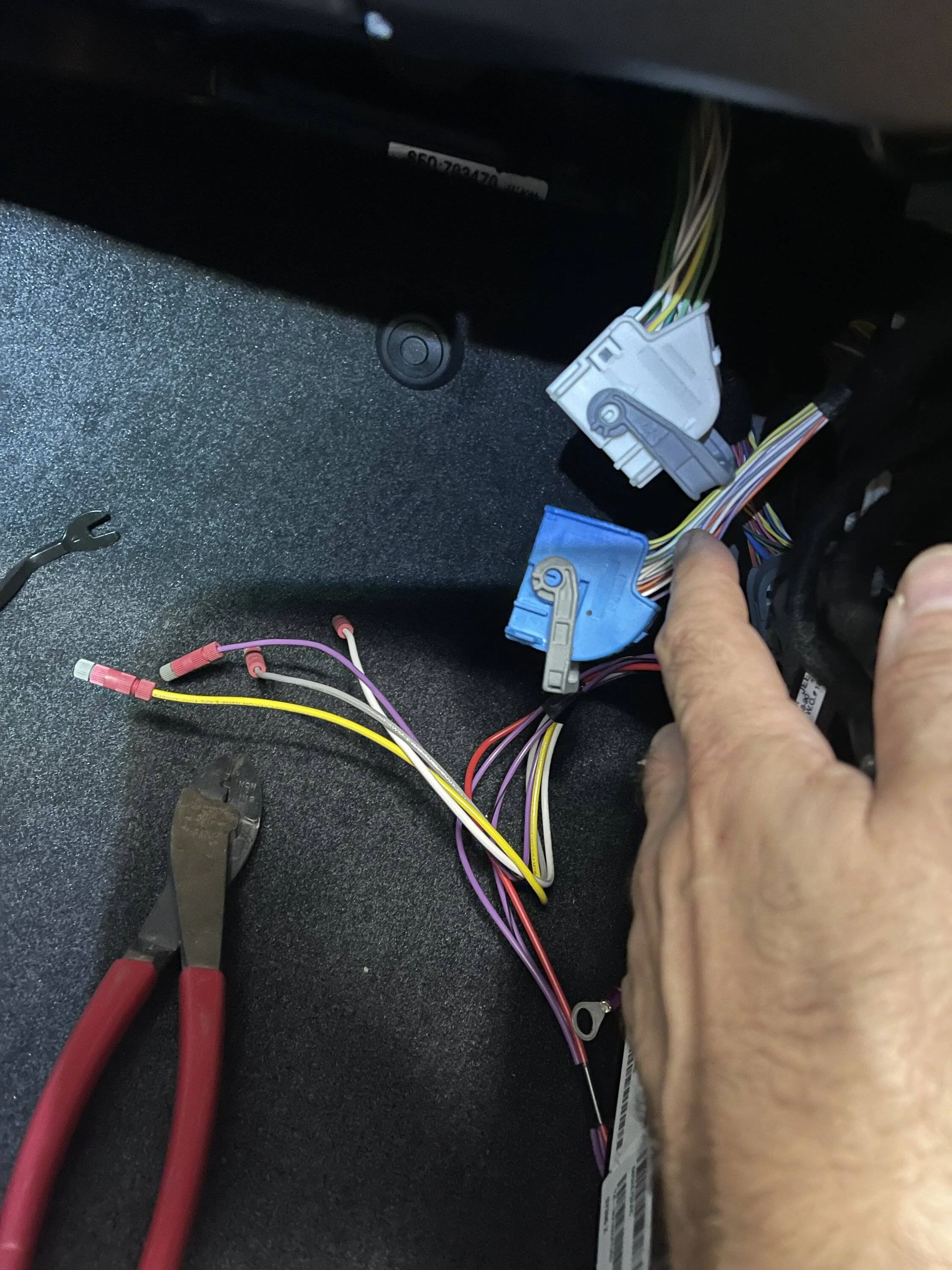

The only thing that I did is unplug blue, black, white plugs on passenger footwell so the that I can reach the door trigger wires that you need to tap into.

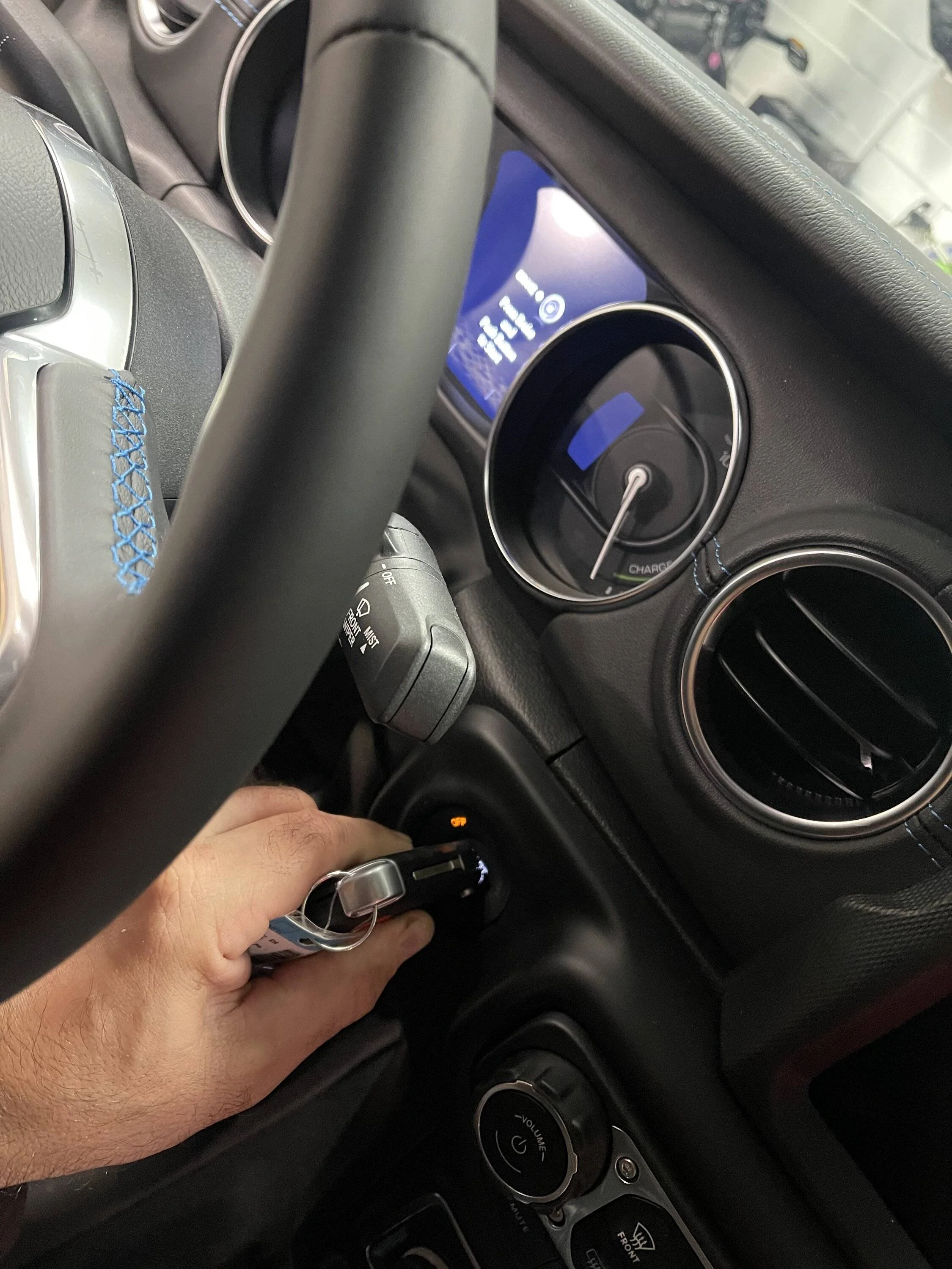

You try pressing your key fob directly to the start button and crank it as normal (foot on brake)?

What do you mean pressing key fob to start button? I was holding brake pedal and pressing start button while keyfob is in the car and it didn’t work
Try what @TaiMc said - your fob has an RFID chip embedded that can start the car, so push the start button on the dash with the fob. Worth a shot at least!

That didn’t work :( I’ll try unplugging negative terminal for 10 mins and see what happens.
