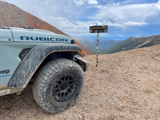

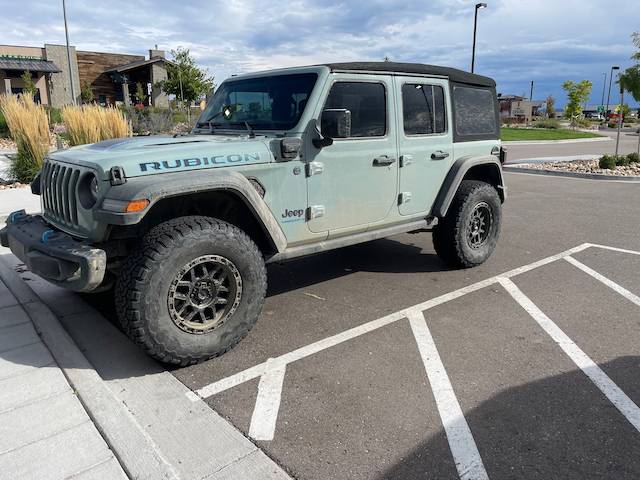

35's look incredible on the 4xe. Here's my 315/70R17 KO2s without any lift. I love it and don't think I will lift it.
Jeep Wrangler JL 4xe. Ko2 34 inch tires? IMG_9767
Jeep Wrangler JL 4xe. Ko2 34 inch tires? IMG_9801
It rubs a little bit when it's all flexed out, but it's just rubbing on the inner plastic fenderwells. I can't imagine its hurting anything, so I'm fine with it and will wheel the hell out of it like this.
