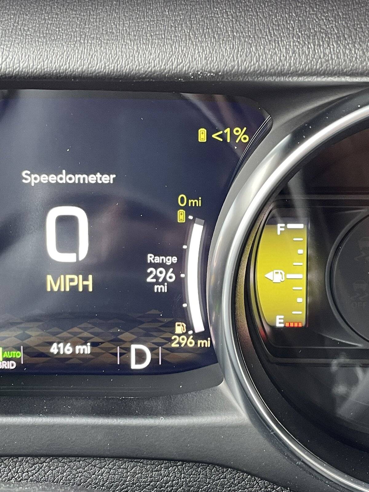

Hi Guys,
So this is my 2nd full gas tank in last 3 weeks of my ownership.
Whenever i fill the gas tank to full, the pump clicks when the tank is about 7-10% empty, (See attached screenshot)
Any idea how to get it to full? I know i can pump more gas manually after the click, but shouldn't it fill to full automatically?

Gas look ok. Battery is low.

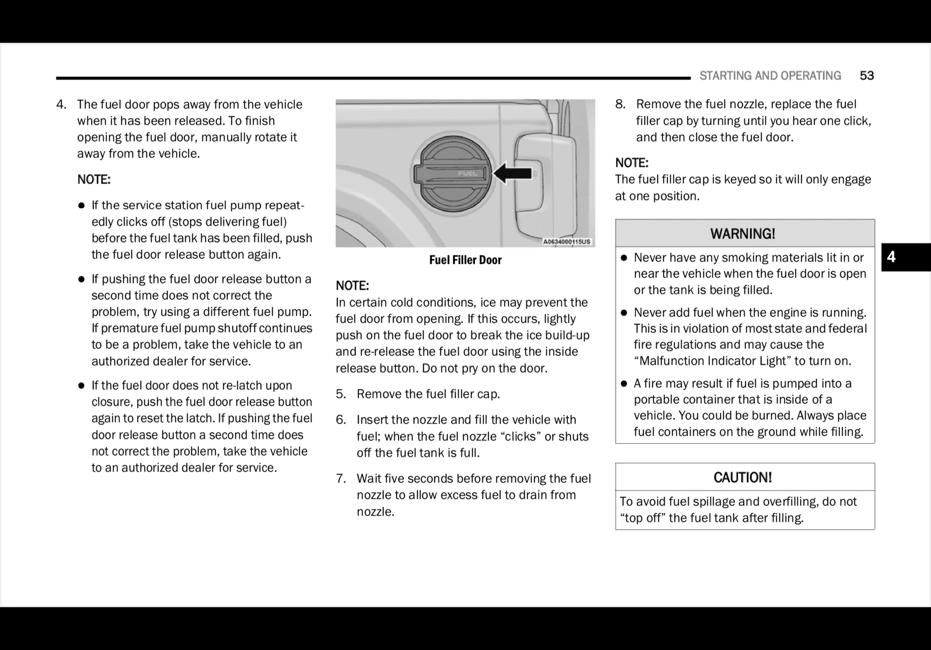

@CherryWrangler The solution is to press the fuel release button again, after the gas pump shuts off. I did a 6K mile trip before I learned this trick. :headbang:
All 4xe models work this way. It’s related to the fact that 4xe models have pressurized gas tanks in order to ’lock in the freshness’ for those folks who charge regularly, take short trips, and use very little fuel. Pressing the button depressurizes the system for safety before you fuel up. Pressure builds up during the fueling process, so I’ve found I can get another gallon or so in there if I press that fuel release button a second time.
Here’s the relevant page from the Hybrid supplement manual that tells you to press the button a second time (see first bullet point on left side of page):
Jeep Wrangler JL 4xe full gas tank issue 42E080DE-FDE1-459C-B27C-1793EB2EA4DA
Wow, didn't know they would make it this complicated. Will try this trick on my next fill-up. thanks!
