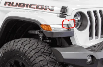

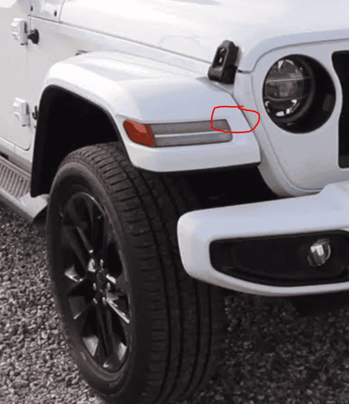

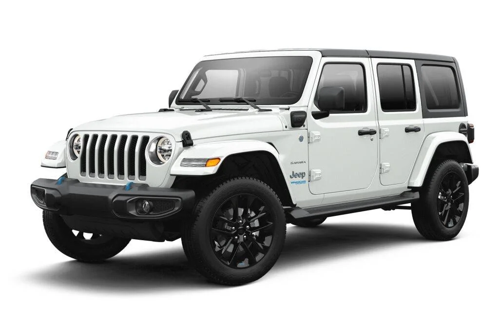

I have not taken delivery yet but I am noticing differences in pictures so far and wanted to see if there was confirmation anywhere. I know there are regular fenders as in the first picture, highline fenders as on a Rubicon as in the second picture, and in the third picture it seems the 4xe Sahara fenders might sit between these. Am I correct or looney?

The first pic is a euro model. You can tell by the front bumper length and mirror side markers.
Not sure there is actually a difference in the fenders, though.

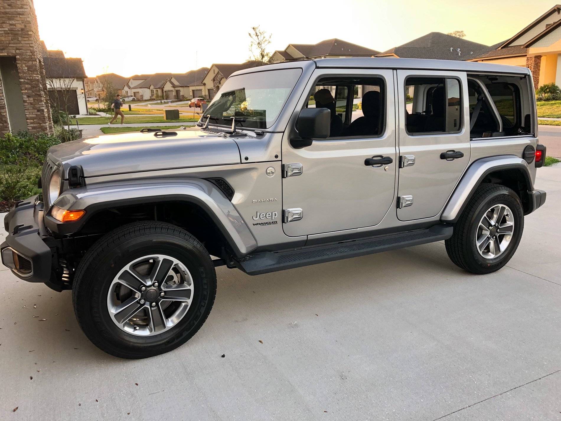

Thank you for pointing that out. I have added another picture here. I am seeing a difference in maybe how they are placed? On the regular there is a sheet metal crease that goes almost to the front of the fender. On the 4xe that crease seems to stop well short. Is the regular fender just mounted higher?
I first noticed the difference when I saw body graphics that could fit in the elongated crease on the regular fender but it does not look like it would fit on the 4xe.

Note, your third pic is a high altitude. May just be a form difference as the HA has body color below the DRL.

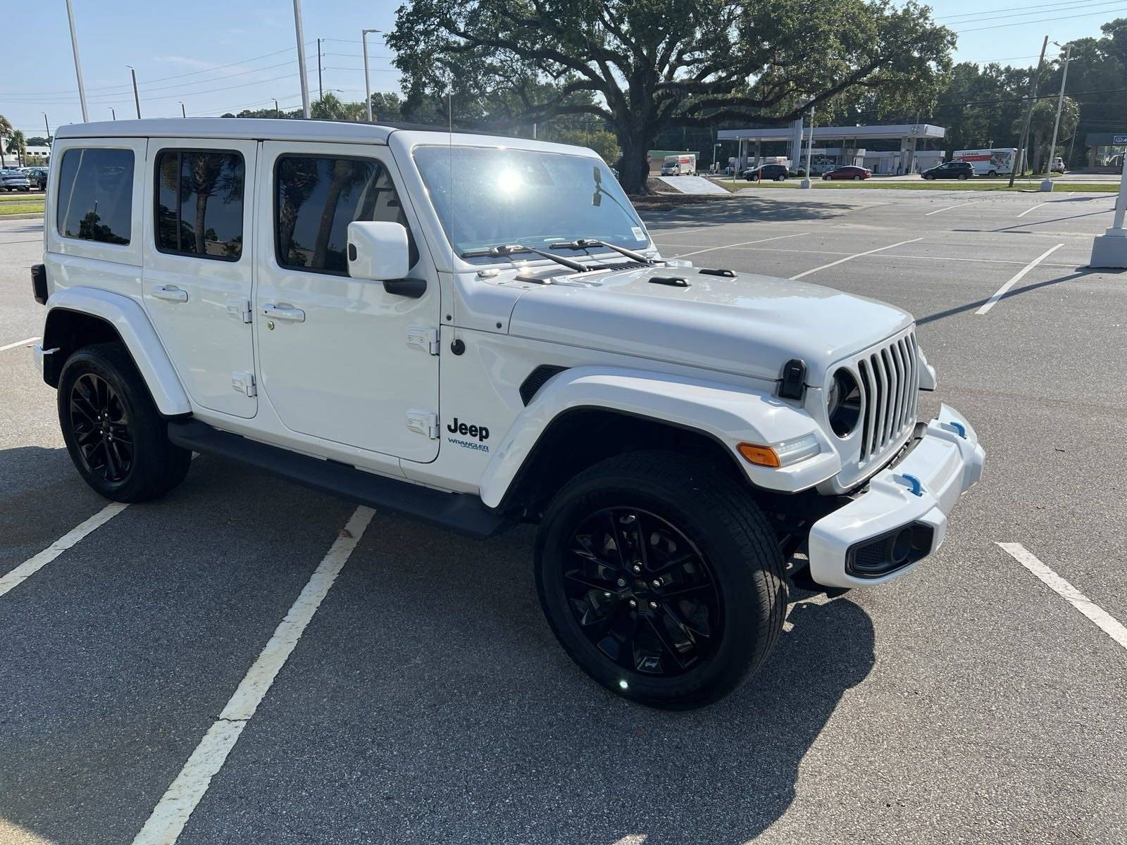

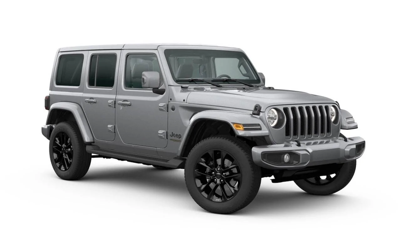

High altitude does have unique fenders different than the fenders on the JLUR/JLU sport/JLU Sahara. Notice on the JLUR the fender light has a cut out that stretches the entire length of the fender. The high altitude fender is like a painted version of the sport fender with a higher clearance
