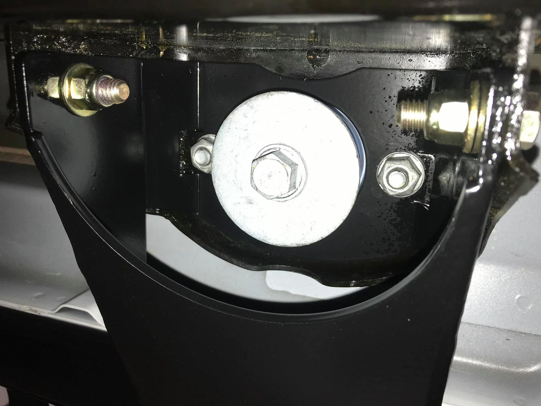

I have been eyeing up these Rusty rails for some time now. How was the install? Do you have to take out the body bolts for installation?

Took out the 3 body bolts a side, front goes back with just the body bolt, the 2 rear mounts you also use the frame bolts on either side of the body mount, as well as drilling a hole each side for extra bracing. I used a jack , but they fit super snug in between the body mount pocket, little bit of chain lube helped slide them into place. But I'm ok with that as my last rails folded up into my body when I hit rock, being only mounted on the body mounts and not frame.

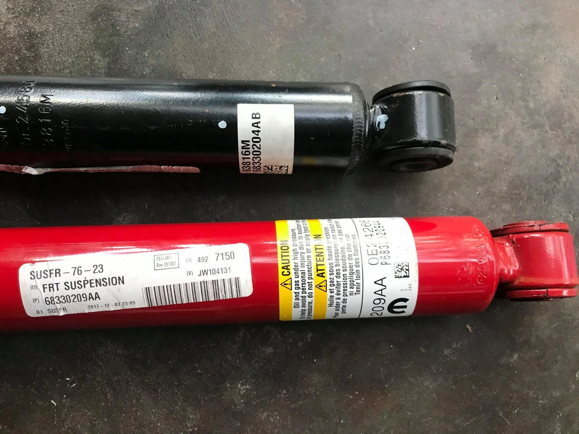

How did the radflos ride compared to the 3.3’s and now the RRD?
The Radflos were too stiff for Daily driving IMO. The faster I went over bumps, they were perfect. I could hit the large train tracks by my house going 50 and not spill my coffee, lol. But every little dip or gutter was really stiff going slow. The RRDs are much better for DD use and still really smooth going fast as well.

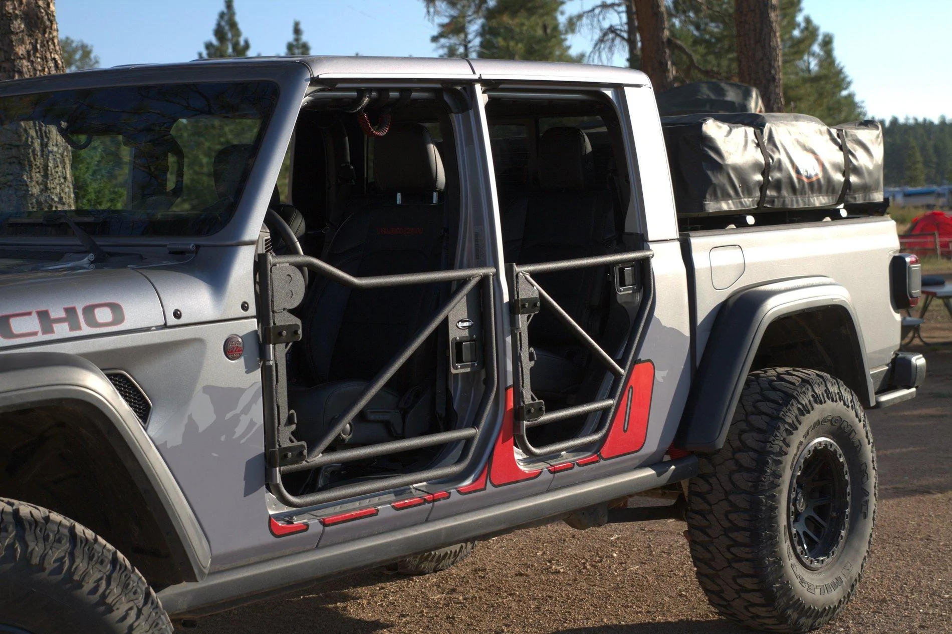

I know this is an old post, but we just released "official" JL/JT tube doors :)
AND they will work with SpiderWebShades too :)
(You may have seen them, since CP has had them for a bit)

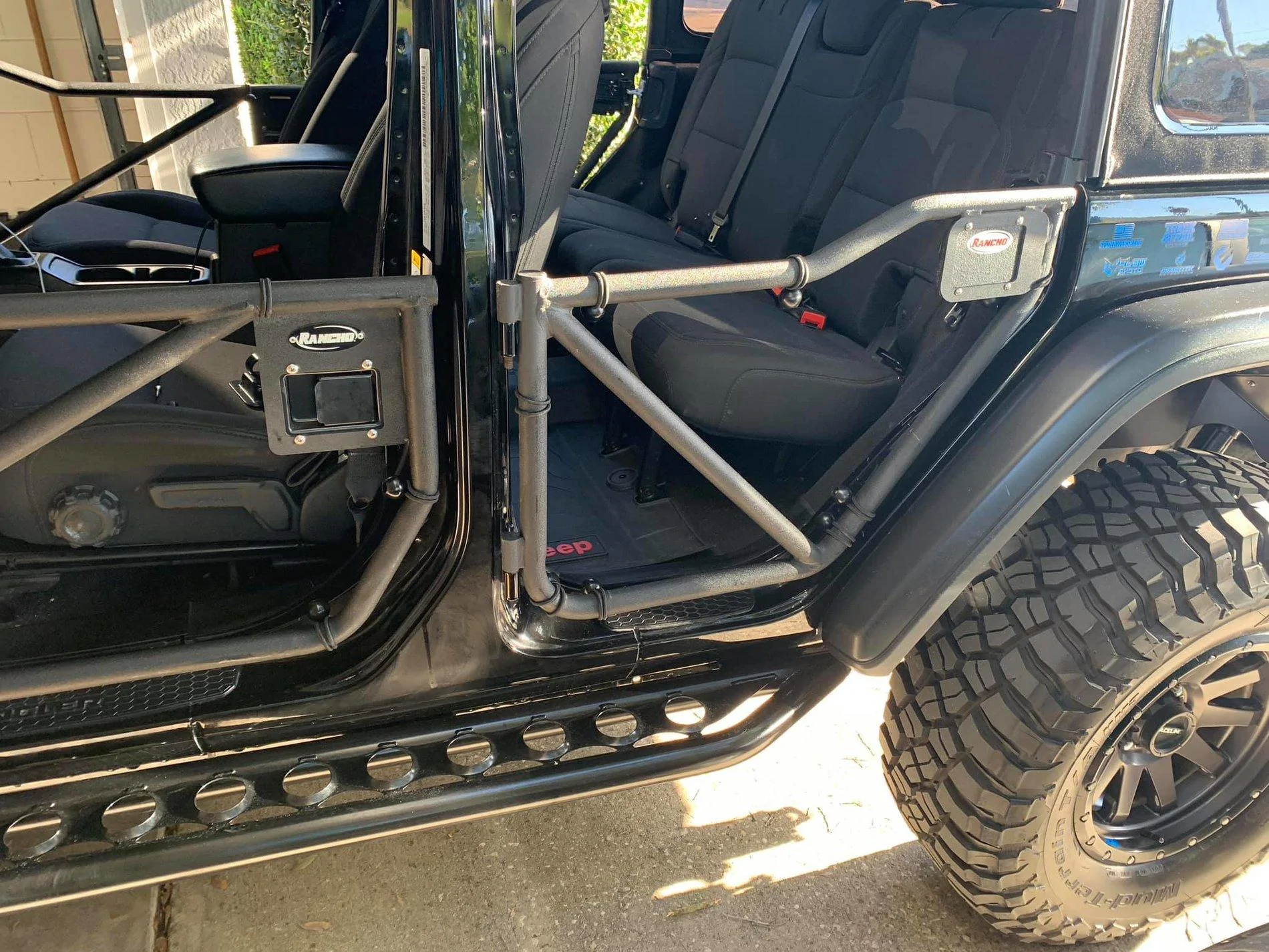

So the Doors are Rancho brand from my JK. They fit the JL in the front, but the rears they are redesigning. I had to remove the rear handles and just bungee to latch with the spiderwebshade ball.
Nice!
Rancho, I have to get over to SWS to photograph those! But in the meantime figured you could appreciate the mod I did to the JK doors. Flipped the rear handles left to right/upside down and built a spacer/adapter plate to mount them
