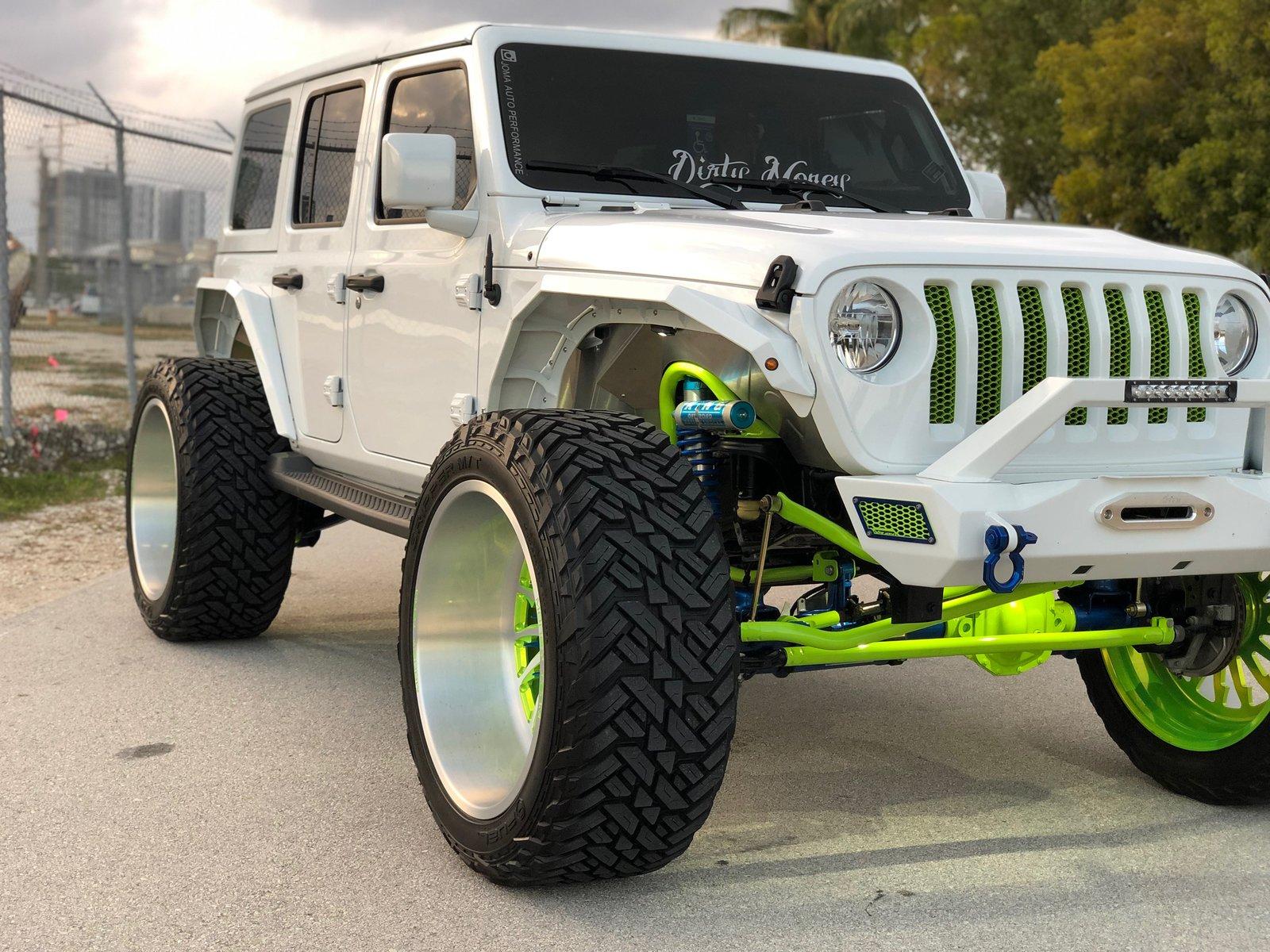

We did complete it, Cooper SST Pro 40x13.50x17s. Machetes beadlocks, 5" custom spun dual rate springs, All 8 Core 4x4 tier 5 control arms, Johnnies on both ends, Chromemoly trackbars, Fabricated sway bar links, Adams driveshafts.
Looks awesome! I just picked up a set of 40" tires, just trying to figure out what wheels to get(Should not have sold my XD Machete's)
Can you tell me how much clearance you have at full lock on the frame and grill? I'm trying to go with a slightly less aggressive offset beadlock, but I'm concerned the tire will touch the frame at full lock. I don't mind trimming the grill if need be, but won't chop up the frame.
Thanks

Mine touch nothing if you go with more backspacing than 3.5" you will have issues.
Thanks, that's what I was worried about. Is it possible to measure or take a picture of how much clearance you have at the frame at full lock? I'm not too concerned about the grill/fenders etc....

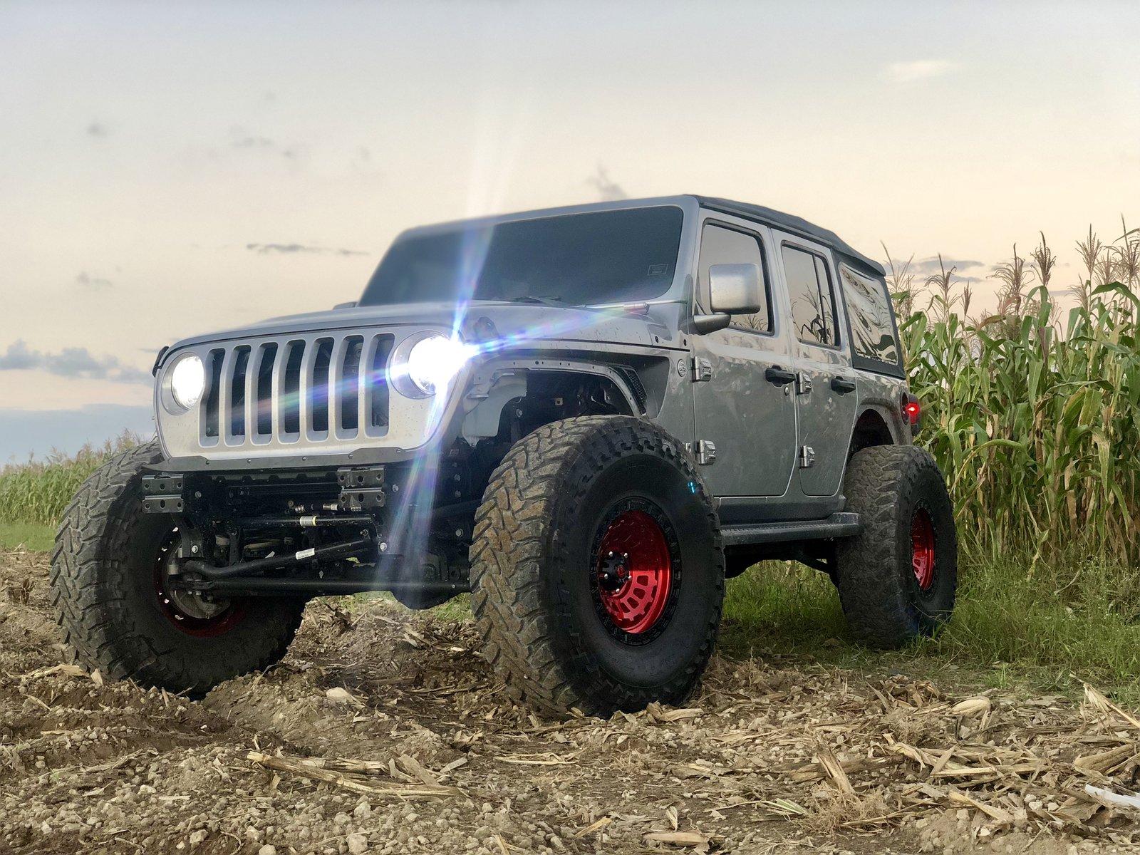

42’s on mine. It’s coming together slowly!
looks like that light bar says RC which is the Rough Country 50 inch light bar is that right?l What brackets did you use to mount it with what company is it ?
