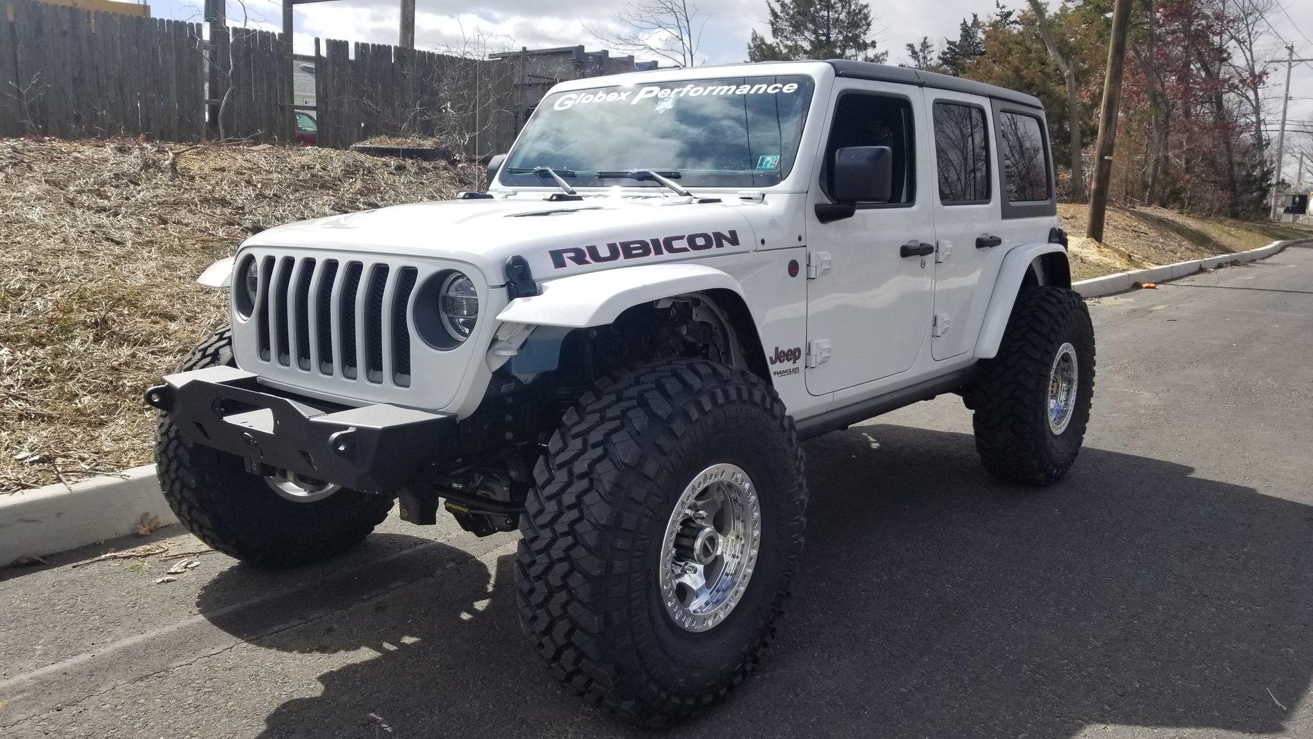

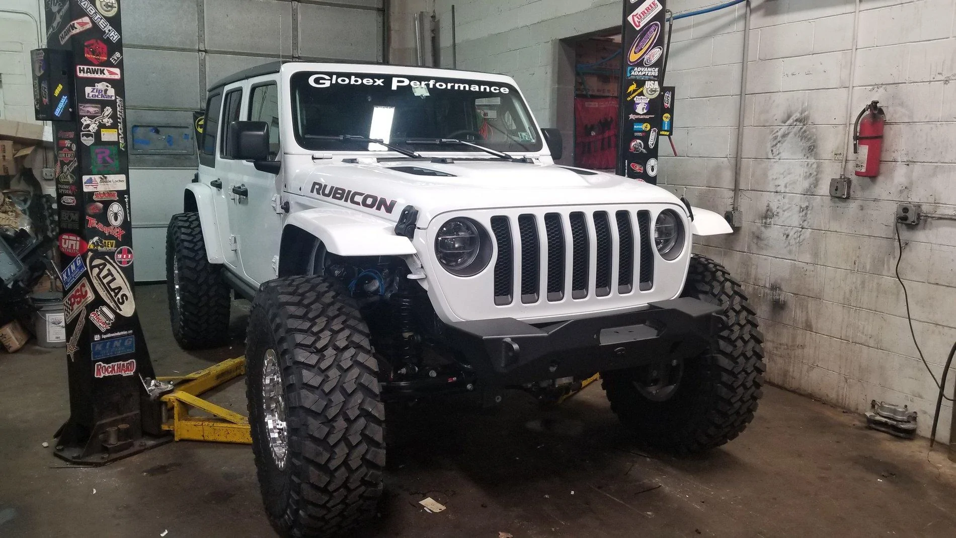

Do you have to change the axles if you're just going to go on road and not much off-roading just change the gears or will it break the axles I've heard it will break the axles. That looks so damn good. Did you put that bracket underneath there that supports it with the turn signal that ARTEC sells for like a 130 ?
I'm sure you don't have to change the axles and I'm not the design team who designed the new axles but my guess is that they aren't designed for 40s if you plan on using them offroad without being cautious with throttle. I see plenty of dana 44s come through with broken spider gears and other diff issues with 40s on. Me personally I like to be able to use as much throttle as I need offroad and not worry if a axle shaft is going to fail or my ring gear is going to loose some teeth. The one tons give me that security. Nothing is unbreakable but I tend to build what I know works for me.
We did wheel with plenty of stock rubi axle 40s out in moab but that was one trip and I dont think anyone has enough real world data to say for sure either way. It would be great if they hold up and will save a bunch of people money so I guess only time will tell what the weak points are.
I do have that artec bracket installed. I love it. Took care of the floppy flare issue and gave me the turn signals/marker light back.

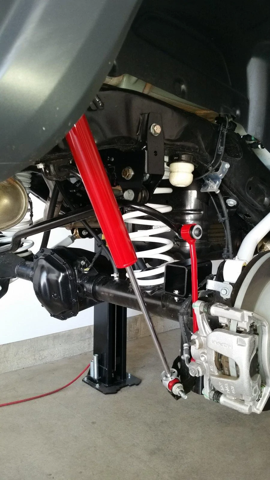

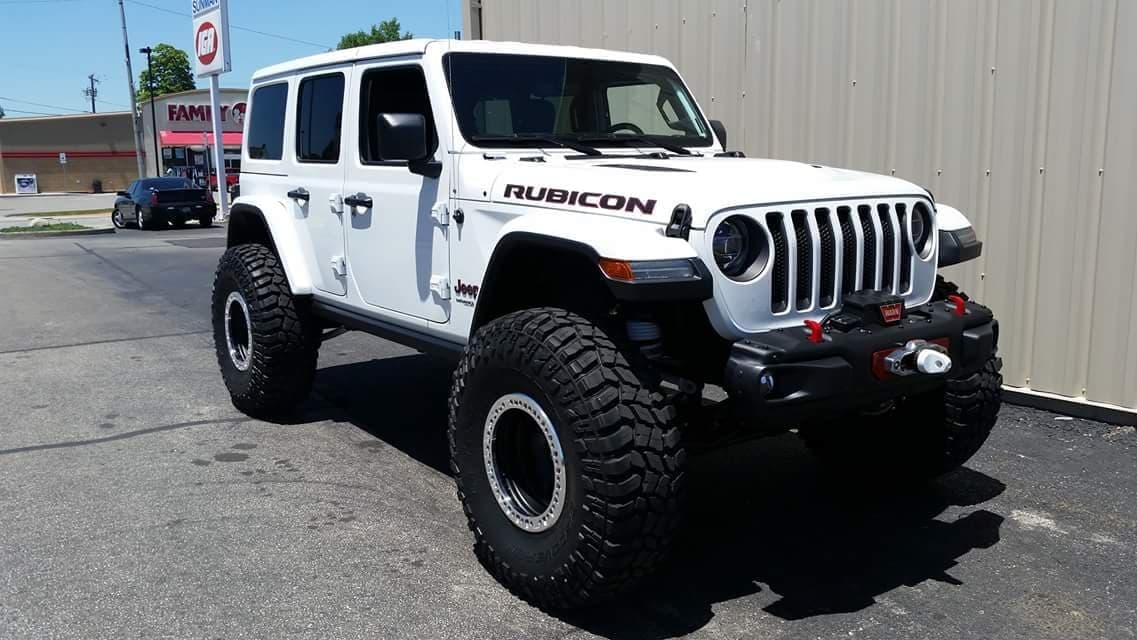

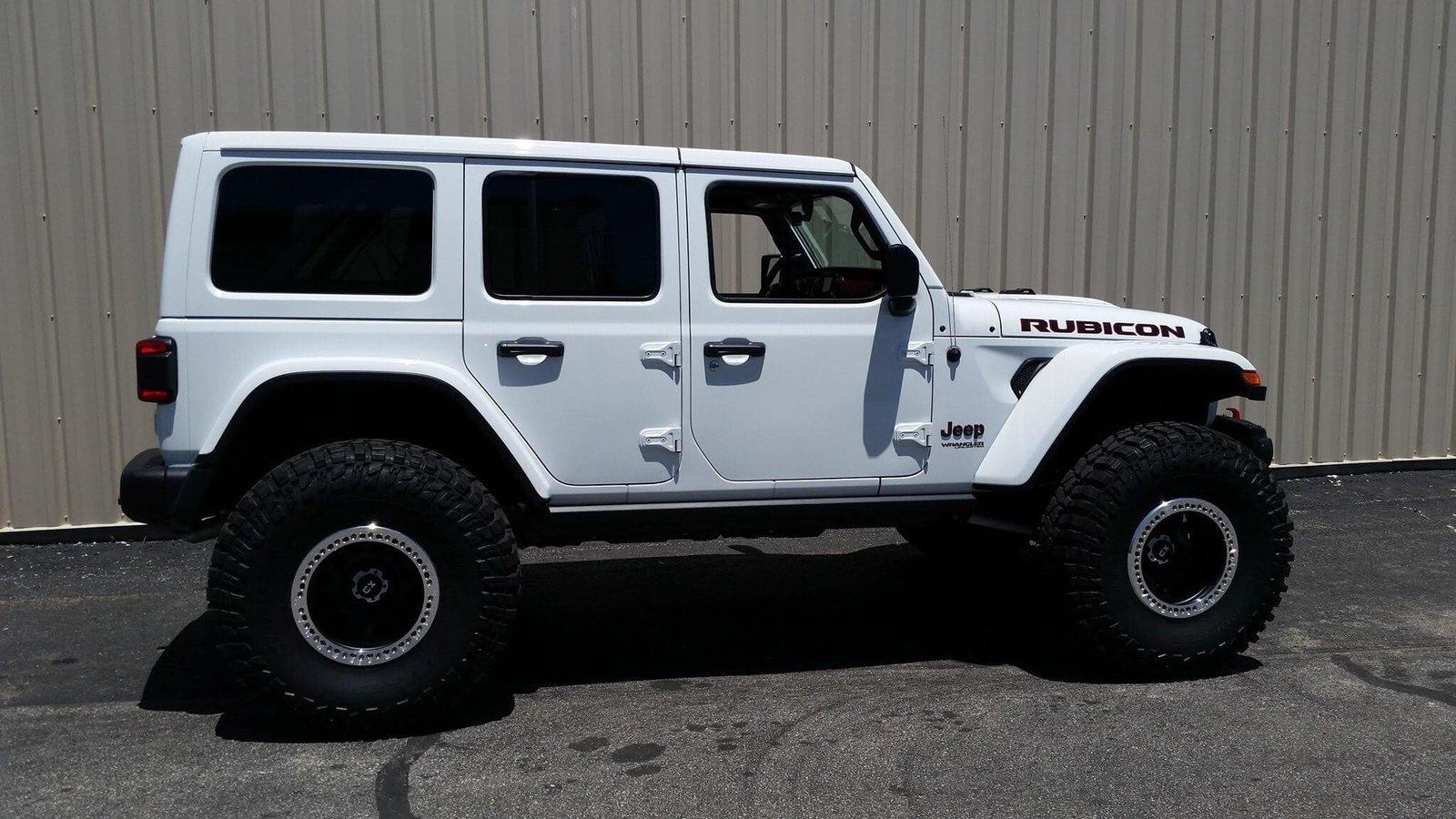

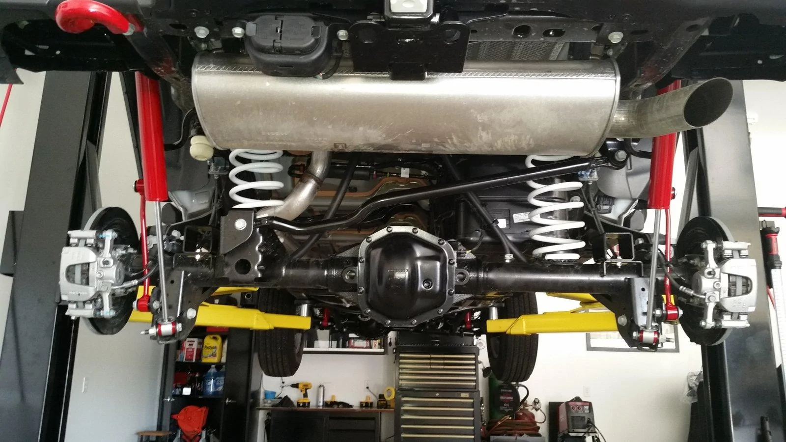

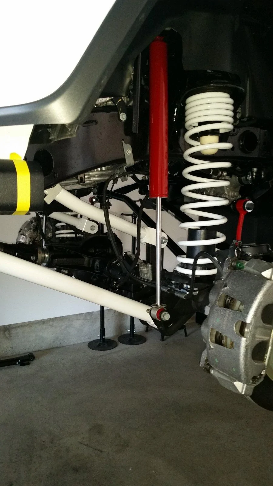

We did complete it, Cooper SST Pro 40x13.50x17s. Machetes beadlocks, 5" custom spun dual rate springs, All 8 Core 4x4 tier 5 control arms, Johnnies on both ends, Chromemoly trackbars, Fabricated sway bar links, Adams driveshafts.
Jeep Wrangler JL 40'S on your JL received_277033263085762
Jeep Wrangler JL 40'S on your JL received_221426101877444
Jeep Wrangler JL 40'S on your JL 20180507_125309
Jeep Wrangler JL 40'S on your JL 20180614_122429
Jeep Wrangler JL 40'S on your JL 20180614_180657
Nice! What shocks are you running? You still have 4.10s in it?
