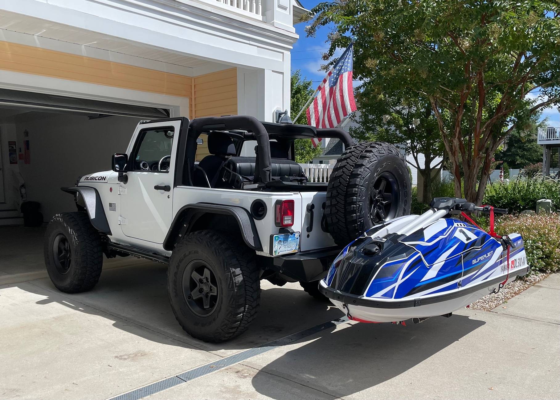

Can't help you with bikes hanging off the rear, but here's a Super Jet and carrier hanging off a 2 door JK. Weight is about 425 + 30. I use the same setup on my JL. I typically only go from my house to the ramp at the end of my street.
