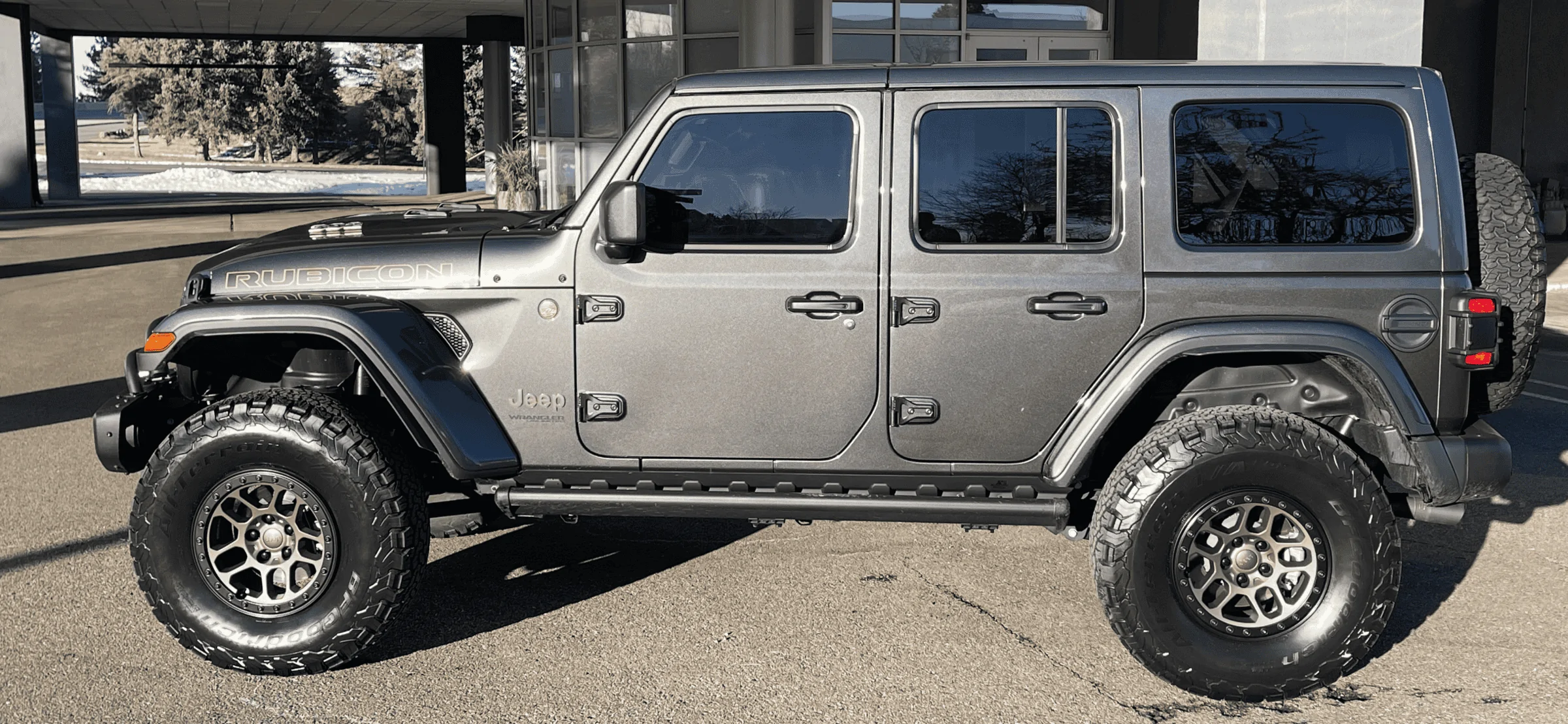

I had planned to add the rock krawler 1.5 boost as well to offset the 1/2” loss from my winch and winch plate while adding some room for 37s. Unfortunately, when I received the rock krawler 1.5 boost it contains a 2” spacer for the front and a 3/4” spacer for the rear. I only had a 1” rake even with the winch and didn’t want my 392XRs nose up in the air, so I returned the rock krawler 1.5 boost and bought the TeraFlex 1.5” spacer kit which is 2” front and 1.5” rear. The TeraFlex spacers were the perfect solution for my needs.
Glad you got it sorted the way you want. Looks great btw.

Maybe that is true. I didn’t like the RK design for that reason as well. I do like that the TeraFlex are stackable if I need an additional 1/2” in the front or rear after I add all of my planned mods. I agree - no carolina squat!
Did you get p/n 1165200 from teraflex? I may return rk and do the same as you. Thanks
Yes, those are the ones. I got the ST1 (1165000) which also includes bump stops to prevent rubbing with the 37s

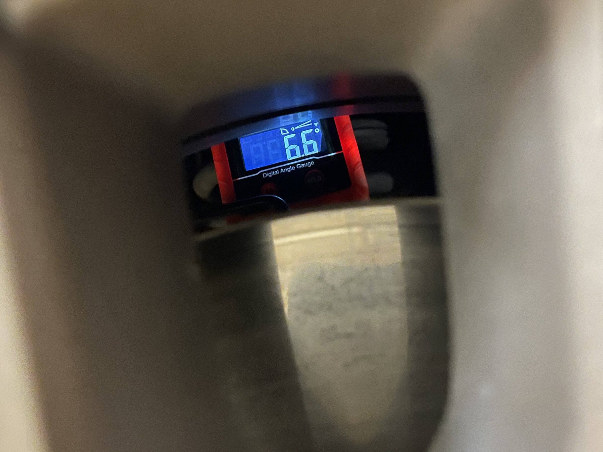

Sorry don’t know. I drove my Jeep back to CA from TX. It was wondering all over the lane. Went to local dealer and got the LCA and swap it the second day I got home. The longer lca definitely helps.
Mine is the same, I seen a stock print out and was seeing caster at 4.8 on another 392.
