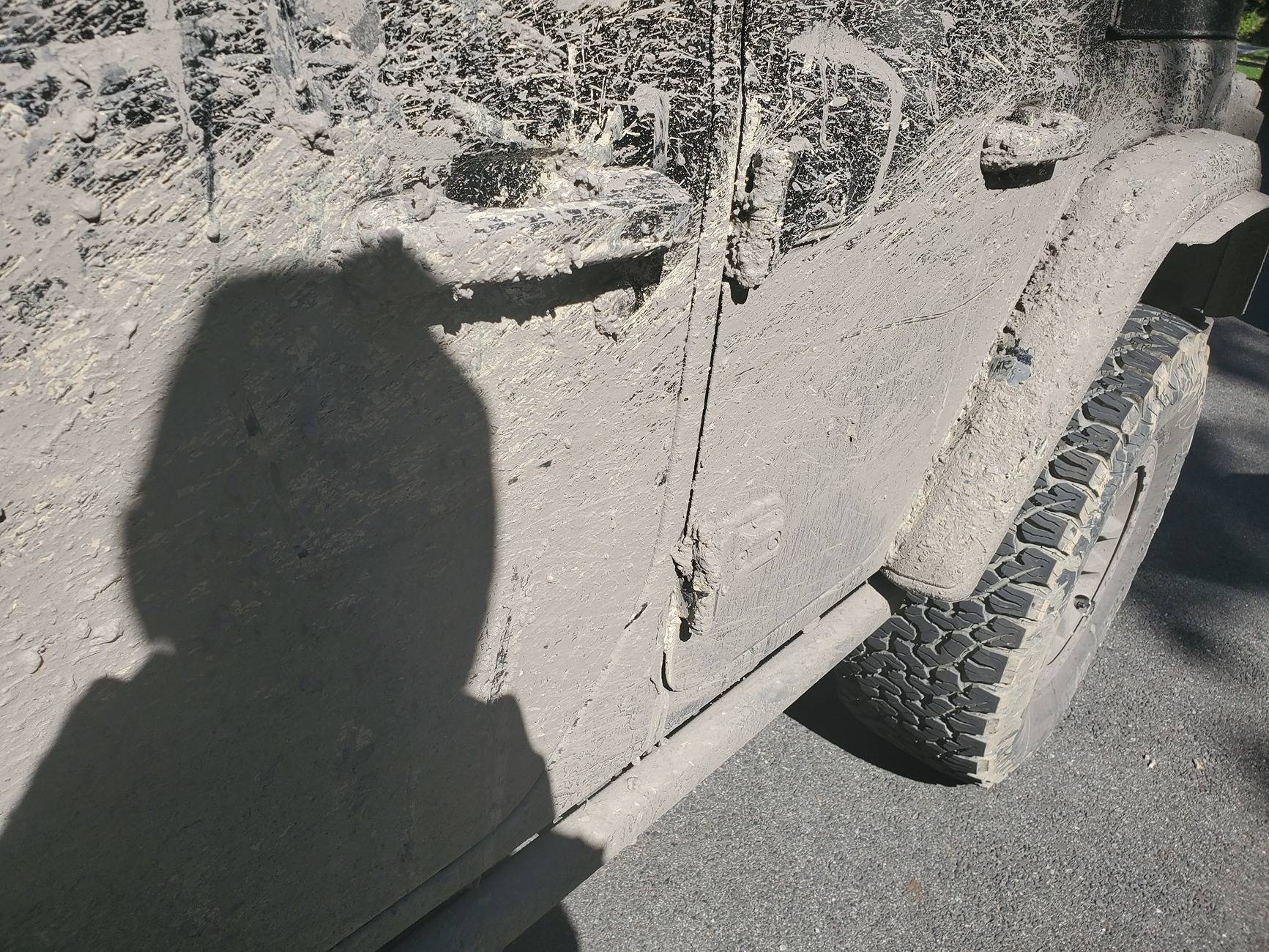

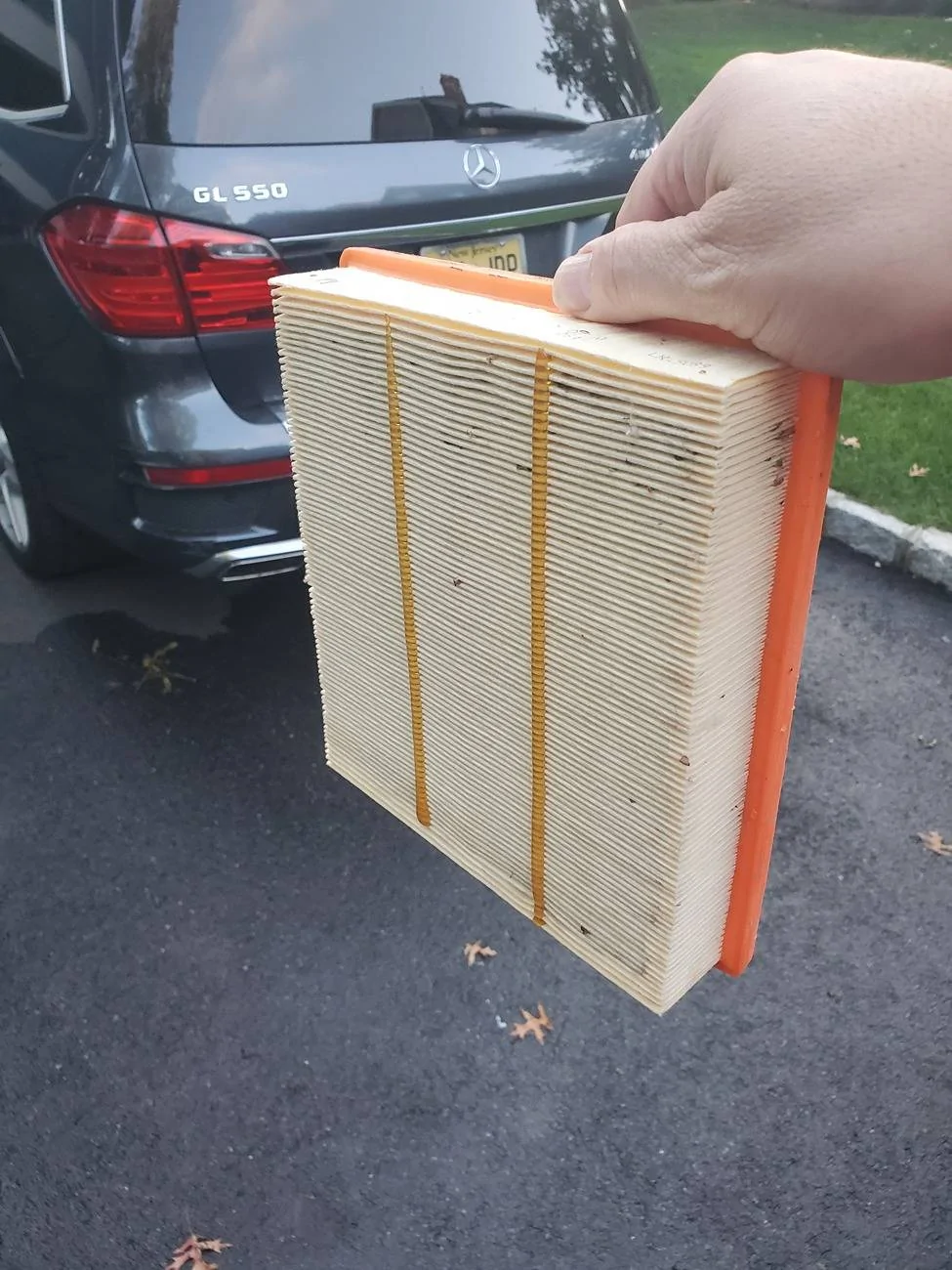

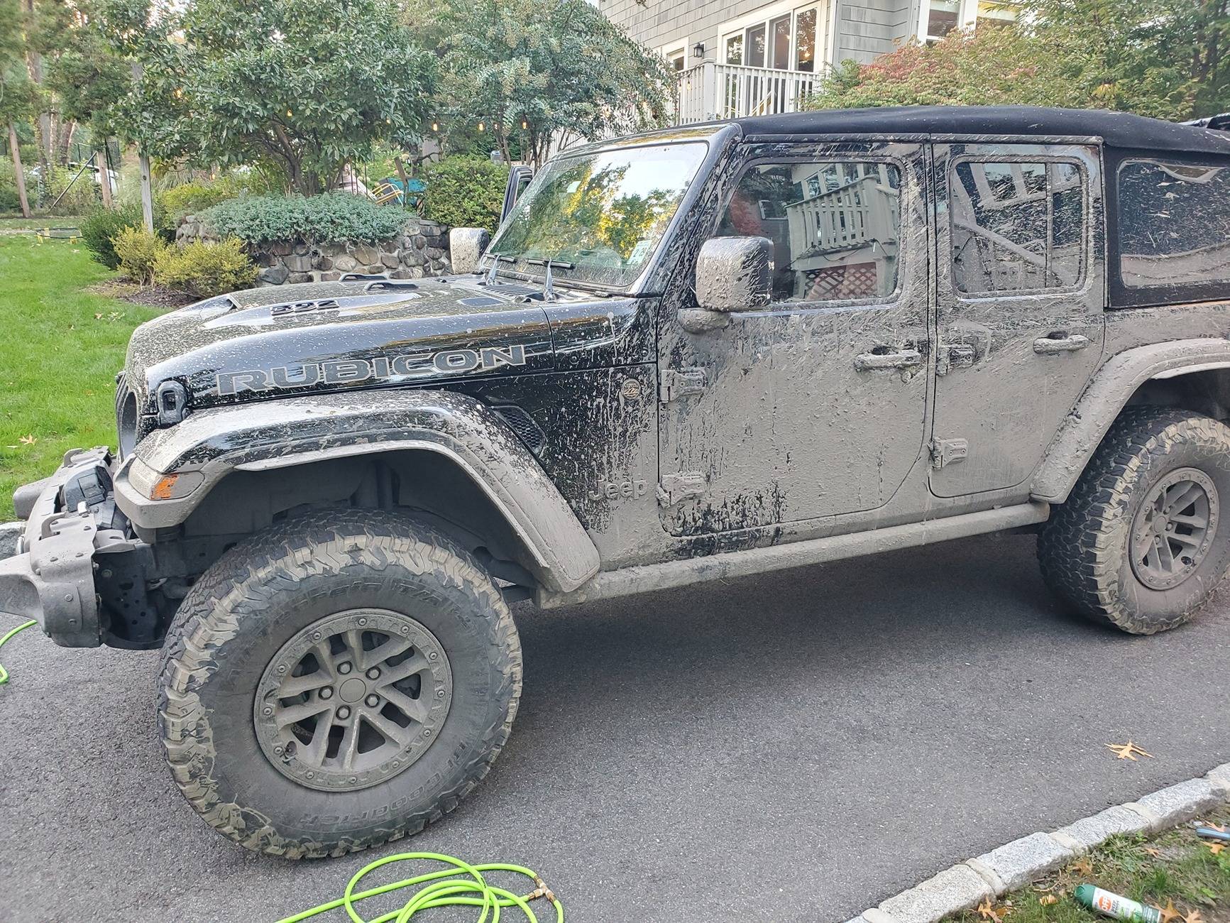

Not terrified but thinking "well crap this sux" as soon as the front end dropped to the headlights and I started loosing forward mom23rdentum, so I opened up the hemi and powered out.
I was wheeling with another 392 who was ready with a winch and I had bunch of recovery gear to hopefully make a successful extraction.
But it did suck that the Jeep was 4 months old at the time with 2800 on the clock.
It did clean up nicely though after a ton of elbow grease and bribing my 2 daughters to help lol
All better!
