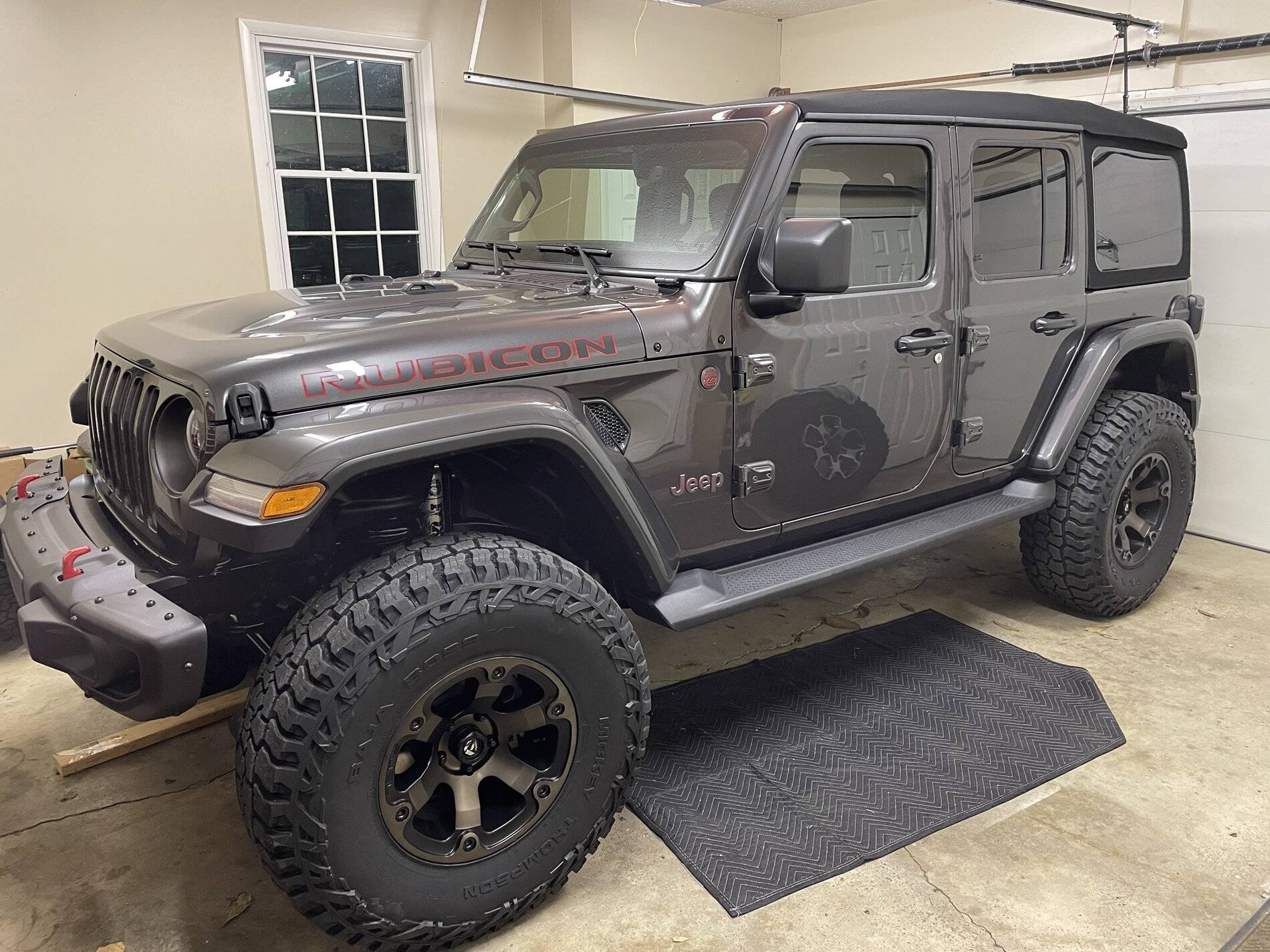

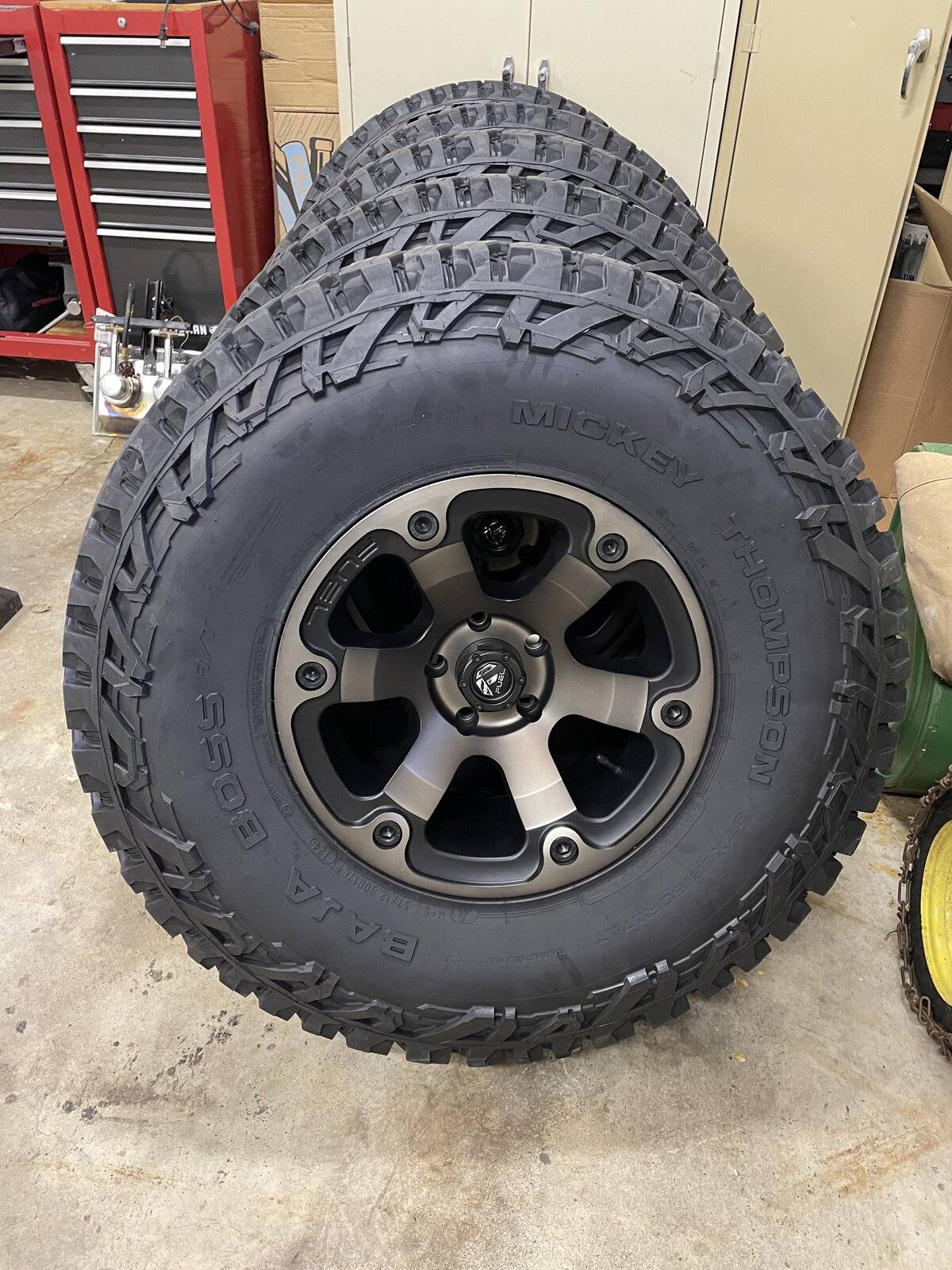

I purchased 37 inch Mickey Thompson Baja boss tires. 37X 12.5 X 17 on fuel rims. Tire shop balance them and said four of the five tires was over 14 ounces of weights. So I opted to go with balancing beads. I’ll mount them this week hopefully it works.

Ok, I drove back from Gupton’s today with mopar 2” lift and factory Rubicon wheels and tires with zero problems. 6 hour drive between 70-80 mph. I got home and mounted my 37” Baja boss A/t pictured in the first post. I get the death wobble around 38mph. If I get on it and hit 50 it does ok. It’s only if I slowly get to 35+. What now? I’m calling Nicky Thompson Monday to see that they say about these tires calling for 14+ounces.
