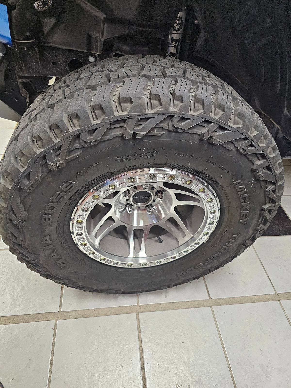

I'm running the 315-70-17 Load Range E Mickeys and I don't find them harsh at all. I think that my Fox Shocks help make the street ride possible and better than the factory shocks.
I'm running my Mickeys on Method 106 Beadlocks and on the street at 37 psi and 15 psi off-road.

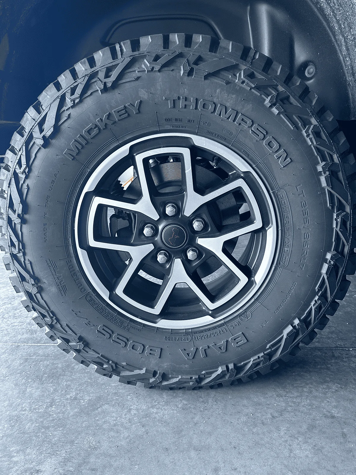

My 35x12.5 MTBB ATs ride nice and smooth becuase i don't fill them to the placard pressure. 27/25 F/R is what i run.
are these 35x12.5R17LT's if so do they have the extreme side biters?
