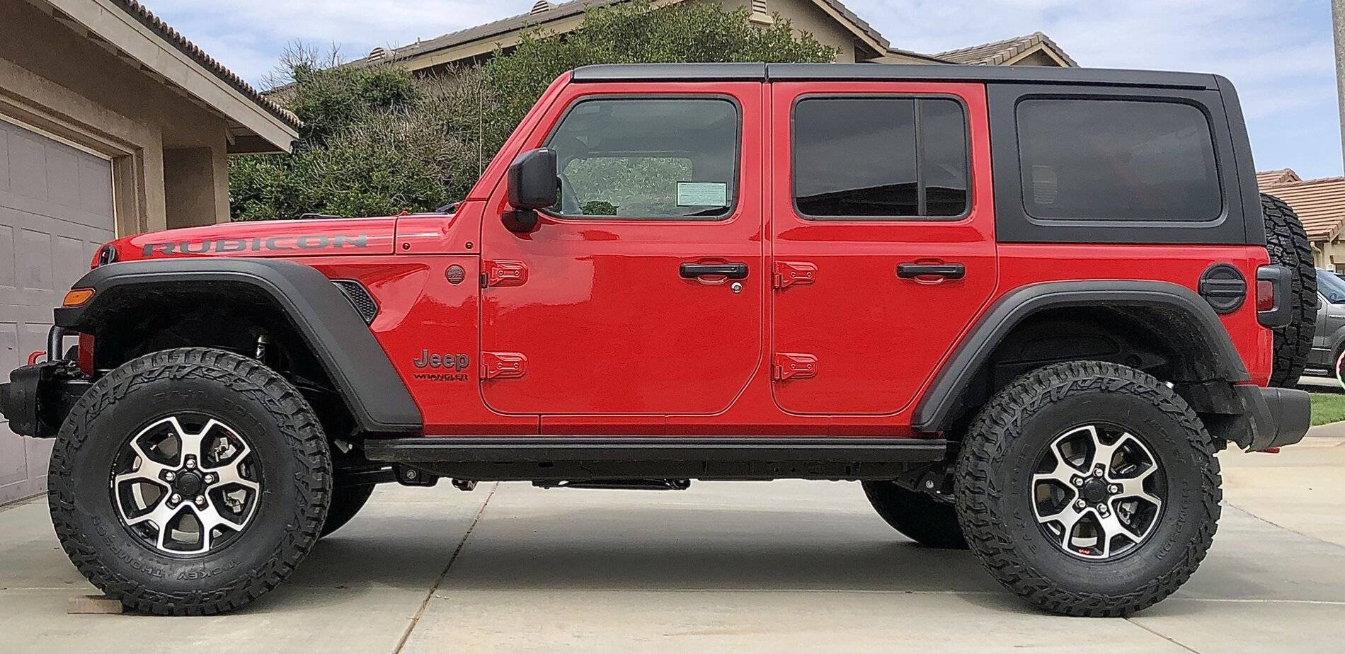

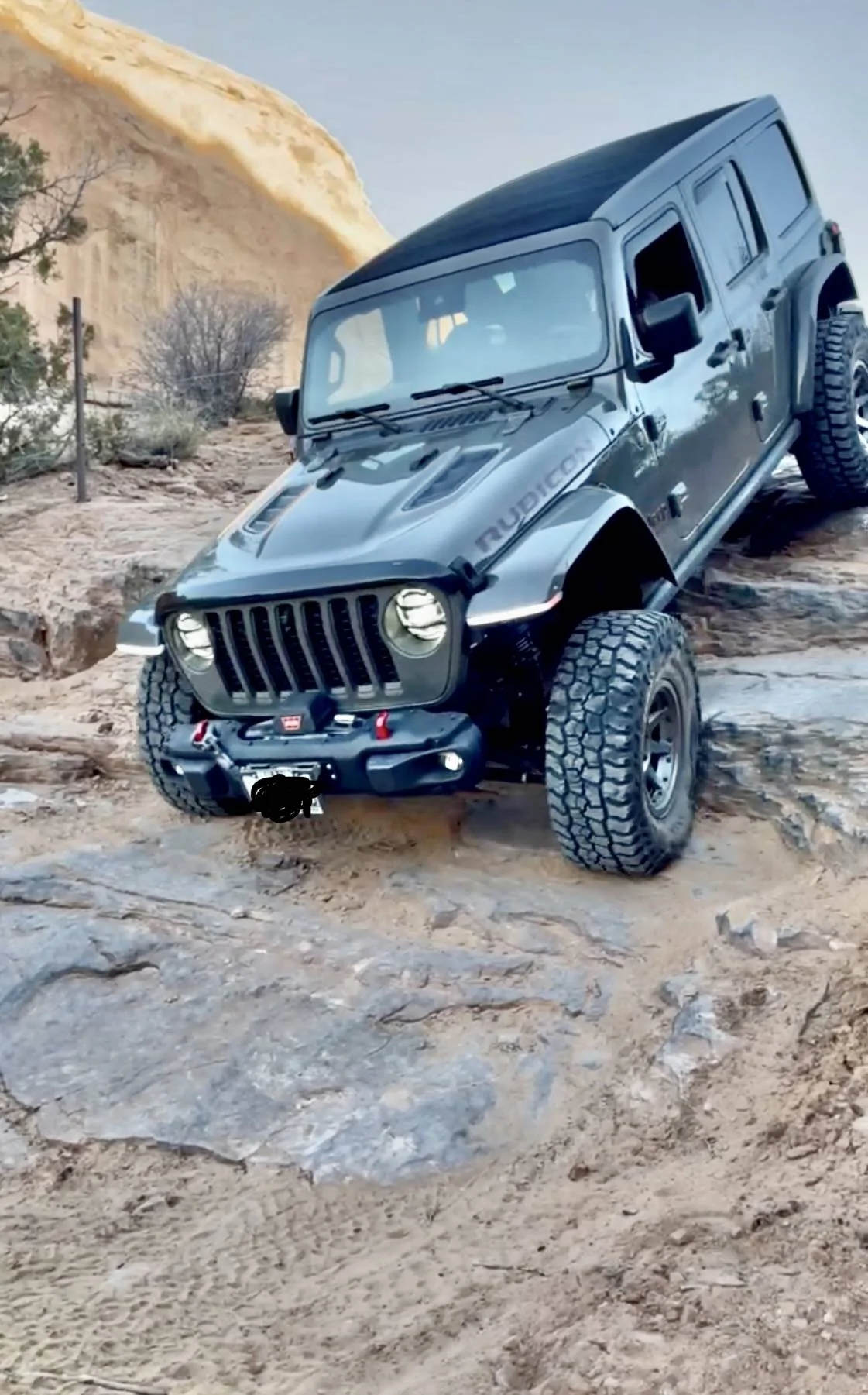

I have been running the Baja Boss AT in 35 “D” load range for several months now. Compared to both 33” and 35” KO2s they are superior in every aspect except noise level. Theare slightly louder.
Unless you live in or near heavy thick mud and off road in it often there in no need to look any further then the AT Boss. It is marketed as an AT but in reality it a hybrid AT/MT and slightly bias toward the MT side of things.
Size wise ~1/4” in overall listed diameter between brands is meaningless. It is the measurement under load height on the vehicle that matters. Build construction of the side wall will cause the tires to flex differently from brand to brand and overall the difference under the axles is at best within 1/16-1/8” at similar PSI setting. Also rim width will play its part in overall height difference. So just because a given brand lists taller numbers does not guarantee it will be taller. If you want a true 35” tire under vehicle load then you need to be looking at 37” tires.
Both the Boss AT and MT are heavier then most competitors BUT because of this they are hands down one of the toughest built tires you can buy in 35s. I have tried all the top name quality brand offerings over the last 30 years and can say in my experience MickeyThompson (Owned by Cooper) makes the best tires for true off roaders that need strong tires yet still provide for decent general all around day to day use. The new Boss AT goes well above this.
My 35” AT Boss tires on my JLUR with 2” lift.

Thanks for the feedback on the ATs! They look great!
Regarding weight.. according to the Mickey Thompson site, I think the 35 MTs are ~3lbs less than the ATs (72 vs 69 - and that's impressively light for a 35 mud terrain!)

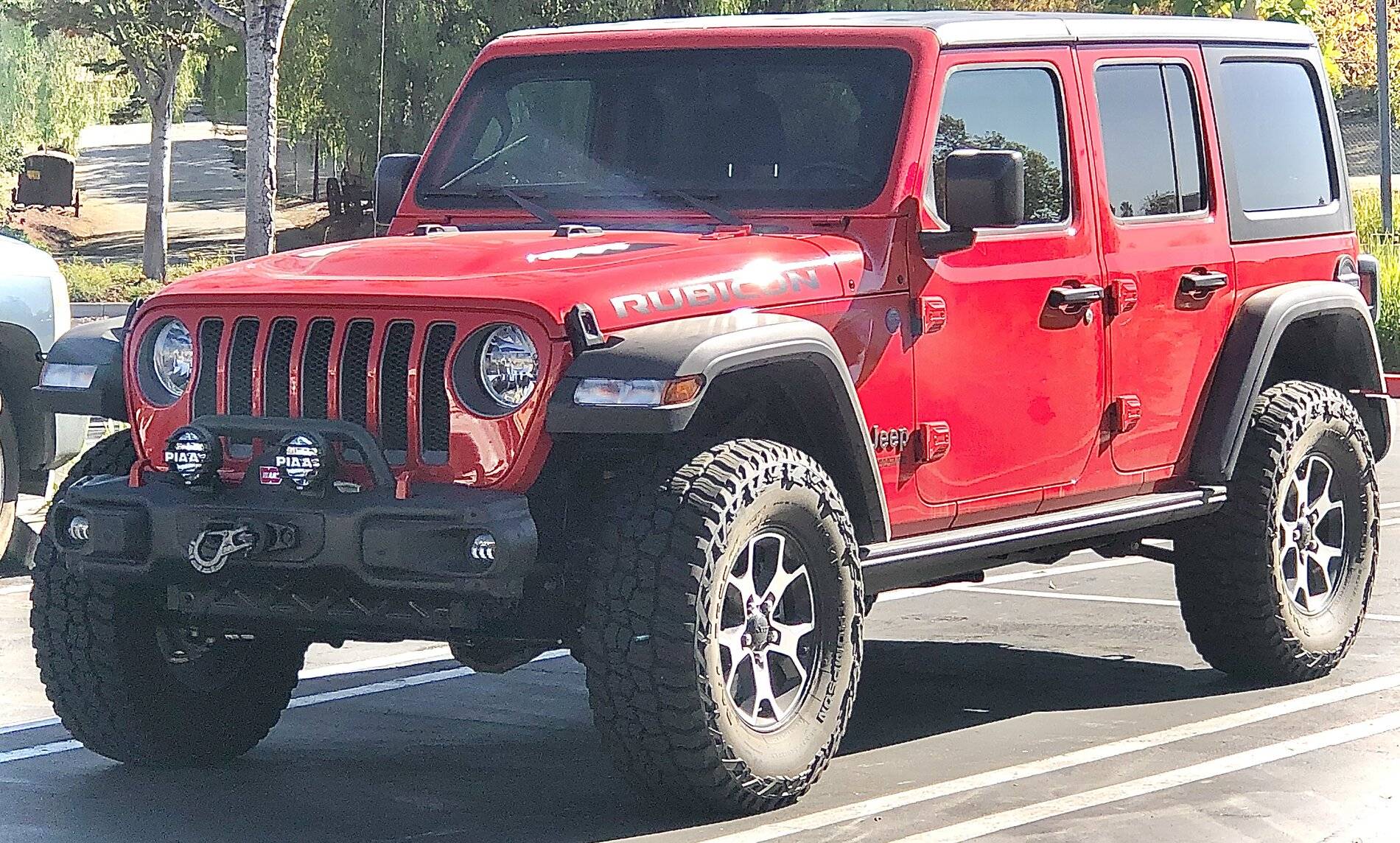

I have a 37/12.5/17 Mickey Thompson, Baja boss AT. According to the website, it is actually. 36.8” tire, and weighs 80 lbs. your information is wrong. Mickey Thompson is heavier, and the sidewall is harder. The compound is very hard. And a load range D. The Baja Boss A/T. Is the most aggressive A/T out. I have been on all types of terrain and it handles well. I great tire. Also, I called Nitto before I had purchased a tire, and they technician told me the Ridge Grappler and Recon Grappler are more of a truck tire. If you want that, that would be a step up from any stock Jeep tire, including KO2. That was good like 25 years ago. The Baja boss, as stated already is like an AT/MT hybrid. Almost an MT, but more sipes, and a 55,000 mile warranty. I will take that all day in a daily driver. If you want the MT the way to go now is Trail Grappler even over Toyo Open County MT now. I love my Baja Boss AT’s they did fine in Moab even.
