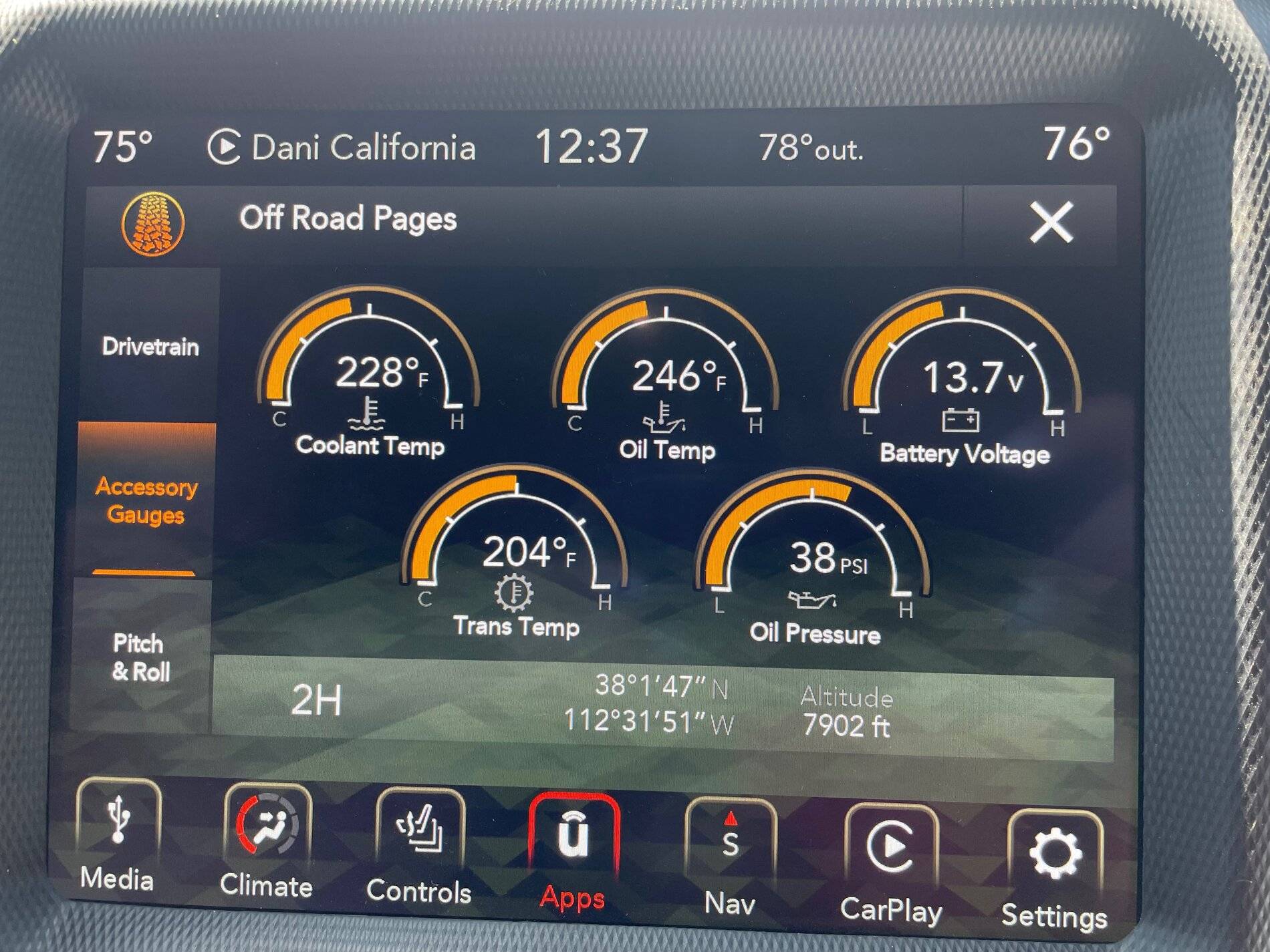

On my road trip to from Phoenix to Salt Lake City, I closely monitored the gauges shown on the off-road page of the UConnect screen. It was only on the 6-7% mountain grades where I saw oil temperatures reach what I saw as a maximum of 251 degrees (ambient was 97 degrees). This was NOT towing, but maintaining speeds of 70 mph. I only saw these maximum temperatures for a short duration, probably less than 2 or 3 minutes and only near the crest of the hills. Temperatures would drop to the 230s within a minute of cresting the hill. If I dropped my speed by 5 mph, the temperatures didn't seem to build as high. I'm sure engine temperatures will go higher if it were under a towing load, but I think if you were to keep the speeds down to a reasonable 65 mph and maybe try to avoid the hills on really hot days (impossible for Arizona summers) you'd be OK, provided you keep an eye on the temperatures.
I started taking photos of the UConnect screen on the return trip and ambient temperatures were lower and I was driving a bit slower, but here are two hill crests . . . notice altitude and ambient temperatures.
My trip to Salt Lake City was specifically to look at an trailer I hope to acquire within the year. I'm now investigating the feasibility of adding an auxiliary oil cooler to the engine.

Those numbers are more of a real world scenario for my 3.0 Read a few posts, guys are towing a trailer and claiming numbers much lower, I'm not sure how they're achieving that but it might be the ambient temperature. Most of my Highway is similar climate, Desert California Heat. The Honey Cone insert on the front grill has small openings on my 2020. All the 2021 3.0s I've seen so far, are the same as Gladiator they all have larger holes. Would like to remove my grill inserts
and see if I get a difference in the gage temperatures. Don't think it will make I noticeable difference but I'm willing to try. When I tip over the 250 on the oil temp is when I start to get concerned. Seeing the water temps at 230+ at times, is also concerning. After all water boils at 212.
Yes. However we have a mix with coolant/antifreeze, plus water. The boiling point is raised 10 to 15 degrees and with the cooling system operating under pressure the boiling point is even higher.
286 degrees is the boiling point with a 21psi radiator cap.
Temps in the 230 degree range is normal for a modern engine.
