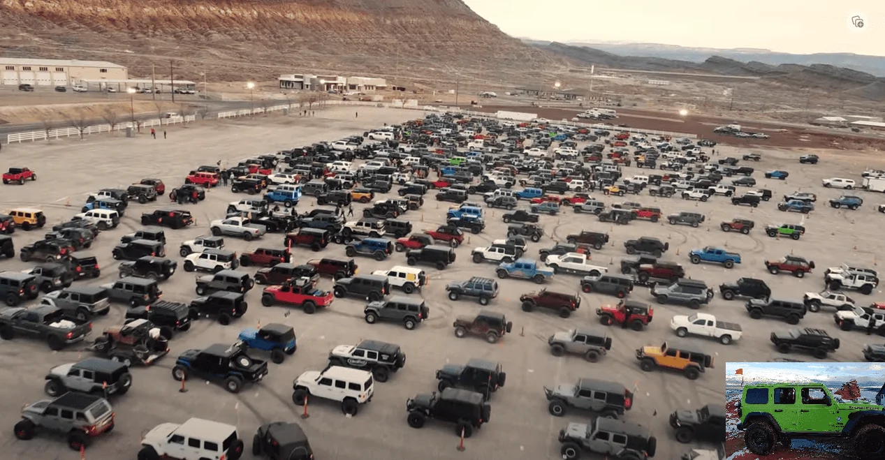

I'll try BG 245 and see if it makes a difference, then post any results here.
BTW, it looks like we spent some time together in the same general area last month. I didn't notice your Jeep, but maybe you saw mine. It tends to scream: "hey, look at me!"

Yep! I did Wayne's World and Fault Line at Sand Hollow. Had a great experience at the Winter Jamboree. I only saw one other diesel there out of the hundreds of Jeeps. But did have a few negative comments regarding the diesel from old timers.
I hope the BG245 works and look forward to hearing what's up with your mileage.
