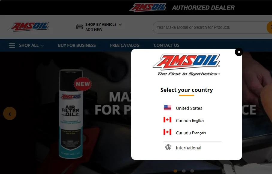

Ahhh yes totally unbiased site with amsoil plastered everywhere
Meh…. I just post information. If you’re so bent on trying to rebuke everything why bother? I was just trying to post objective information. If folks want to try or not try, it’s up to them. A third party testing site of your choosing would make a difference? Probably not. I’m sure the auto parts stores love your business. If you don’t like the stuff no one cares.
You post sales literature. Not information.
