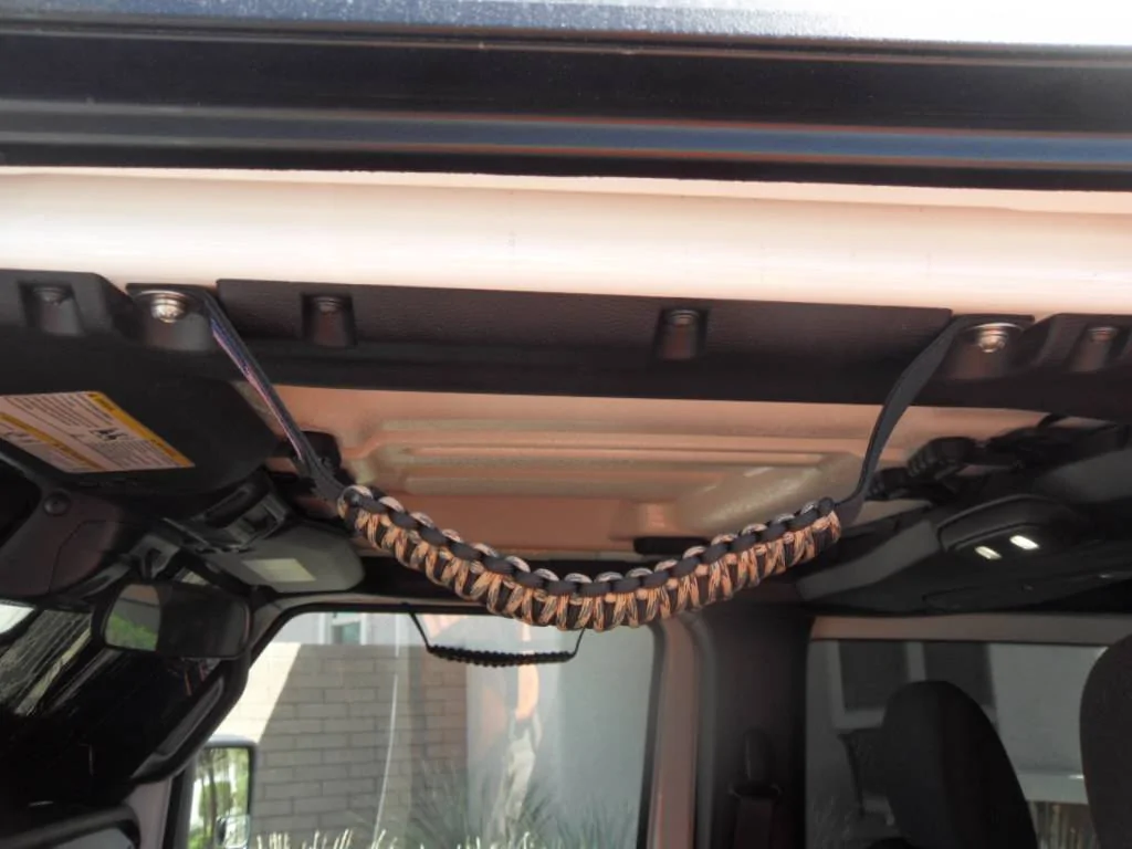

2024 Wrangler with "Willys" package....I contacted Mopar parts through this forum and asked if they had an ETA for the factory Grab handles, but they have not received any date from their supplier.
Most of the "ebay" style grab handles ( paracord warp around style) cover up the air bag built into the roll bar on the '24 Wrangler.
I found an Ebay supplier (ritrongroup123) that supplied dimensions in one of his pictures...his Grab Handles for a 2012/2022 FORD Bronco ( yes , I know - a sacrilege!) looked like they would fit between the holes in the roll bar without wrapping it around the bar....so I purchased a set in "Camo color" for $14.00.
I had to install Rivnuts ( 8mm) into the roll bar holes ( Amazon has a neat kit with rivnuts and install tool for $50 ( supplier's name is Wetols) - there are just holes in the roll bar from the factory.
I used a Stainless steel button head cap screw, lock washer and a 1" OD fender washer for a 5/16" bolt and some blue loctite to complete the assembly.
It hangs down a little too far most folks, but I'm short and the '24 Willy's is on the tall side for me so the length works well.
I have contacted the Ebay supplier and told him to make the handle about 2" shorter and use a Tan/Black Camo color to compliment the Jeeps interior...we'll see if he contacts me with a "free" sample!
Hope this helps.
Jeep Wrangler JL 2024 Grab Handles SDC10092

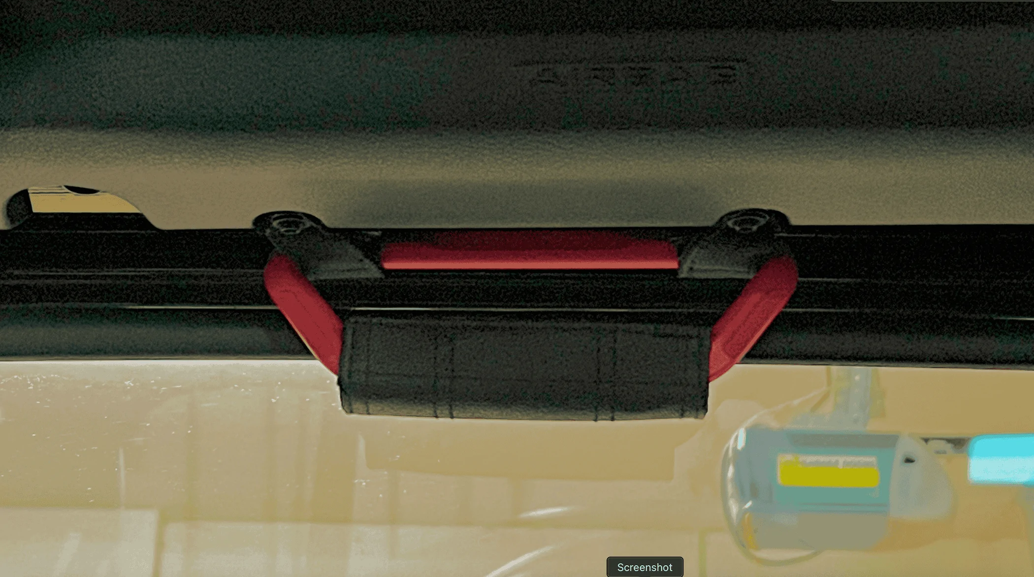

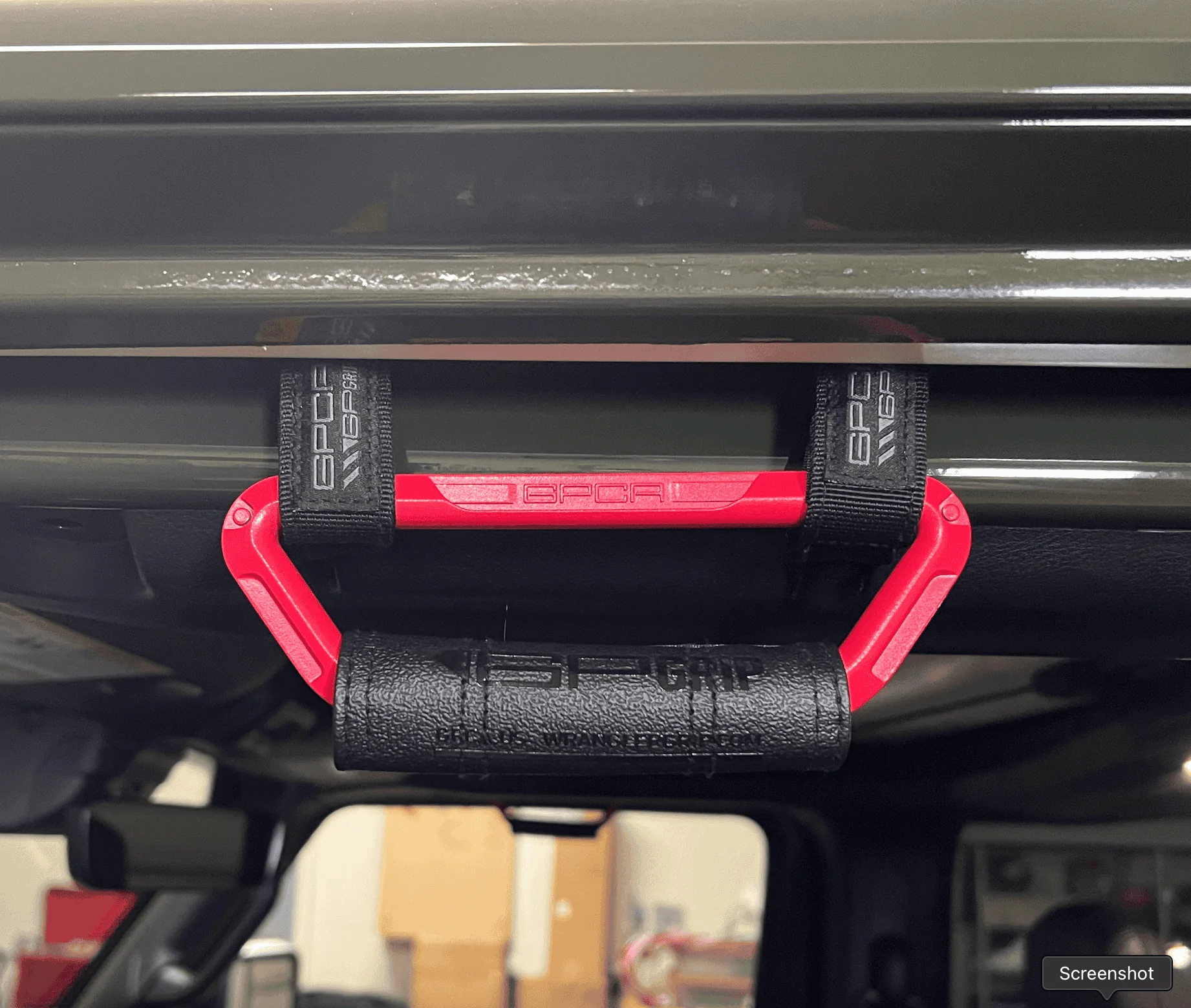

For those with freedom panels the GPCA grips are an easy install in the front. Just pop the freedom panels off and use the provided screws. The grips are very sturdy as they attach at both the bottom and top of the frame.
The side where the airbag comes out is unobstructed.
The handles do not touch the metal frame because the straps prevent metal on metal contact.
The handles do not bump into the window or make any noise either.
PS
I have a 2-door, so I can't comment on the rear door install.
Jeep Wrangler JL 2024 Grab Handles Screenshot 2024-04-13 at 12.49.15 PM
Jeep Wrangler JL 2024 Grab Handles Screenshot 2024-04-13 at 12.49.39 PM
