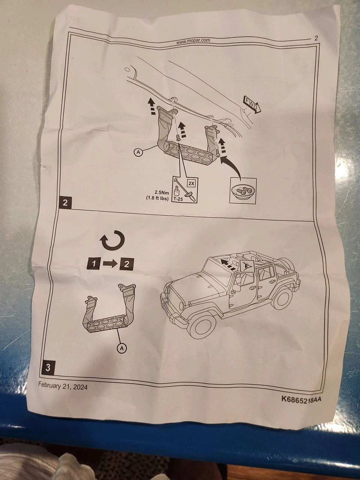

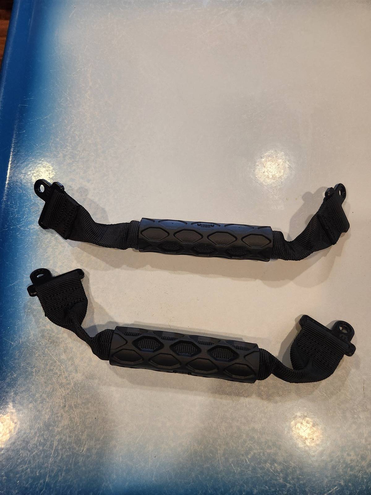

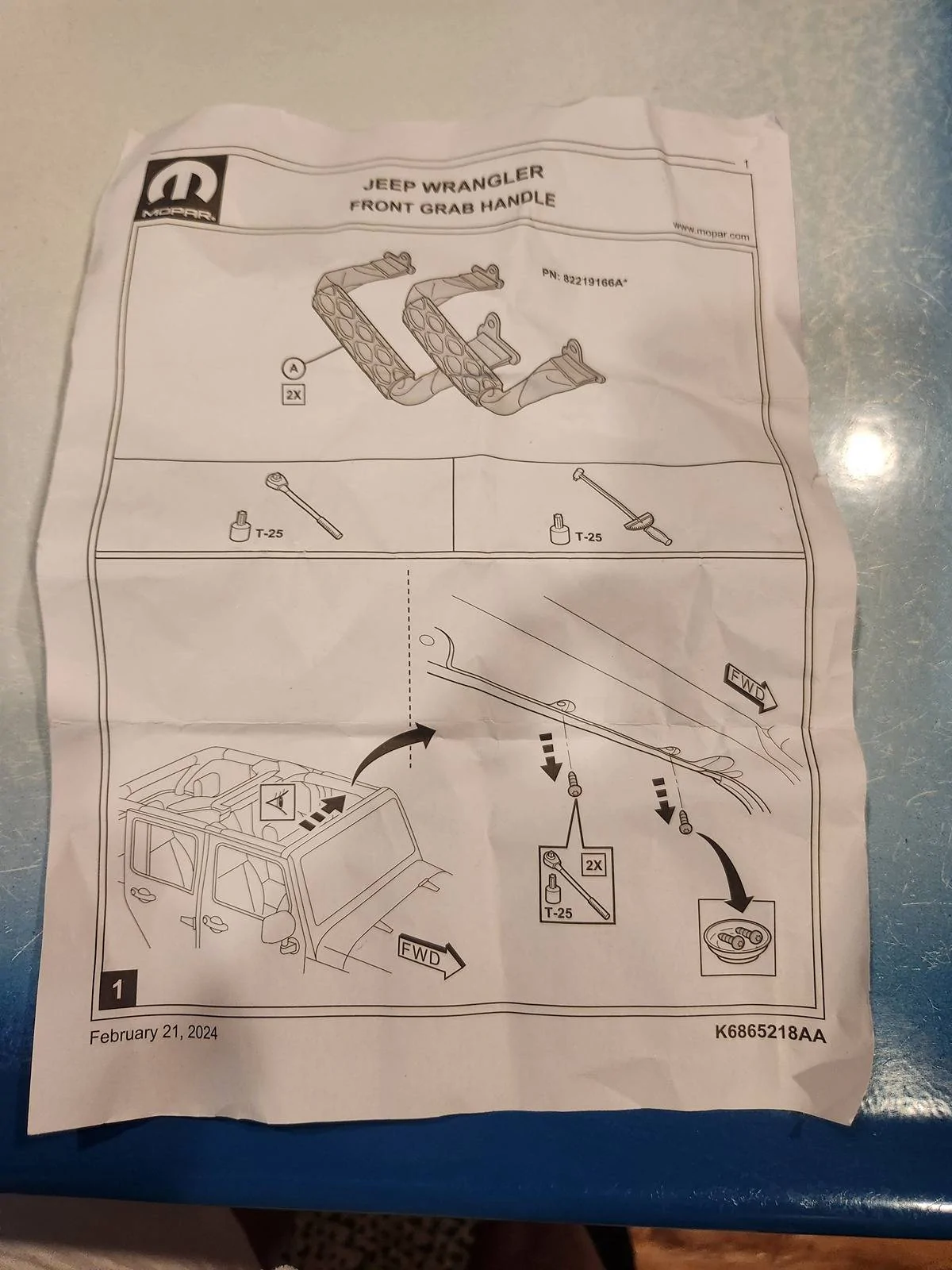

Going on tomorrow ill post photo of them on here now with directions

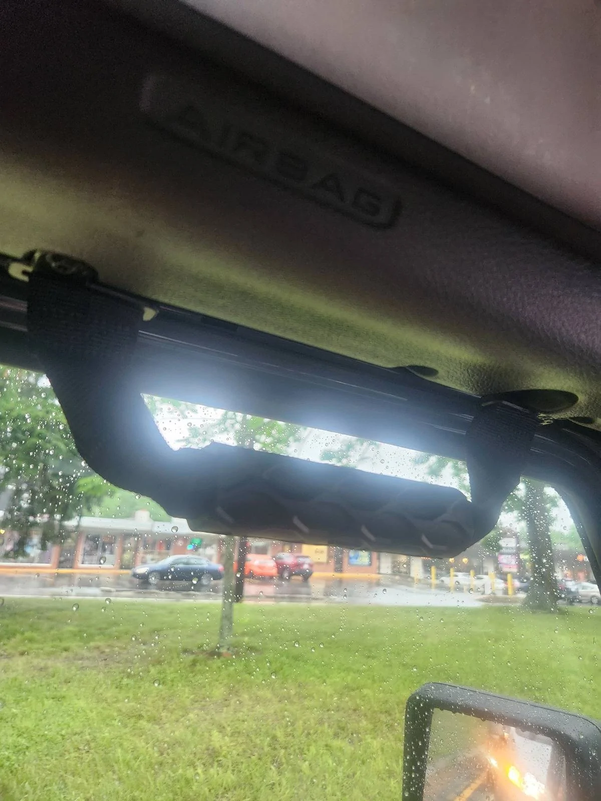

Look like old style without clamp not sure if i think longer screw comes out 1st above air bag​
I wouldn't think that little trim screw would hold that much weight on it. The older ones wrapping around created a stronger hold since they were pulling shear on the screw and not directly on the threads. At least that is how my mind sees it.

No new screws in box so we use what's already up there

So they dont hang too low u can put one screw out further instead of way directions tell u

Did you notice that the dealer installed on SOT bolts as opposed to the screws in The instructions?
