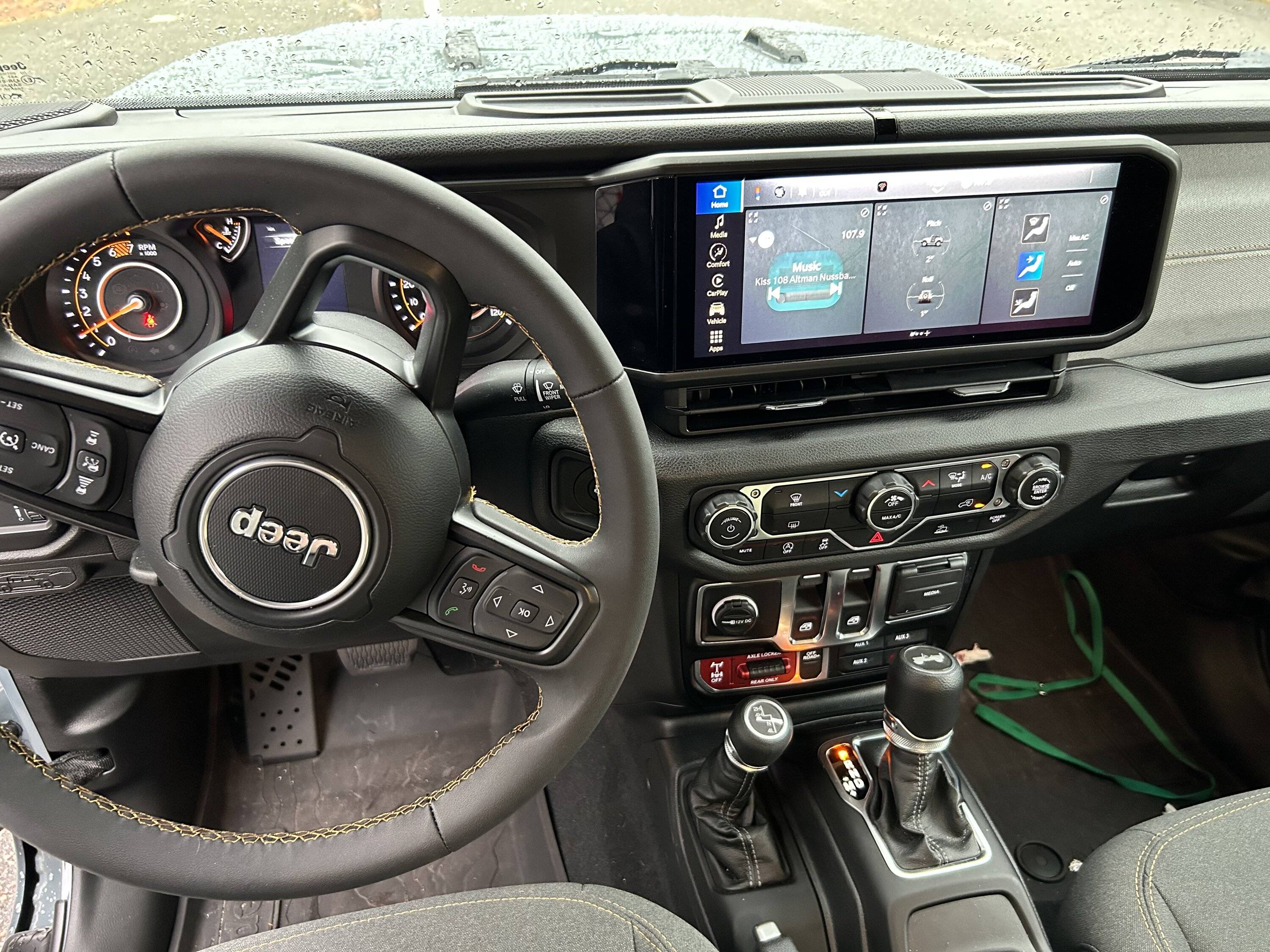

Anyone know of a dead pedal that can be installed on a 2024?
I removed my MORE pedal from my 21 Willys and to my surprise there are no holes for installation on the 24

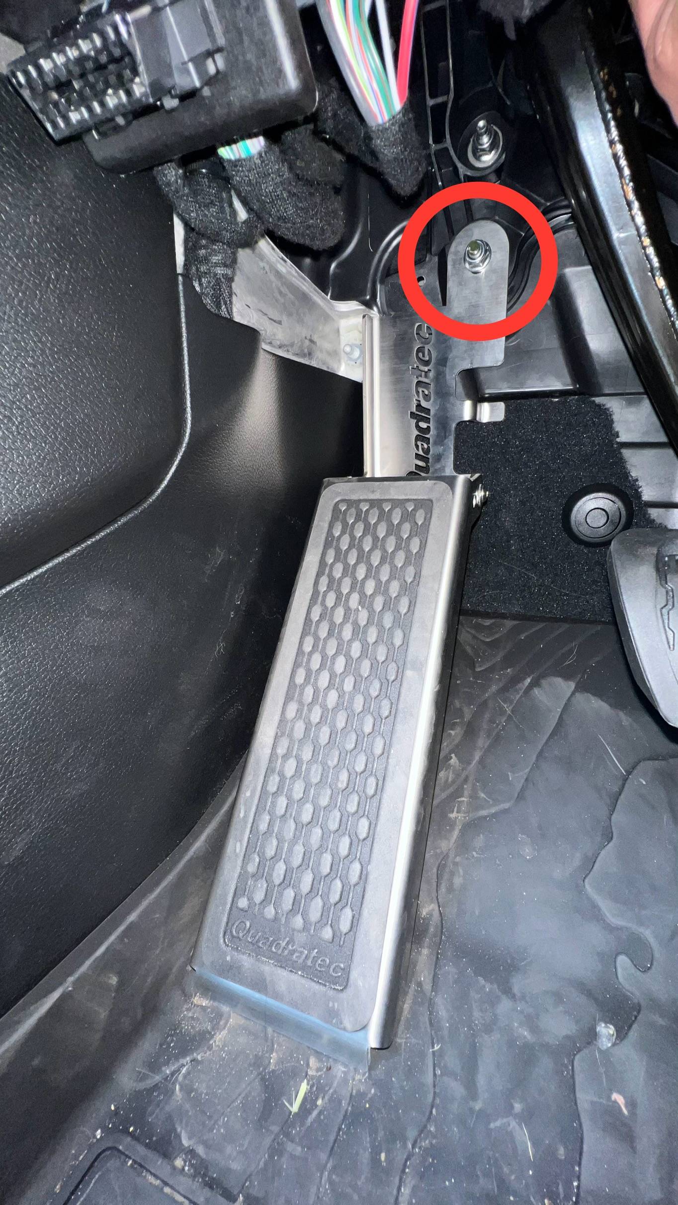

Hey, Jose, did you ever get this resolved? I'm trying to figure this out myself. Even if we find one, one of my fears is to have it installed only to find that it's too short to be of any use.
If you have any insight, I sure would appreciate it.

Yeah! As long as the pedal bolts on to this body color screw, you should be good. My old MORE pedal would bolt on to some holes on the piece of metal on the left, but seems those were removed on the 24s.

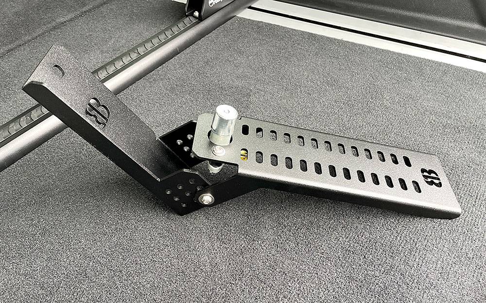

I'm going to do it. I'm going to try to pick one up from @813 Fabrication & Design (if I can get their site to ship to Toronto <grrr>). If not, then I will grab the Quadratec like you did.
By the way, how are you liking it? Did it make a big difference? Does it slip and slide? Did you use bolt tightener like LocTite or anything?

Oh yes! I ship Worldwide! International orders are a custom process so that we can pinpoint shipping costs, which is why the website says to contact us for ordering. Sorry if you were having some issues!

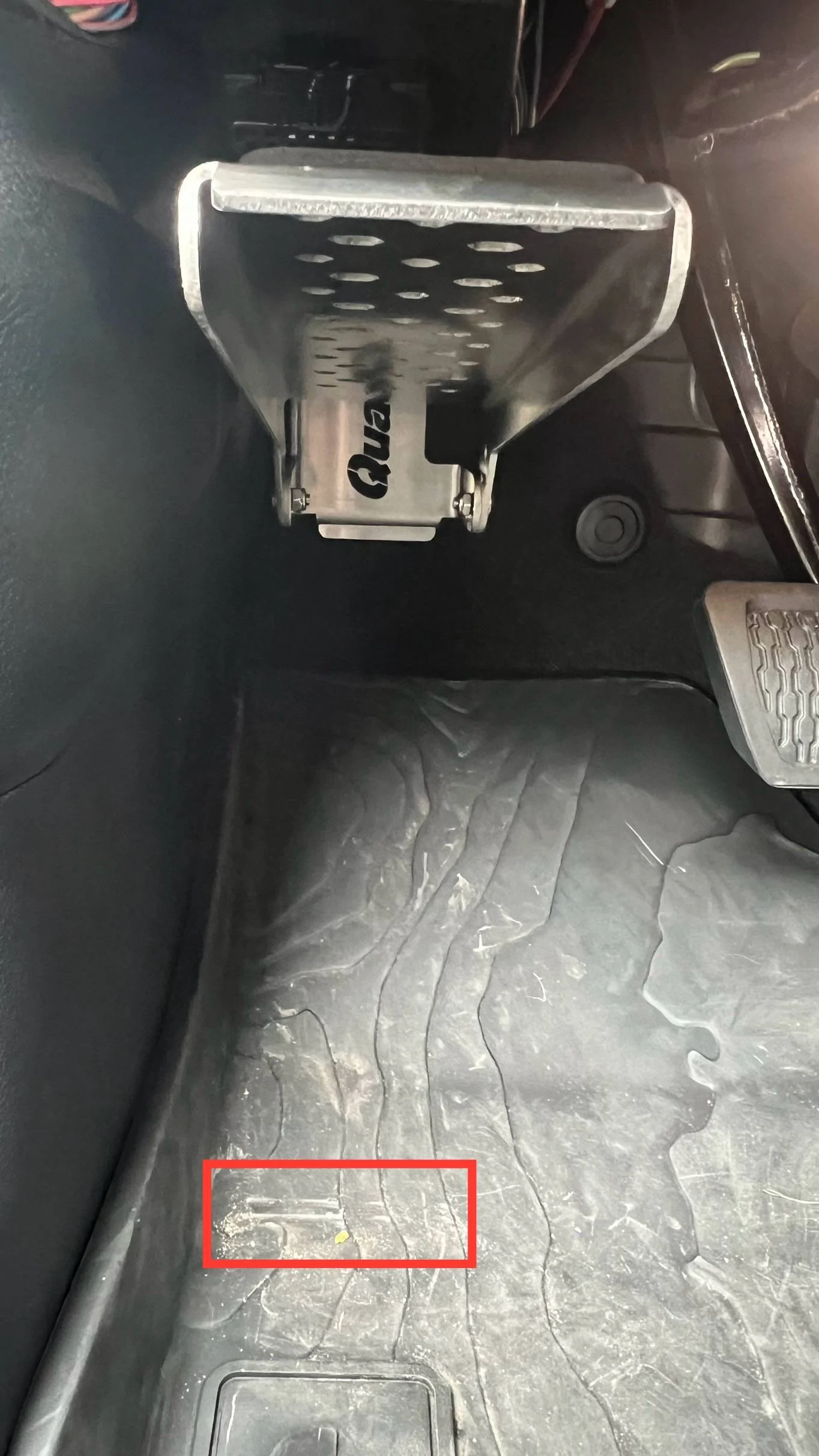

Thanks, Jose!
Its super sturdy, and heavy. No loctite added, just tighten as much as I could. The pedal can be lifted if you dont want to use it. I will say maybe due to the weight or material of this pedal it is marking up my floor mats. Might be an issue on the long run, but will be adding some sort of foam padding to the bottom to prevent further wear and tear. Other than that its really comfortable to drive with.
