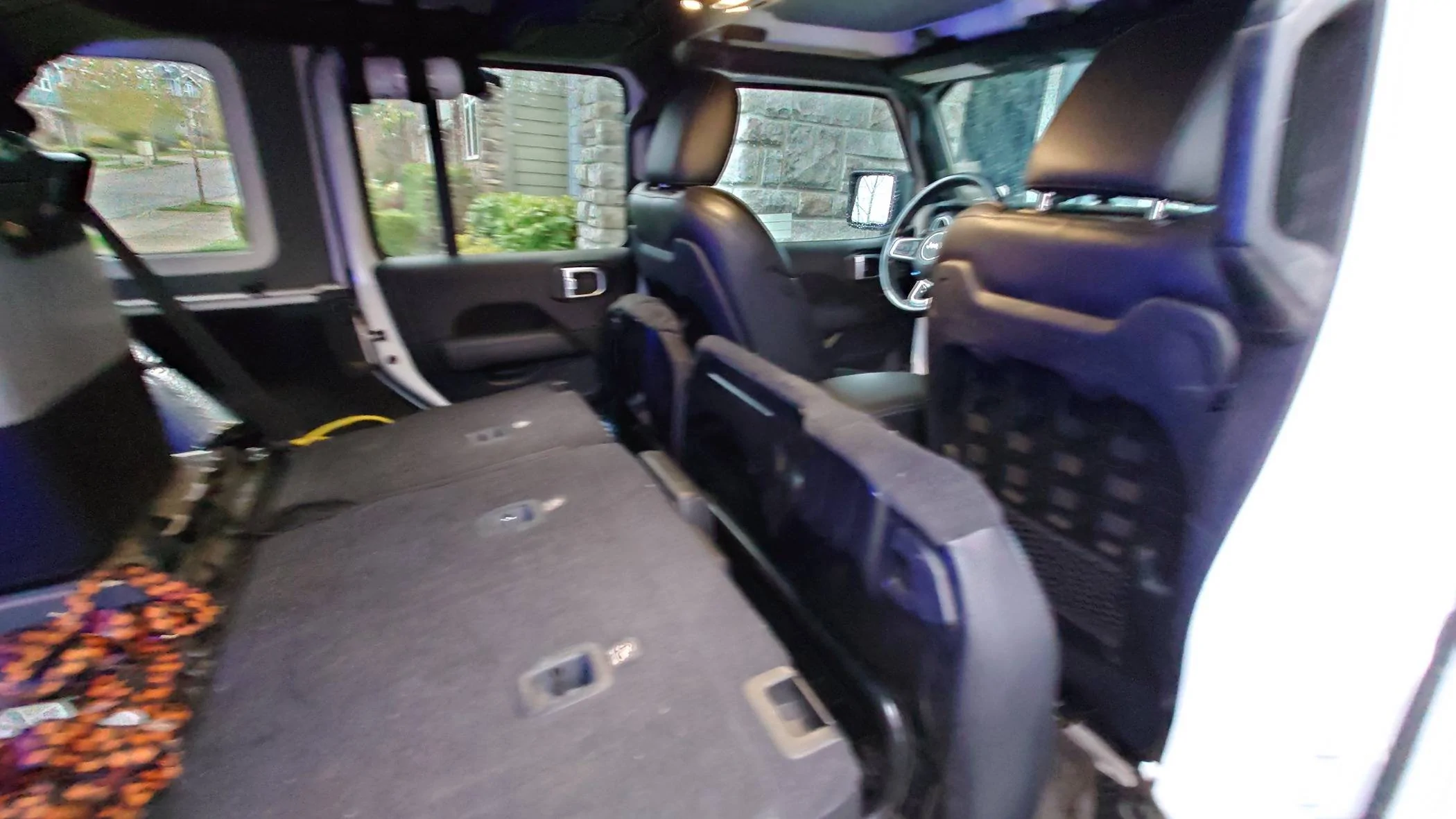

The rear seat's bottom cushion tilts forward against the back of the front seats. You basically end up with two steps from the cargo area to the front seats.
If the items you want to carry are relatively small and long, like 2x6 planks, you'll have no problem fitting them.
This image shows the front seat back slid forward & tilted forward as far as it will go. I measured about 72.5" a long a line from the tailgate table, across my platform, over the rear seat bottom cushion, to the front passenger seat back.

Thanks so much! So it does look like the entirety of the distance at least above the folded seats is the same depth as the other JLUs. That gives me some hope!
