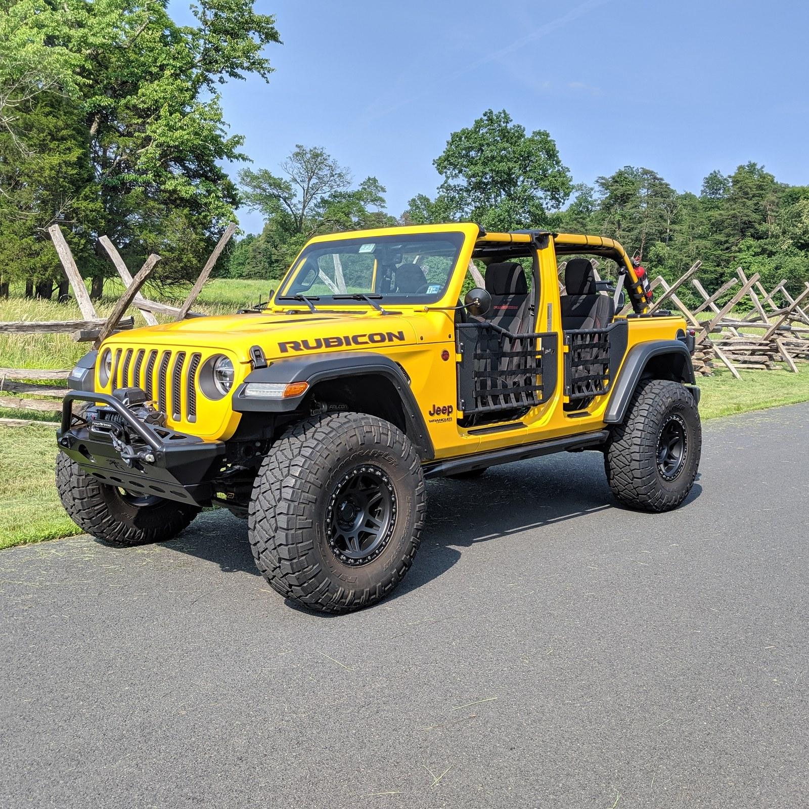

Won second place in the JL class in the NovaJeepers Show and Shine. Also installed the EAG tube doors. I'm really impressed with them, especially for the price.

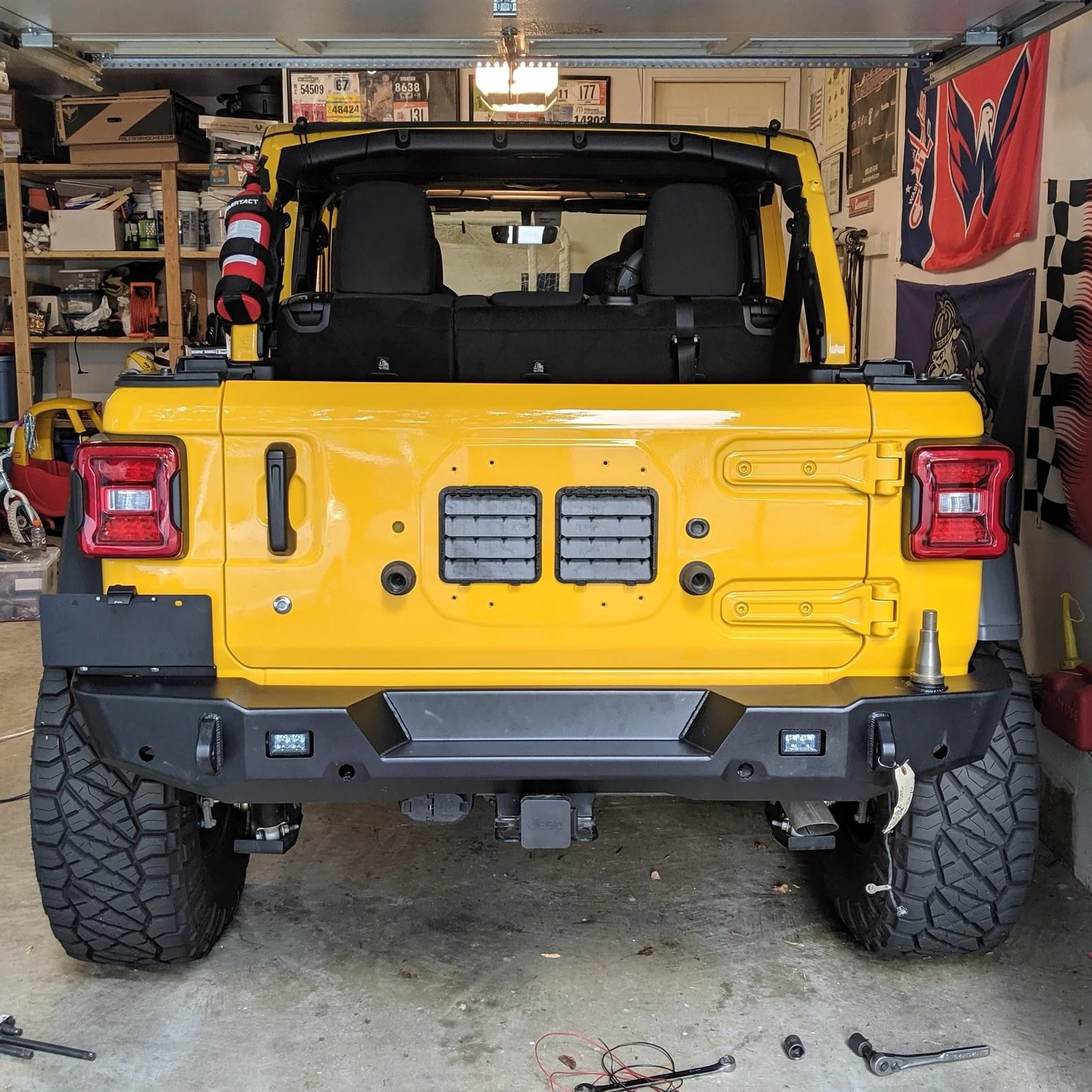

Battled the heat and started the install on my Expedition One Core Series 2 rear bumper/carrier today. Finished installing the bumper and the wiring for the backup LEDs. I have to say that the quality, design and finish is amazing. Looks really good.
Unfortunately, didn't realize that the backup sensor brackets on a plastic rear bumper don't come out like the steel ones. So I couldn't install the backup sensors. Thankfully, I found a thread with the part numbers and made an order with Quadratec. Half of the parts won't arrive until mid July :( Installing the two middle sensors is going to be a PITA. I ideally don't want to remove the bumper/carrier to install the sensors/brackets, hoping I can remove the tow hitch and it'll free up the space needed. And crossing my fingers that there aren't any false positive sensor issues.

FYI it is possible to remove the sensors from the plastic bumper. We did that with ours but we had to epoxy them onto the new bumper since they're not the same design as the steel bumper ones. Just some food for thought.
If you also don't mind, can you post the link for the OEM sensors? If we ever replace our bumper I'll need to order new ones since they're epoxied onto the current bumper lol

Here is what my installer used
6MH84RXFAB
Bezel, RIGHT
$2.42
6MH85RXFAB
Bezel, LEFT
$2.42
6MH82RXFAB
Bezel, RIGHT
$2.42
6MH83RXFAB
Bezel, LEFT
$2.42
68295601AB
Bracket, LEFT
$1.61
68295600AB
Bracket, RIGHT
$1.61
68295602AB
Bracket, RIGHT
$1.61
68295603AB
Bracket, LEFT
SHYUperman
SHYUperman
Jun 18, 2018
67
564
380
VA
2024 392
6MH84RXFAB
Bezel, RIGHT
$2.42
6MH85RXFAB
Bezel, LEFT
$2.42
6MH82RXFAB
Bezel, RIGHT
$2.42
6MH83RXFAB
Bezel, LEFT
$2.42
68295601AB
Bracket, LEFT
$1.61
68295600AB
Bracket, RIGHT
$1.61
68295602AB
Bracket, RIGHT
$1.61
68295603AB
Bracket, LEFT
When I called the local dealerships, looks like the following part numbers changed:
6MH85RXFAB Bezel, LEFT - 6MH85RXFAC
68295603AB Bracket, LEFT - 68295603AC

Thanks, I saw that and debated about doing it, but decided to buy the brackets.
