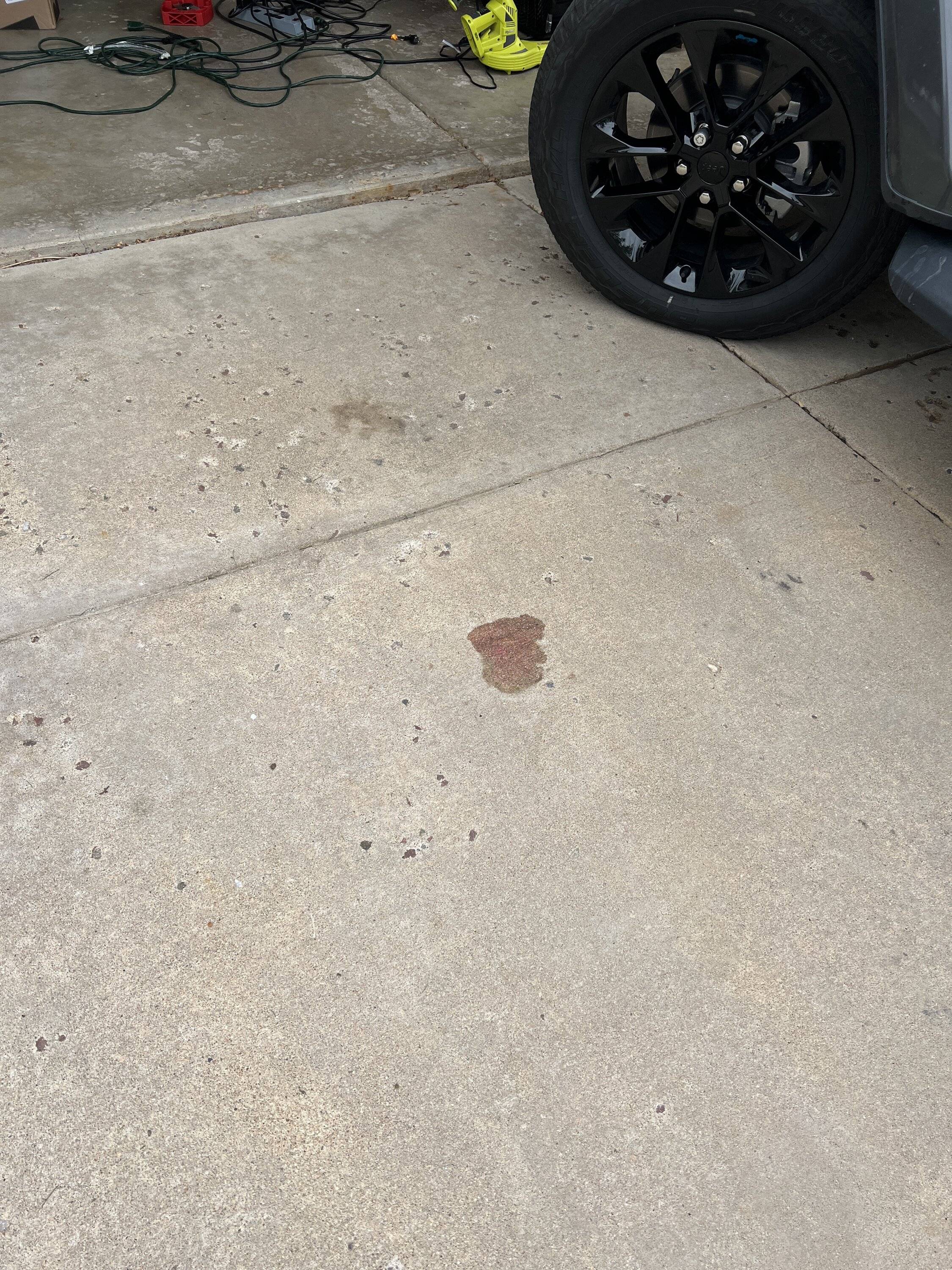

I noticed a small puddle of coolant in the driveway yesterday, opened up the hood and noticed that one of the coolant bottles was practically empty. So I called the dealer to try to get the car in, with them stating it's two weeks before they can diagnose it. Understandable, even if a little frustrating, because they can't control staffing shortages, etc. They then told me that they don't have any loaners and can't cover more than $60/day for a rental (basically half the actual cost). This is where they started to lose me with their logic. I called Jeep Wave and got much of the same response, though the gentleman tried a little harder maybe than the dealership to get additional approval for more rental car charges. The end result was the same though.

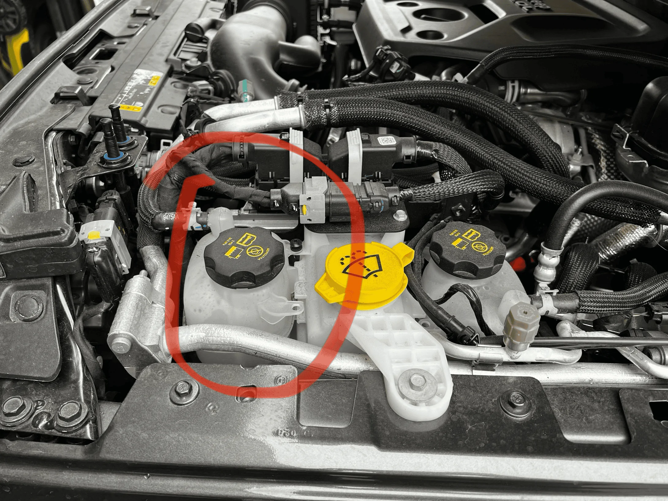

See photos of the coolant leak attached, as well as the bottle that's empty. Assuming I can snug up those bolts and thats where the leak is coming from, I'd just need to top off the bottom circled, correct?
Be back in a few once I see what I can see. Thanks again for all your help!

so actually the main coolant reservoir is the black one in the back of the bay. that from one is a second one (for battery or turbo or something i forget) if its bone dry, there is a chance you could have air in the system and not just be able to top of the reservoir but actually bleed the system. at least thats the way other cars i've had worked. thats not a ton on the driveway luckily

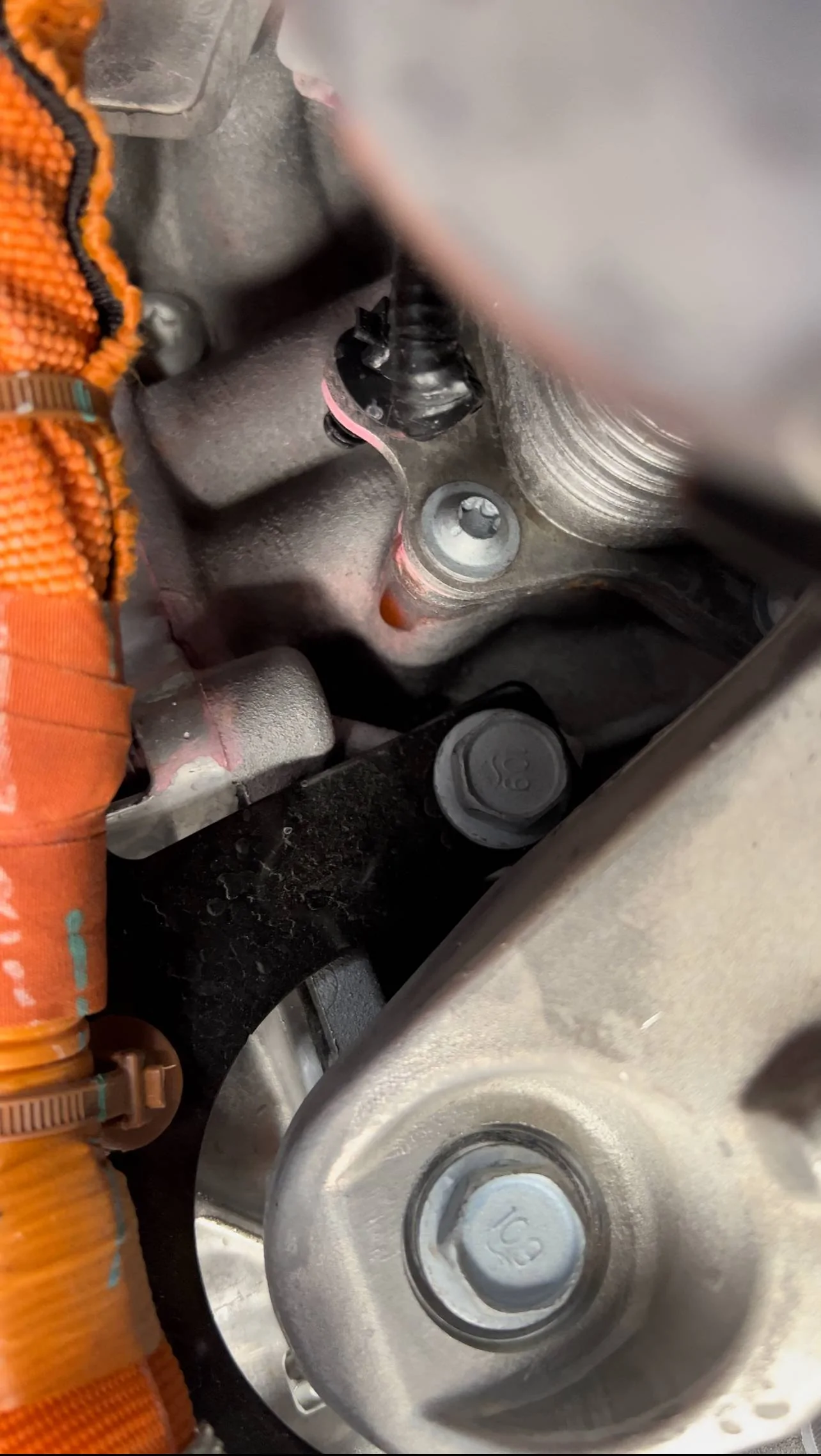

I think this is one of the two bolts in question, and does appear to be some fresh leakage from that spot. I think I can get to that one to snug it up, so will just have to find the other potentially.
Any idea on how to bleed the system to make sure I get any air out?
Again - truly appreciate your help!

yes thats one...so that one i got to right from where you look up at it...the other is opposite it kind of on the top. i couldnt get that one from the same spot. i found it easy to snake my arm through the drag link/trackbar area from the front and get to it just barely. hard to explain you kind of have to feel it out.
Im not sure how this specific system is set up, but on my audi I need either a vacuum bleeder (easiest) or you can do it by gravity which is a major pain because you loose a lot of coolant. radiators have a bleeding screw that you open and you keep filling up the reservoir while flushing the system and letting the bubbles come out...i wouldnt recommend doing it yourself unless youve done it.

Get the top bolt from the top of the engine bay and a stubby ratchet/torx bit, reaching through the mess of lines. Recommend pulling bolt and putting blue loctite on it and snugging down. Bottom one is best got from underside.

Thanks for the tip!! I got to the bottom one from underneath and it honestly felt really freaking snug. I couldn't budge it. Still couldn't get to the top one, but was trying from underneath for that one too. Will see if I can try to get at it from the top again.

It tears up your arm pretty good, definitely not an easy one to get, but worth it. If it's loose, do put loctite on it before replacing.

You are chasing after a solution to a different problem. The coolant elbow with the potential for loose bolts is the engine coolant system. That’s the black reservoir by the firewall.
The white reservoir in the photo is the intercooler circuit.
You’ll never fix a leak in one circuit by working on another.
