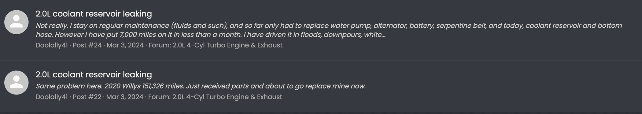

So do you have the 2.0 or the 3.6?
5 pages and gonna replace their engine on their own…this is another $18K lift thread. Patiently waiting till we get to page 15.
