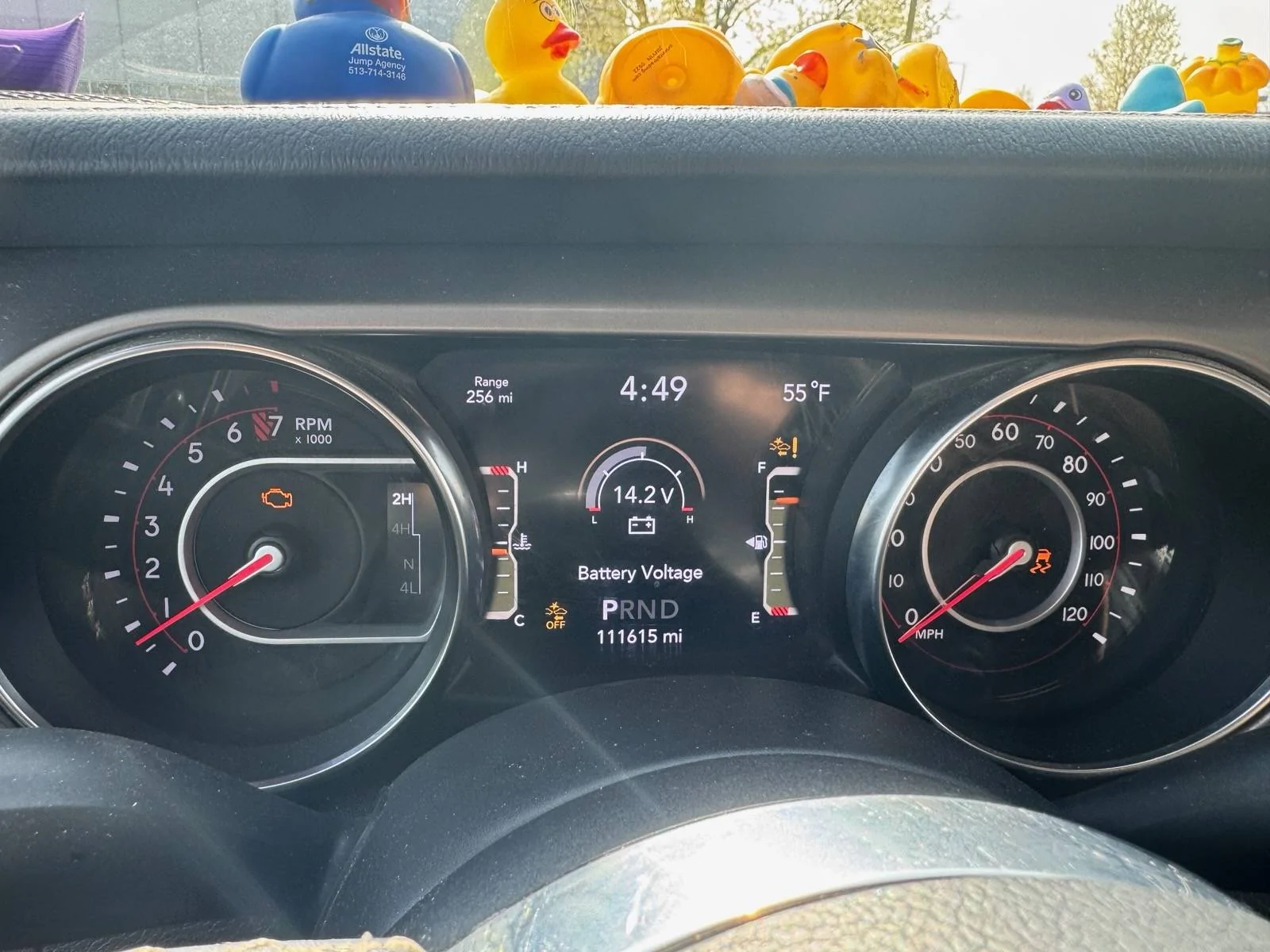

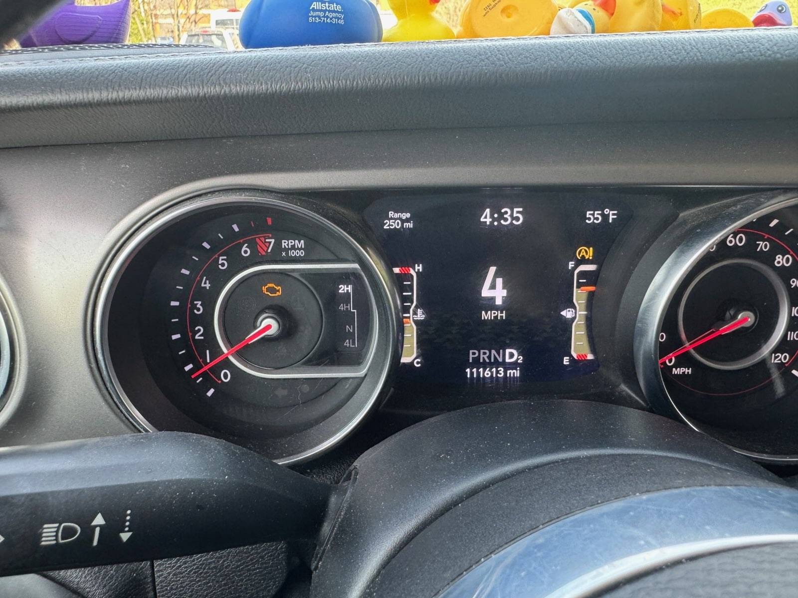

I’ve got a 2020 JLUR with the 3.6L engine, and I’m dealing with some weird warning lights. The check engine light is on, the yellow (A!) light came on briefly but went away, and now the collision detection light is staying on. I had AutoZone scan it, and the codes that came up were U0121 and U0121-00 for lost communication with the ABS module, C1252-92 pointing to a brake booster pump issue, and U0002-00 for a high-speed CAN Bus problem.
I already checked the brake fluid, and it’s fine. From what I’ve read, this could be an issue with the ABS module or wiring, something going wrong with the brake booster pump, or possibly a CAN Bus communication issue causing multiple systems to act up. I’ve also seen people mention that a weak battery can cause weird electrical problems like this, but I haven’t tested that yet.
Has anyone run into this before? I’d rather not start replacing parts blindly, so I’m hoping to narrow down the problem before tearing into wiring or electronics. Any advice would be appreciated!

It's your Jeep's way of telling you that it does not want to go out in public with all those ducks on the dash.
Phrank
Nov 22, 2023
652
2,308
NEPA
2018 JLUS
Once you get rid of the ducks, have your battery(ies) properly load tested. If it is (they are) the original batteries, it is (they are) due for replacement regardless of the load test results. If the battery(ies) are newer AND load test fine, the green canbus is the next most likely culprit.
