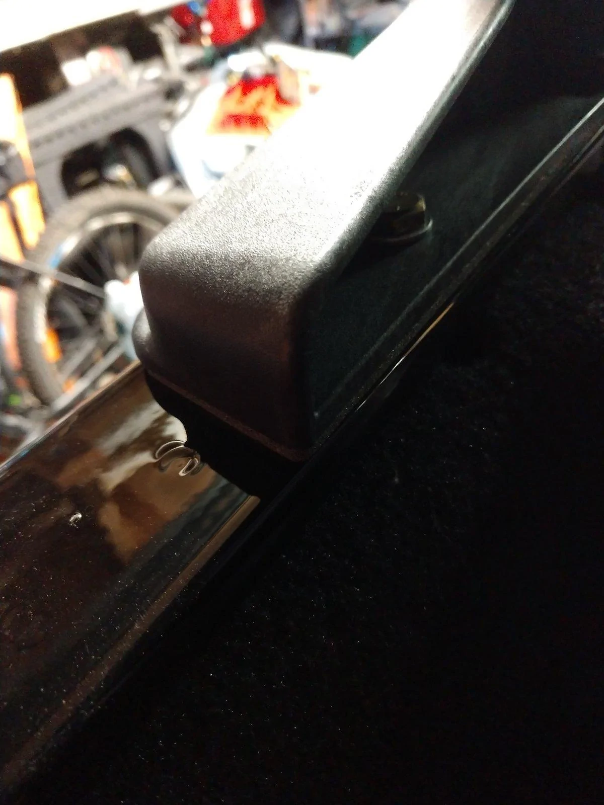

Shake here....
Rattle from here... notice slight gap where C pillars meet the body the plastic rattles against medal body.
Thats why some have put rubber Under or secured with a bolt to tighten and prevent movement.

Shake here....
Yes my brand new 2019 JLU Rubicon has that rattle behind the drivers seat. Its deff that pillar. So I have it on correctly ? the passenger doesn't do it that's why I'm asking. Thank you
