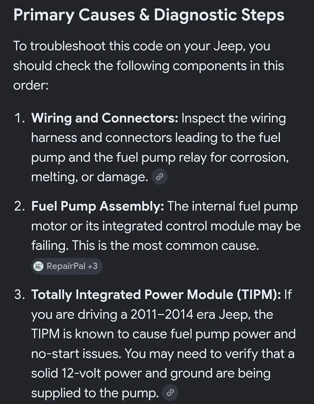

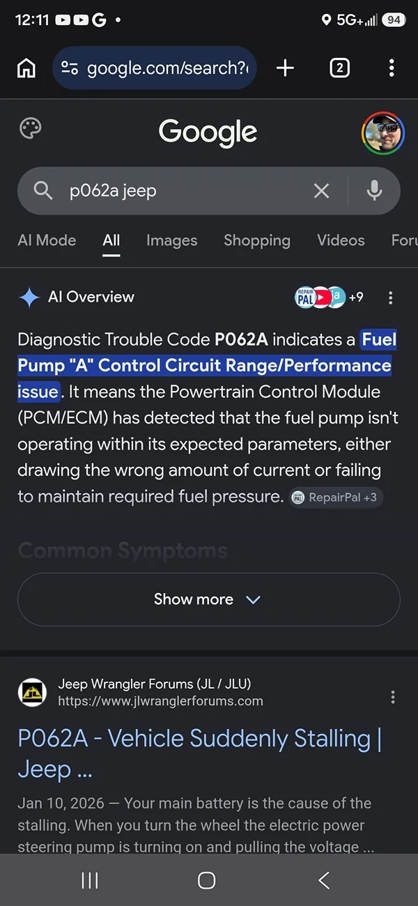

I am not, but here's what I found:
Jeep Wrangler JL 2019-2.0t Jl Screenshot_20260707_121143_Chrom
Jeep Wrangler JL 2019-2.0t Jl Screenshot_20260707_121222_Chrom
