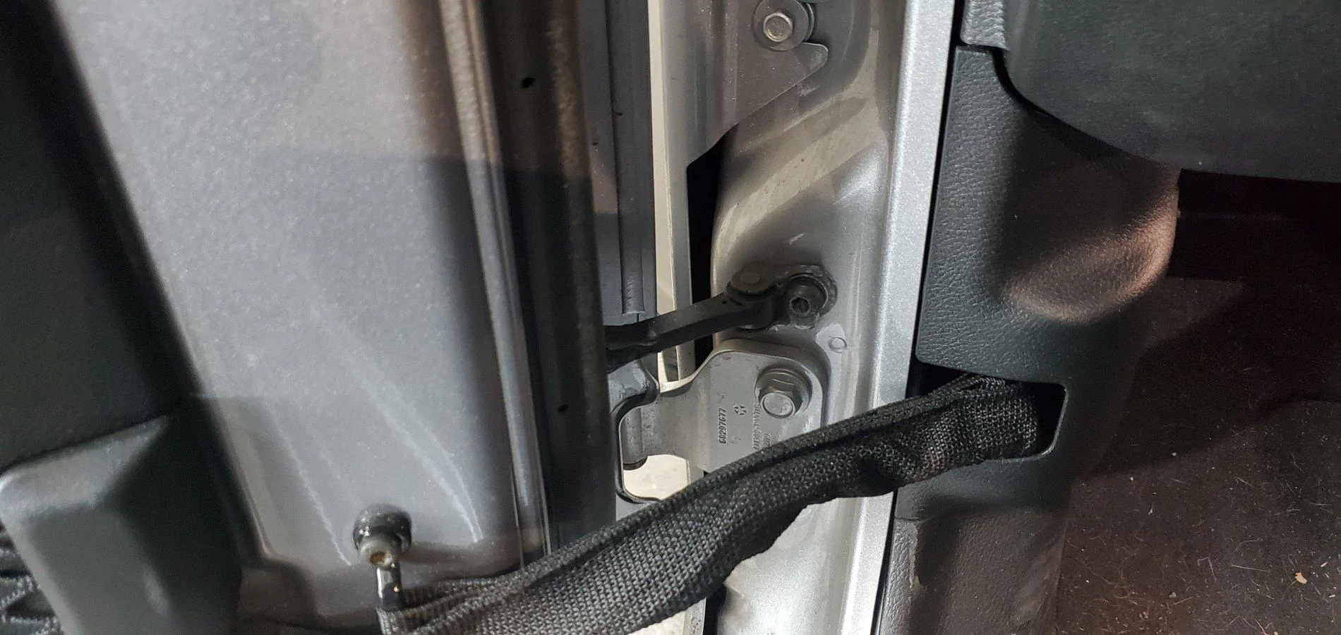

So I went and took a look. The door stops are shoved all the way into the door. Easy to totally miss them. At first, I thought I'd be able to simply pull them out. Nope. Those suckers are in there tight. Saw a video on YouTube where a guy explained how to pull out the stops. Worked, but it definitely took some muscle. The wife is now happy!
