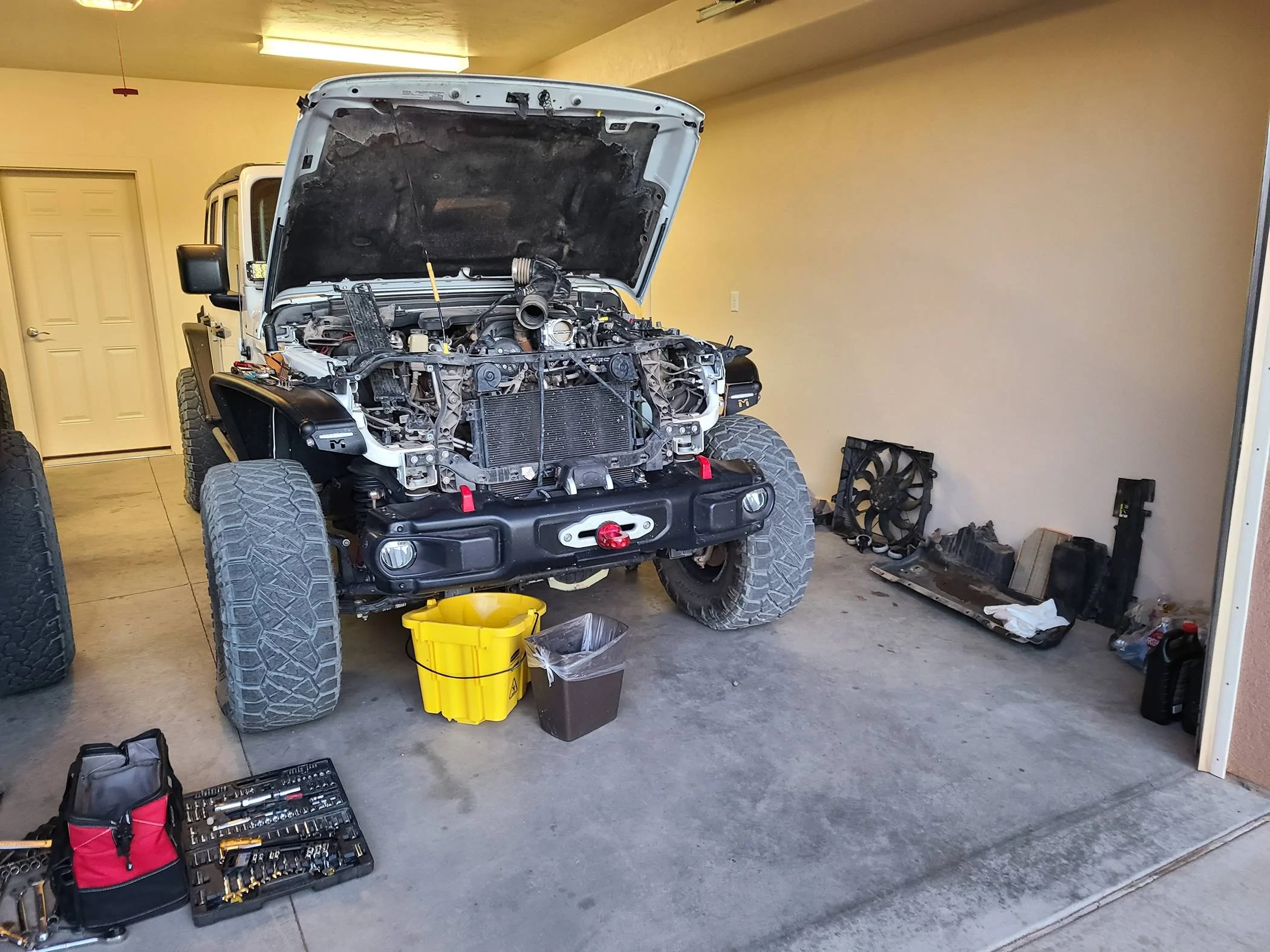

I just did this twice in a month. My winch is pinned against the grill.
The reason you need to get the grill off is that there are 4 bolts holding the condenser to the radiator that need to come off. The heads of those bolts face forward.
I believe this is the reason the 2024 model year has a grill redesign, to accommodate the Warn winch option. There is a bottom piece on the 2024 grill. I haven't really looked into it, but it's on my long list of things to do eventually.
