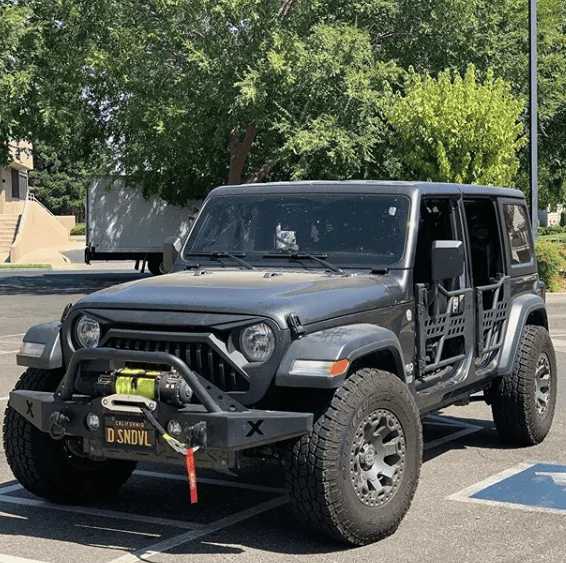

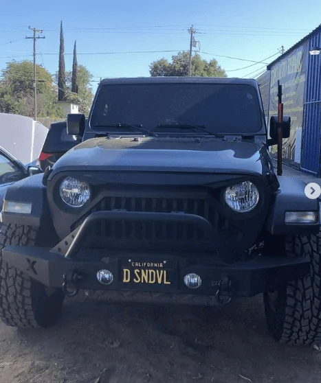

and here's a pic of my baby now that i've added a few more mods
Jeep Wrangler JL 2018 JLU overheating Screen Shot 2019-08-26 at 8.32.49 PM
Jeep Wrangler JL 2018 JLU overheating Screen Shot 2019-08-26 at 8.34.01 PM
Might be the grille restricting airflow..
