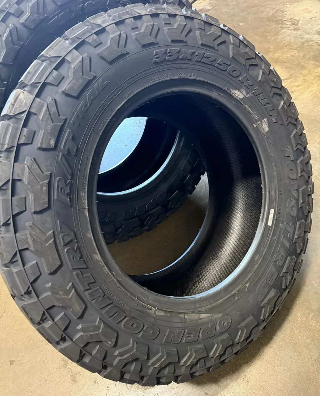

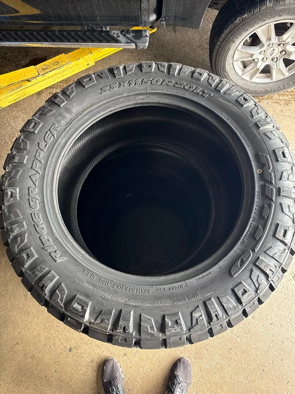

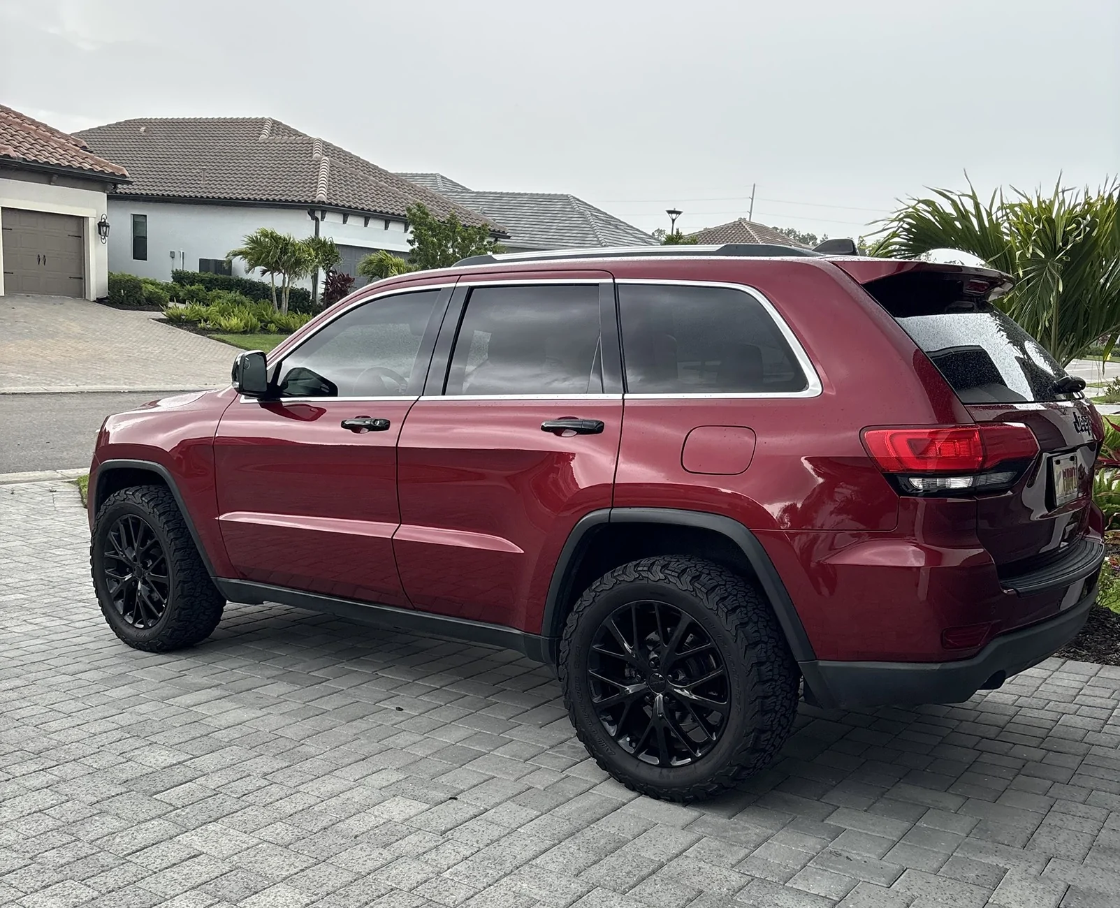

I was dealing with the same thing, building a 14' Grand Cherokee. 2.5" lift and 33's next week. Has a set of badass Dodge Durango blacktop wheels with a set of K02'S that I love, BUT I want a beefy tire so I am ditchin the 20's for 18"s. Can't run 17"s Hemi truck and the front brakes are too big. Go with the 17's man!! The side wall diff from 20" to 18" is significant, 17" even more. More side wall more cush for a better ride.
