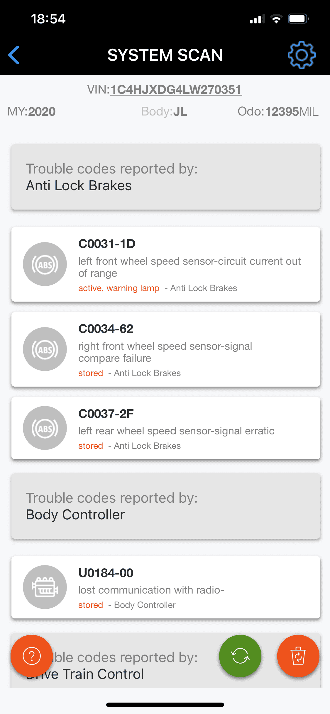

Gentleman so i ran the scanner and the attached wheel sensor data came up. am i to read the info as i have the right rear is bad n left front possibly n left rear
Jeep Wrangler JL 20 JL Service Lights 7DE22C4D-DA0F-4483-A1B0-42833AECEC20
mwilk012
Mar 10, 2018
11,003
11,338
Oklahoma
2018 Ocean Blue JLU Rubicon
Service
3 failed abs sensors all at once? Ain’t happening.

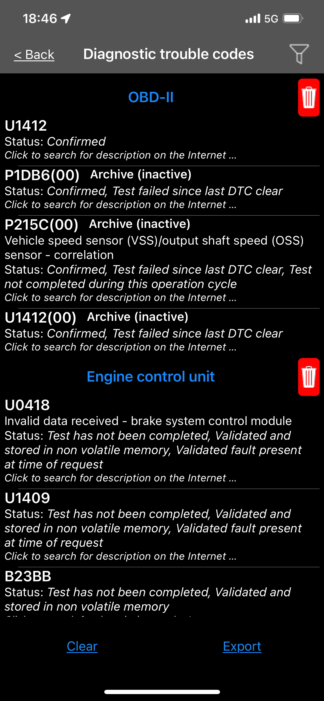

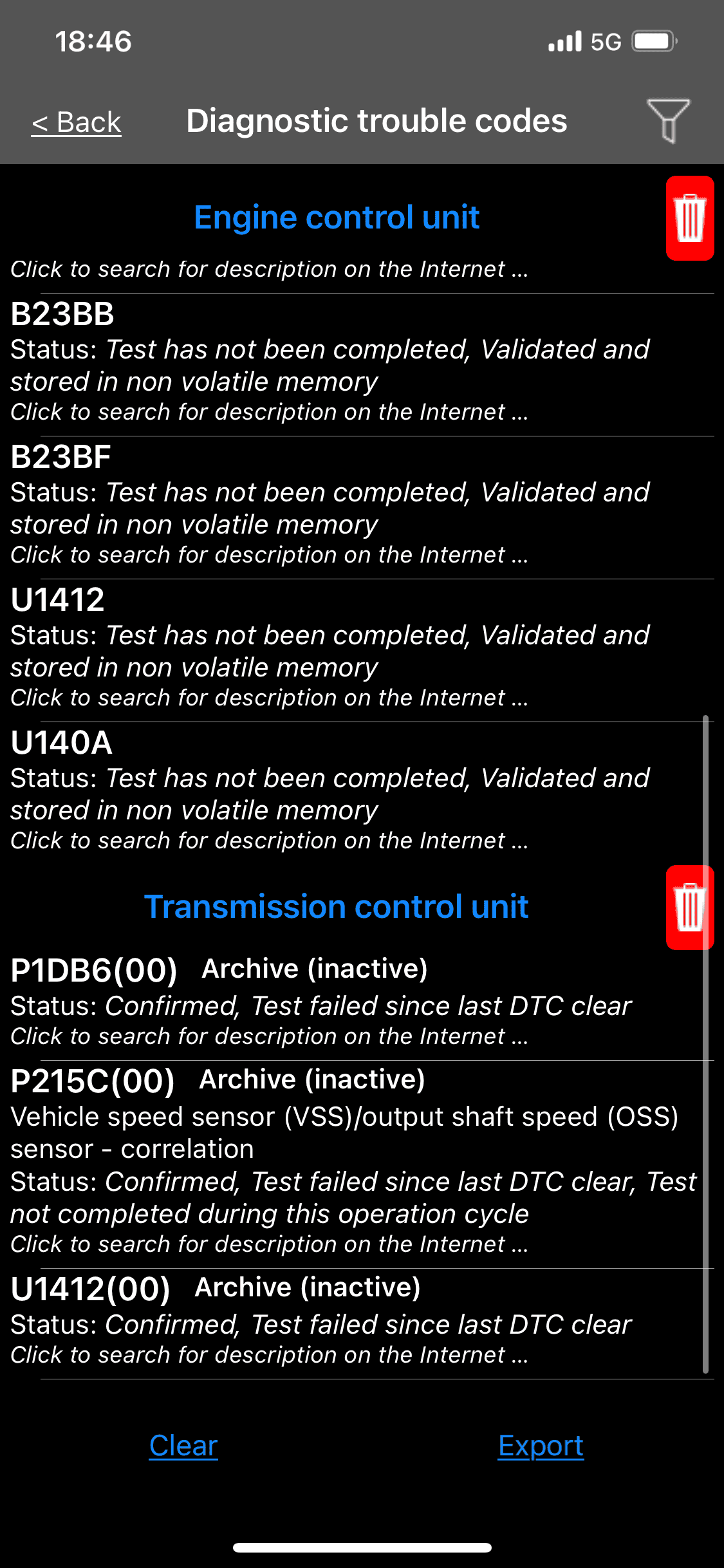

Well ran scanner again today and got the following:
Jeep Wrangler JL 20 JL Service Lights 7FD58EB2-6145-4908-B3AB-116DBBA57C03
Jeep Wrangler JL 20 JL Service Lights E63F9F12-AC56-4910-ACAB-35EDA277AC6D
