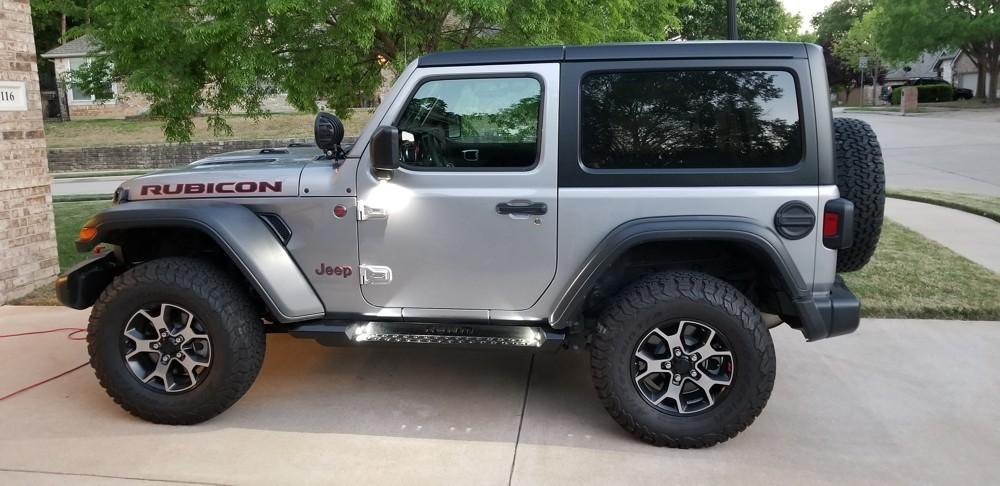

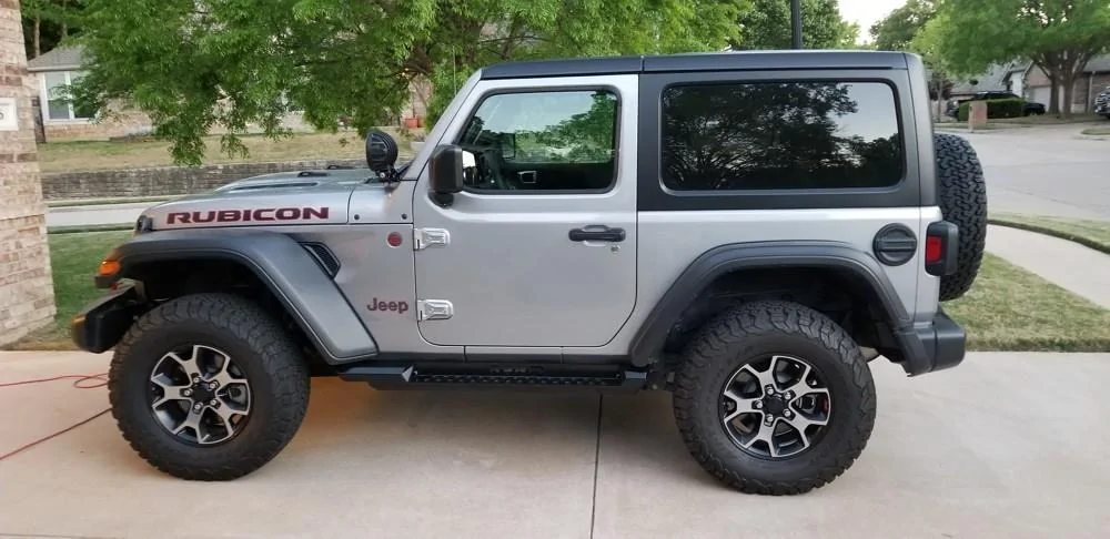

I finally had the chance to install my ROAM slider/steps. A few weeks ago, I installed a rock light underneath each of my mirrors to act as puddle lights. Combined with the LEDs that come with the ROAM sliders, there's plenty of light when you open the door or hit the unlock button. Now that i have the sliders on, I'll install the other 8 rock lights that came with the kit underneath.

They look VERY nice. Did you have to remove factory rock sliders ? Where did you buy ?
What is the cost ? Are they hard to install ? This info will help me as I love what you have
and would like to install these on my Rubicon !!

The factory rock rails have to go (takes about 10 minutes a side to remove them). I bought them direct from Roam (here's a link to the 2 door slider/steps: http://www.roamoffroad.com/product/roam-jl-rock-rails-jeep-wrangler-jl-2-door-rock-sliders/ ). The cost was $499 + shipping (and, if you live in Texas as I do, +taxes). They weren't really difficult to install, you install three braces on each side- two go right on the frame using flag nuts that fit inside the frame and one uses two bolts to either side of the frame mount (you do NOT have to remove the dreaded frame bolt to install these steps).
I really like the look, and they come with the LED lights (which you can splice into your interior lights to come on when you hit the unlock button on your fob).
