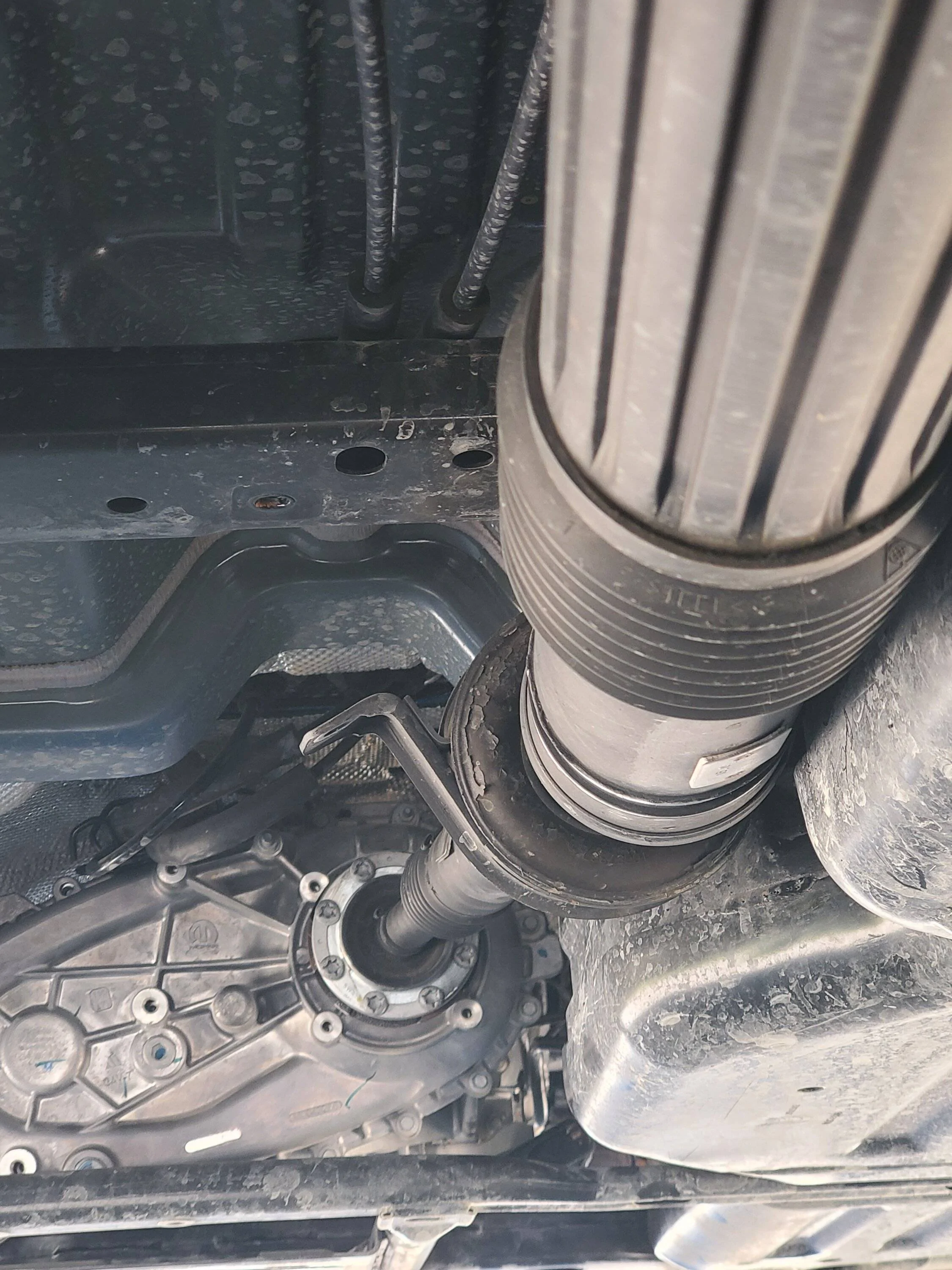

So I got my 19A recall done, 2023JT 88XX miles. Had them pre order the kit, once it arrived turn around was a day. Picking it up, clutch pedal squeaked like a rusty door hinge, and hand a tight springy feeling. Was told normal operation until new clutch and parts got broken in. Well 5 miles down the road hear a bunch of noise, the carrier bearing wasn't secured properly so the driveshaft was just wobbling about. They towed me back and reinstalled it. Then the next day after 25 miles clutch pedal went completely to floor with no return, shifter just moving around not able to find a single gear, and leaking fluid. Two tows in two days. 2nd pic is a list of what actually got done for the 19A recall. Wanting for Monday to hear what needs to get fixed

Sounds to me like you need to find a new dealership to get the work done. It seems that the one you took it to has the 3 Stooges working in their service bay...

Looks like they failed to tighten the carrier bearing on the drive shaft. Must've been hand started then vibrated loose. Surprised it wasn't clunking like hell the second you put it into gear. Who knows what kind of internal damage that caused
