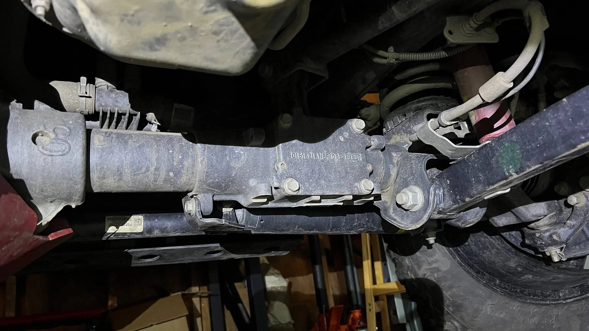

I guarantee you're going to break the Rzeppa joint at those angles. You need to replace it with something.
I have wheeled mine a ton on the rocks. I have a Clayton 3.5 and the 3" lift fox 2.0s. My front shocks are over 28 extended. The flange on my rzeppa is mushroomed everywhere, but it's still kicking after 30k miles.
