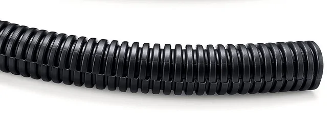

For the record, I do not suggest taping over or zip tying that disconnected Aux Neg cable you disconnected from the Main battery Neg..
I suggest guys/gal's just use a short length (5-6") of wire loom tubing to fully cover the Neg Aux cable end when they have the Aux Neg cable disconnected from the Main 's Neg terminal. This loom just slides on or off as desired..
Now, get a wing nut and leave on that terminal in case you ever want to easily reconnect the Aux battery Neg. to it.. Some guys will want to do this if they plan to use the Aux battery (if healthy) as a back-up start battery.
Wire Loom Tubing- Split Loom Cord Protectors, Flexible Wire Conduit Automotive, Black
Jeep Wrangler JL 13.4 Low Voltage Warning loom

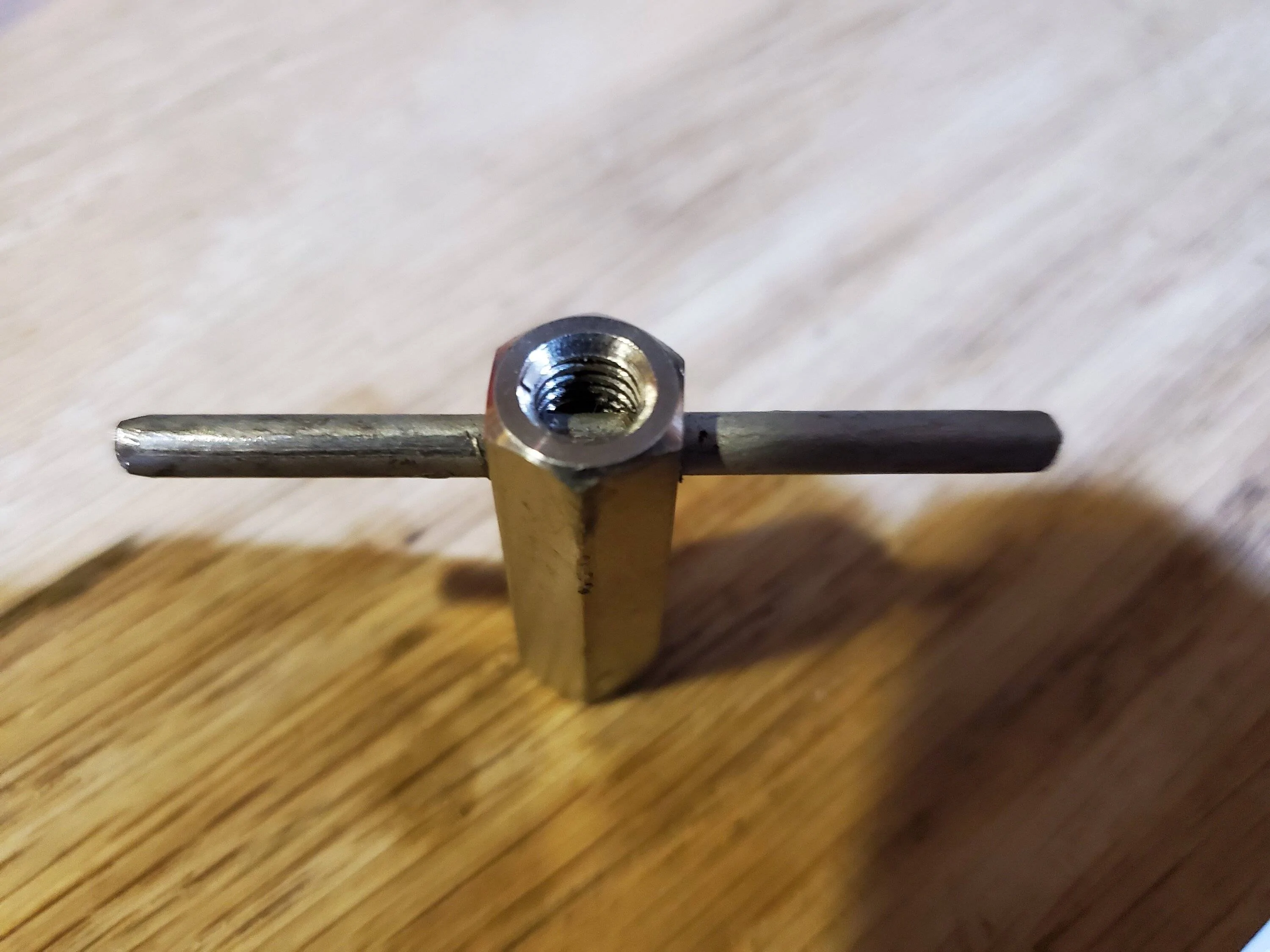

Wing nuts ... Sizes you'd use on the Main Batteries connections..
Jeep Wrangler JL 13.4 Low Voltage Warning wing nuts
Or you can make your own quick disconnects and use them instead of wing nuts..
Jeep Wrangler JL 13.4 Low Voltage Warning 20201111_122151
