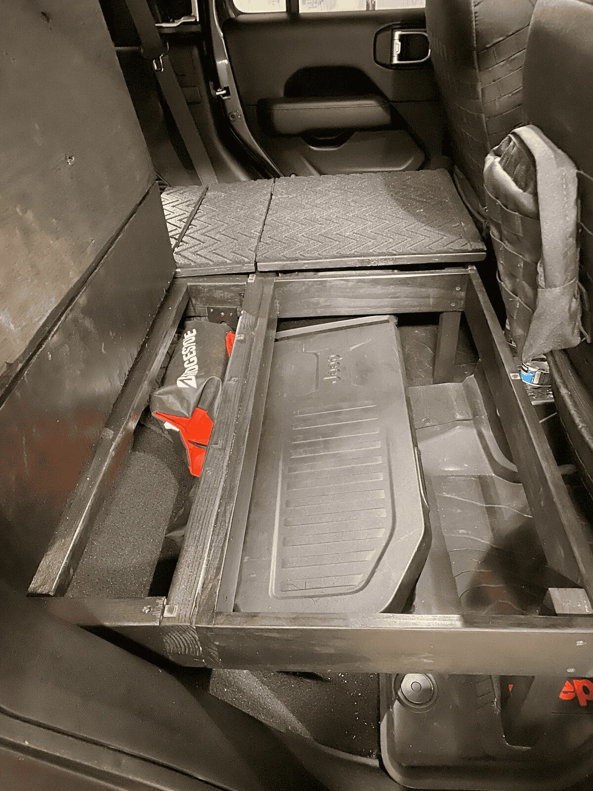

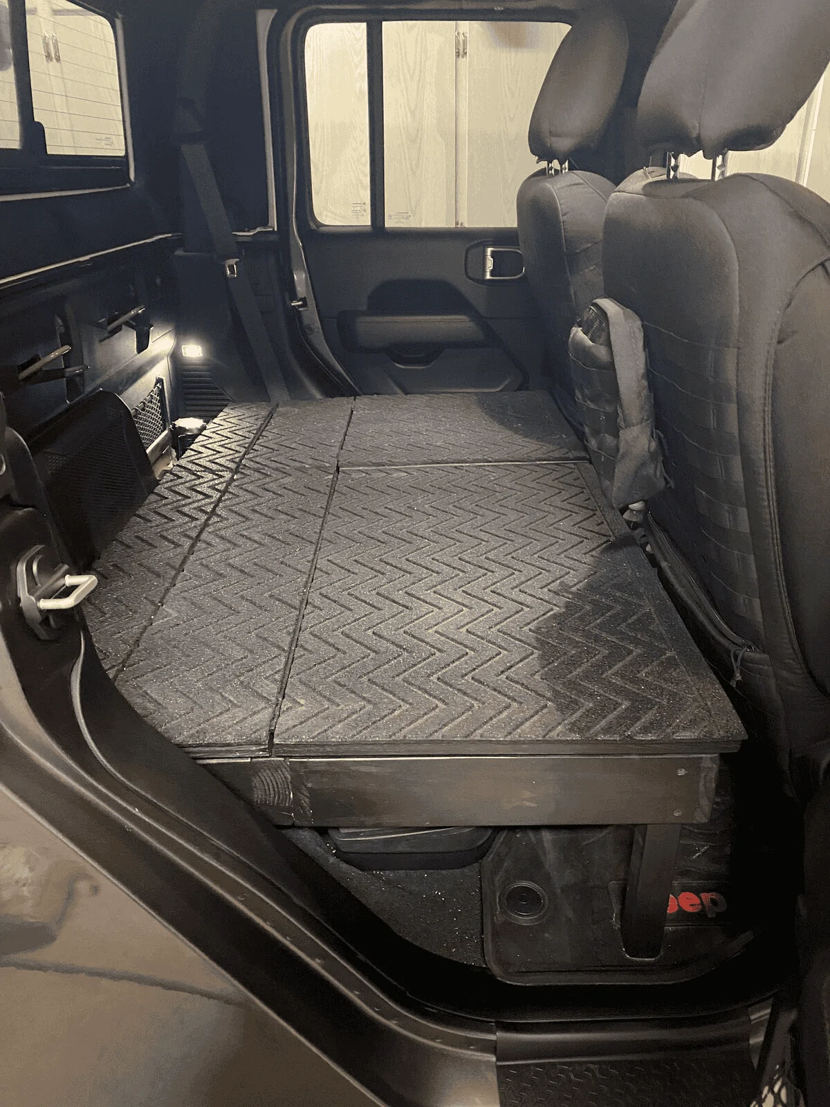

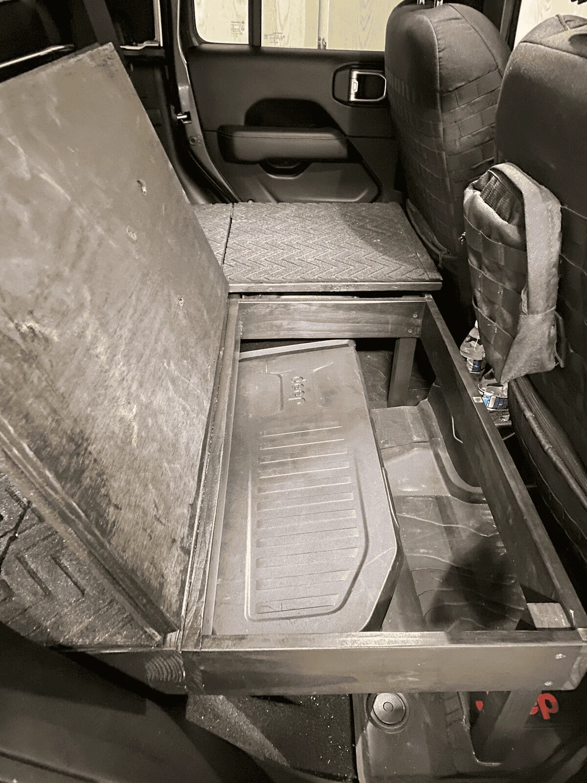

Here's the rear seat platform I built for my 2020 Gladiator and I designed it with dual hinges on each side to enable me to have access to the area below the platform and the underseat factory storage compartments.
