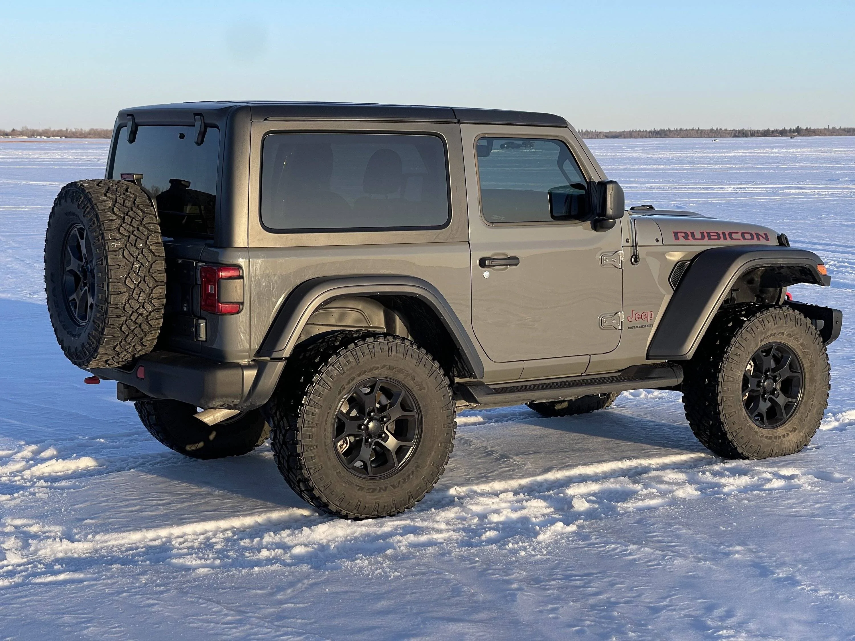

Looks goods. I took a set off and put Mopar running boards as I like the dirt gravel protection it gives.
Jeep Wrangler JL Rusty's JLU Off-Road SideStep Rocker Armor Full Installation & Review 446CBA32-29D9-4D04-9296-FB32143EBFC6

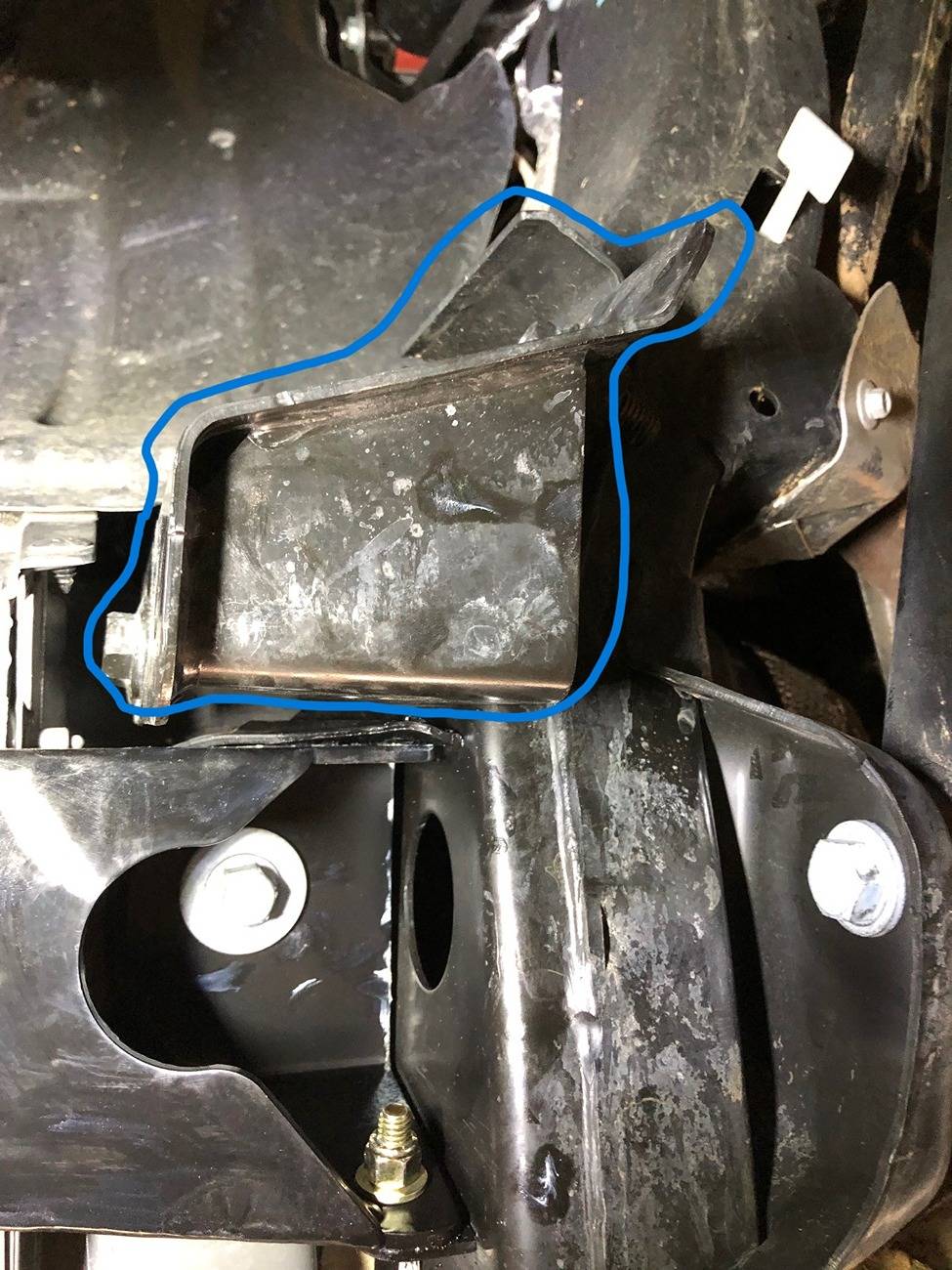

I'm trying to figure out the best way to drill and install the forward-most bolt on the passenger side to finish my Rusty's install. My '23 Rubicon 2-door has a pointless looking metal box in front of the front body mount bracket on the passenger side that's right in the way. Looks like the earlier JLs didn't have this or maybe none of the 4-doors do. I tried to remove it but the top bolt in the second picture is practically impossible to remove. The body would probably have to be lifted off the frame to get that bolt out. I'm thinking my only reasonable option is to drill all the way through both sides of that stupid box with an 8" or 12" drill bit.
Looking in from the passenger side...
Jeep Wrangler JL Rusty's JLU Off-Road SideStep Rocker Armor Full Installation & Review IMG_5633

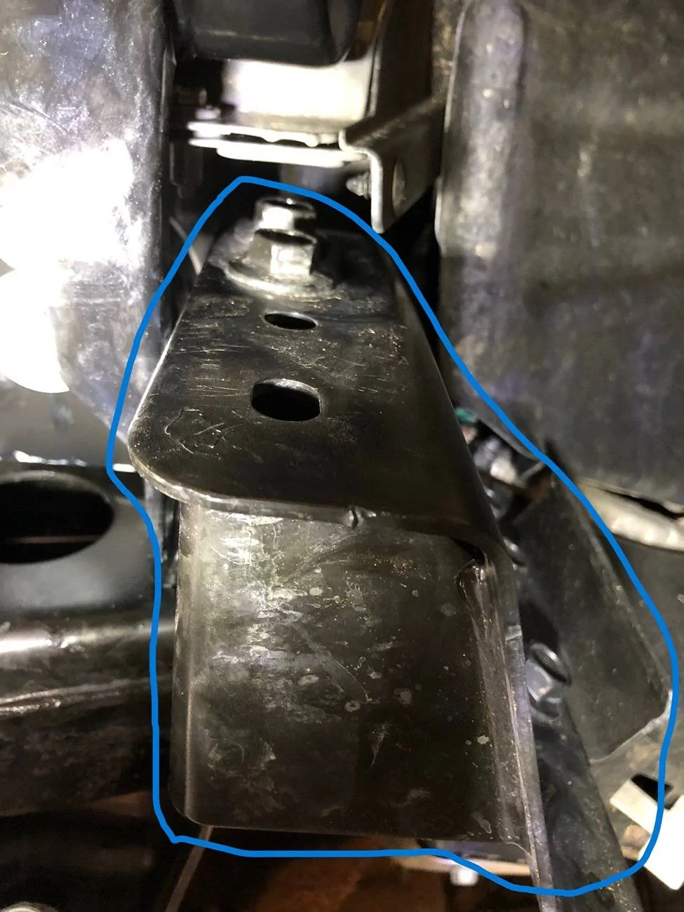

Looking up at an angle...
Jeep Wrangler JL Rusty's JLU Off-Road SideStep Rocker Armor Full Installation & Review IMG_5635

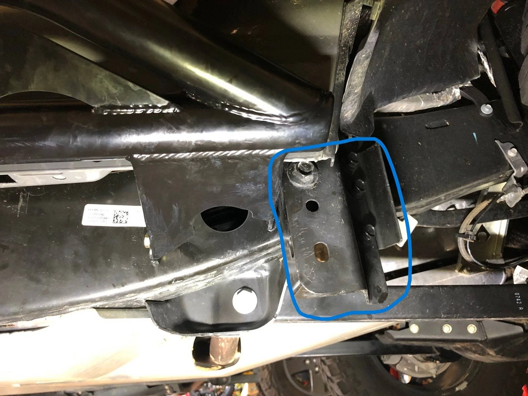

Looking straight up...
Jeep Wrangler JL Rusty's JLU Off-Road SideStep Rocker Armor Full Installation & Review IMG_5637
