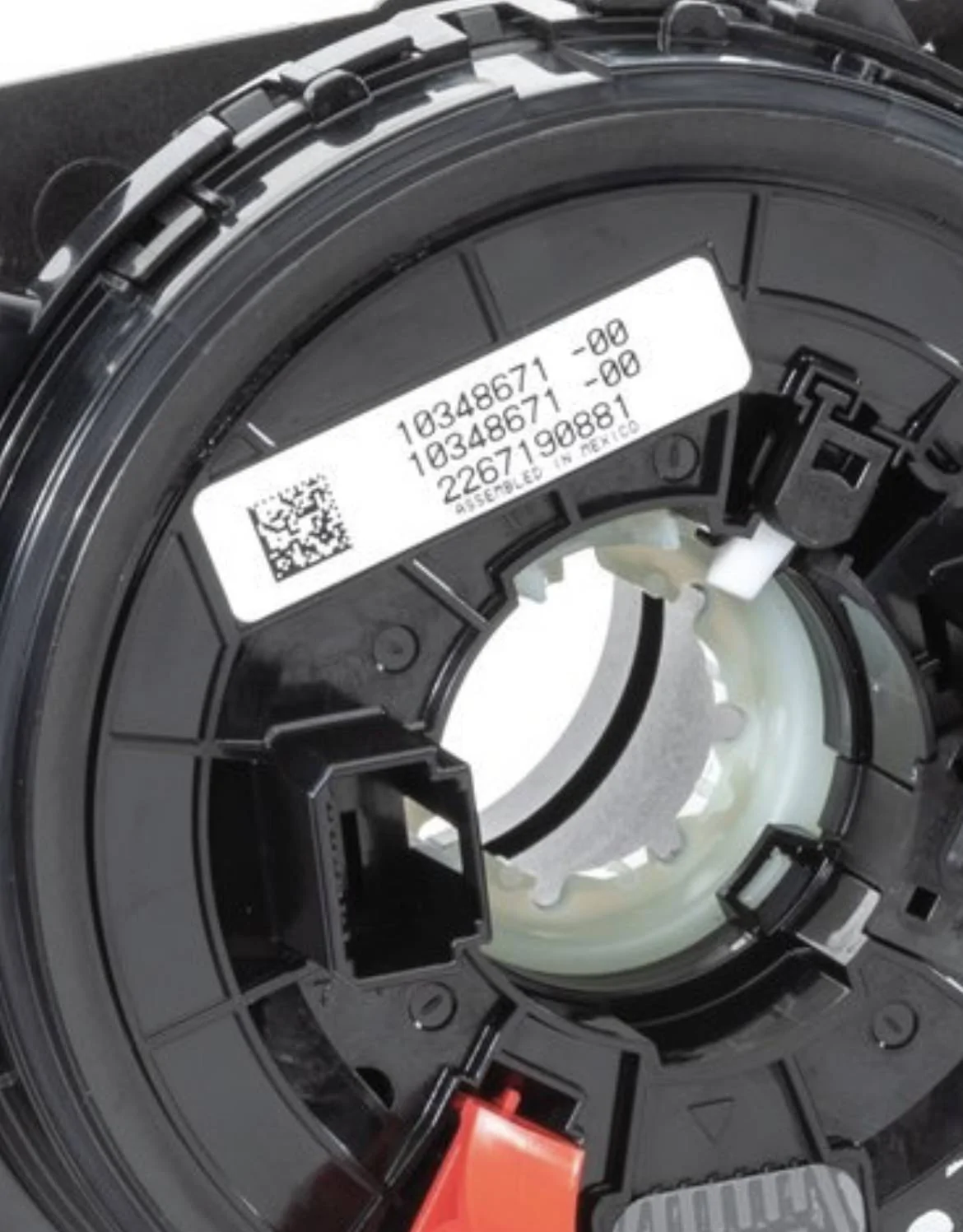

Anyone know the part#? i have been unable to find it on any parts diagrams. Hardtop, rear wiper.
All my dash steering Wheels controls are dead And the dash is all lit up. Assuming probably a clock spring, but the dealer jus5 told me they are booked out until the end of February….TIA

That looks like it could do it, but I really don't need all the wiper stuff. I think I may drive to dealer and ask for details there.

Steering column control module. It’s one piece. That’s the only way it’s sold. There will be many different versions and it requires programming to set up. It’s not something you can do.

I believe it only requires programming if you are adding or deleting features. One for one swap should be fine.

don't know the P/N, but have you talked to your Dealer? there's a Recall for the SCCM.
