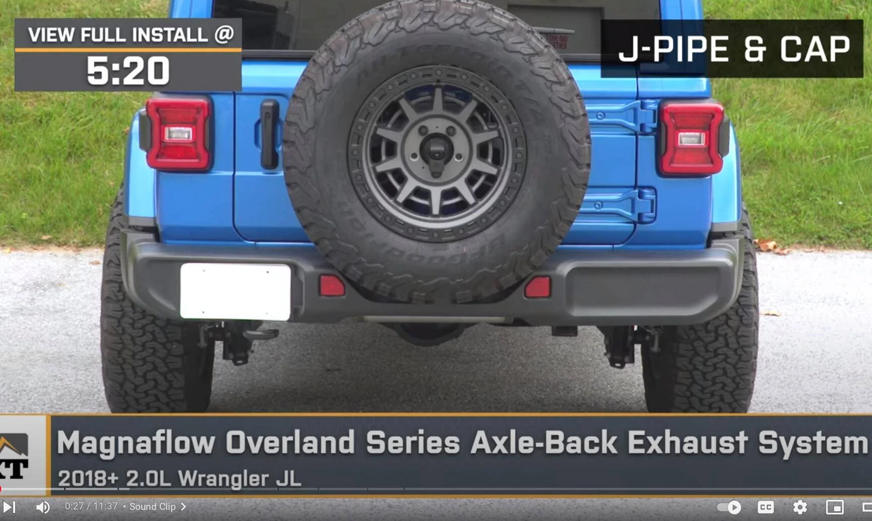

thanks. Been looking at the MF, although can’t get the picture of a French horn out of my mind (someone else’s joke).
After listening to different sound clips of that muffler, I'd probably end up just using it with the cap installed without the extra horn piece. All the configs sound just like stock to my ears. Just thought it would be nice to add later on if it had any drone or seemed too noisy.
And it's not like you or anyone else is really going to see it. In traffic, you might see just a slight bit of the muffler's underside and tailpipe when sitting in a low car, but otherwise, you'd only ever see the extra horn piece when it's up on a lift or maybe coming off of a very steep rock.
