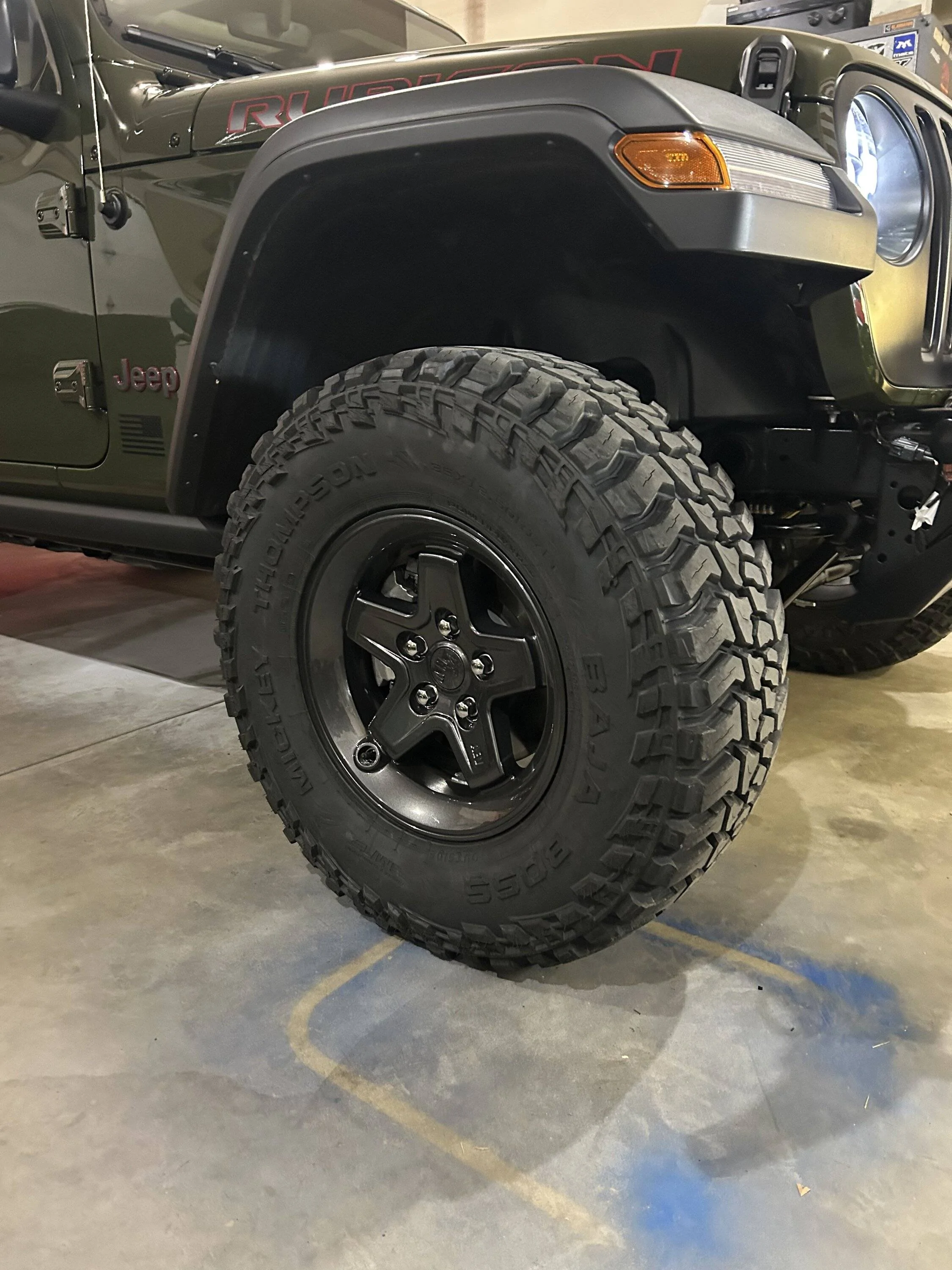

Very happy with selection
AEV Pinter Onyx
Mickey Thompson Baja Boss MT
They look awesome! I've always preferred the look of 5-spoke wheels.
I'm also interested in hearing about how those specific tires handle rain and snow, after you get some time on them. The Baja Boss M/T's are at the top of my list for the next set.

I've had them for over 1.5 years and driven in plenty of snow and some rain with them.
They handle rain very well with the stock siping. Better than most other MT's I've had.
In deep snow, they provide excellent traction. On compacted snow/ice, they handle about as well as any other MT. Not dangerous, but something you definitely need to be paying attention to when driving. I had additional siping added and they now are very predictable and provide good traction on compacted snow/ice. They behave similar to a good set of AT's now, but with the added benefit of being able to move through deep snow.
