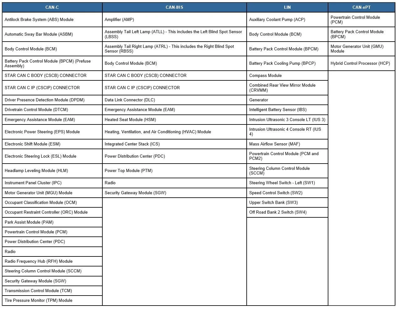

The JL depends on many separate computer modules networked together, to achieve basic functions. You would still need many or all of these. If you want airbags, you need that module and the BCM, which you need for the dash, turn signals, etc
If you want a dumb vehicle, start with one. Or, get a JL tub with no electrics and put absolutely everything in it from aftermarket or donor vehicles.

You'll probably find that modules are multi-purpose in order to minimize cost. Remove a module and you'll probably lose the good with the bad, or disable it altogether. I'm not an expert on the JL, but have experience with electronics hell. I wouldn't expect much of anything to go right.
