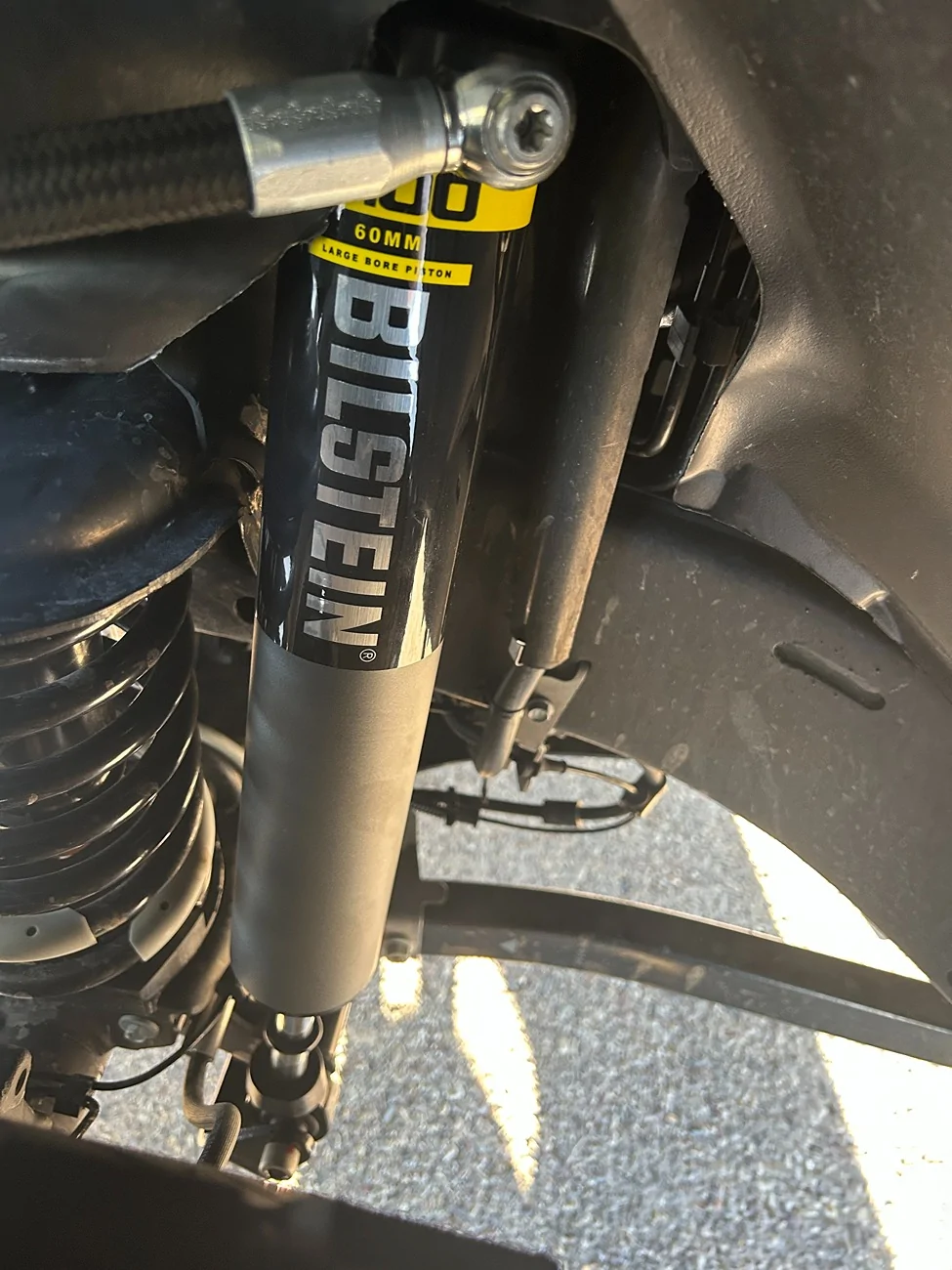

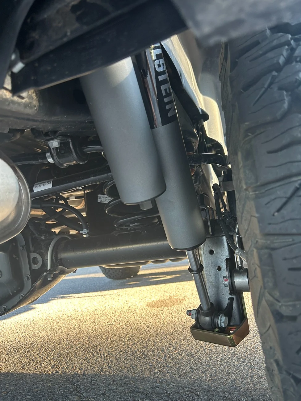

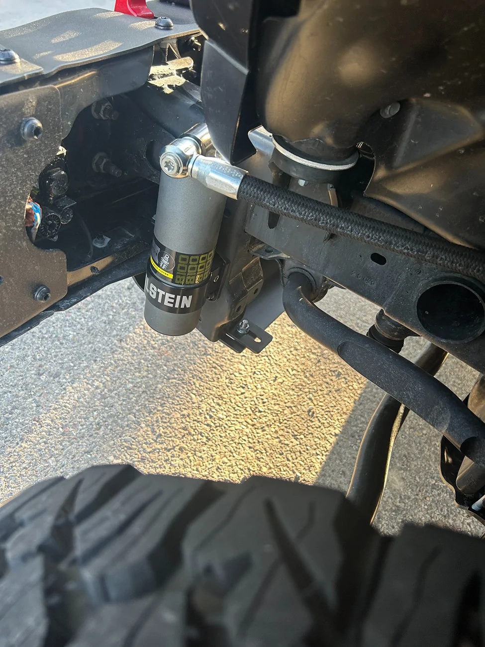

New Bilstein 8100s installed. The ride is a little firmer than stock which is what I wanted. They do have compression and rebound adjustabilty but I think they come from factory set at 7 out of 10 on both setting. It feels good to me so far. These should never Fade now for the kind of wheeling I do. I also added some Metal Cloak rear shock skids.
