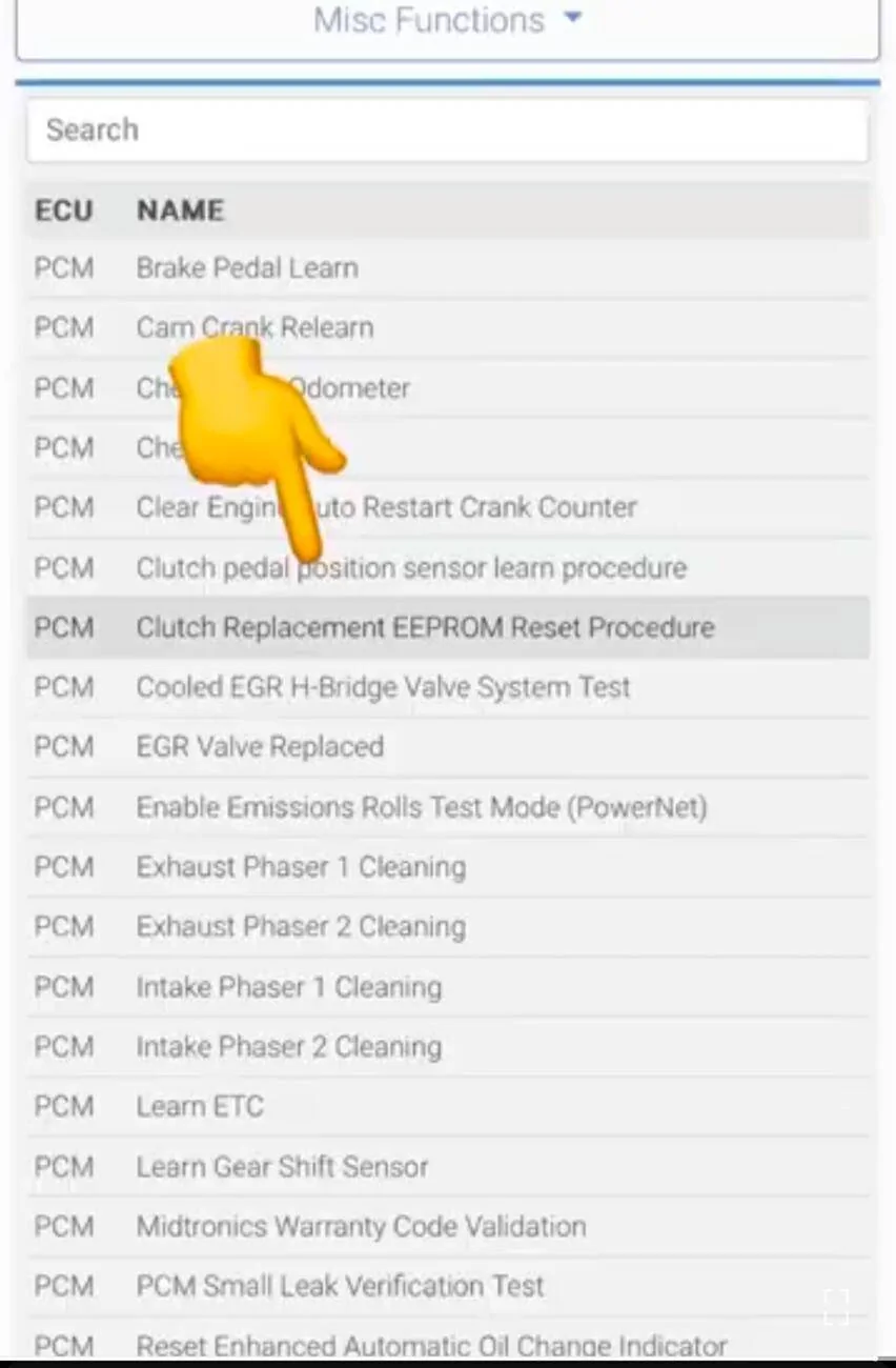

From the video of the tech doing the service, he mentioned different transmission errors. One fix was using the Jeep PCM tool and using this function. He said it wasn't documented anywhere in the procedures, but it seemed to have fixed it.

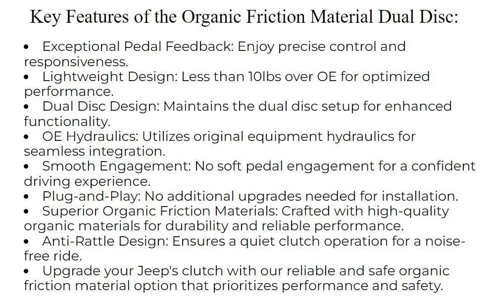

Hey @Powelligator
Here's some more info.
I've read all the horror stories around the recall and issues with re-geared Jeeps
I was turned on to South Bend Clutch as I'm local and was able to Beta test their JL solution. I have to say that I'm flat-out impressed.
I've had the prototype about 6500 over the last 5mos. I've noticed a huge improvement and my wife has as well. It's like driving my old TJ - the clutch is great! Feel and function like a clutch should.
I swung by their page today to see if it was available for sale and it looks like they're having a give-away that goes for the rest of the month if anyone is interested:

It's even more expensive than everybody else's proven solutions. If somebody wins one great but there is no way I'd buy it.
