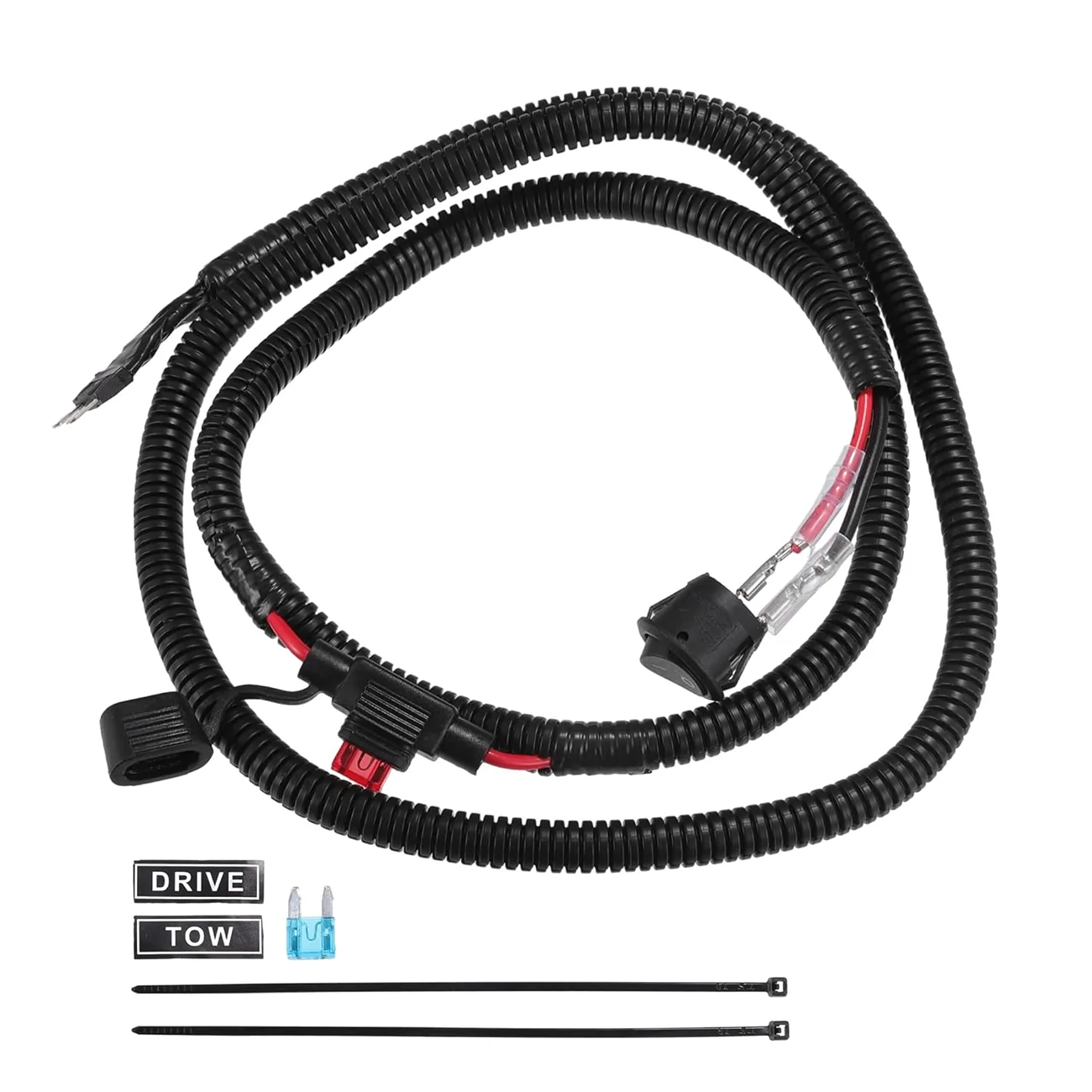

just pull your fuel pump fuse or install a kill switch for that fuse https://amzn.to/3WyB1GF
it's much cheaper than the relay kit

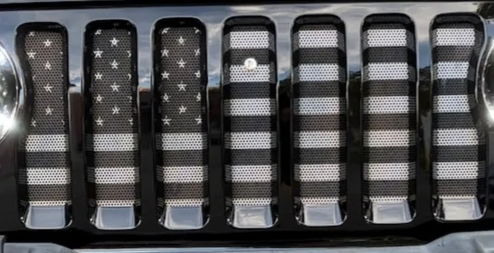

plus you get the added bonus of your starter making noise when thieves try to crank it but it won't start. Also replace your grill with the metal mesh grills. https://amzn.to/46NnPUv
Jeep Wrangler JL Wrangler Break-Ins IMG_2441

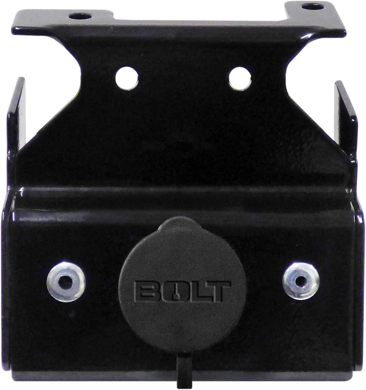

It took a good while to drill a hole through it for my hood lock https://amzn.to/46NXqpE Jeep Wrangler JL Wrangler Break-Ins 1760201000908-31
