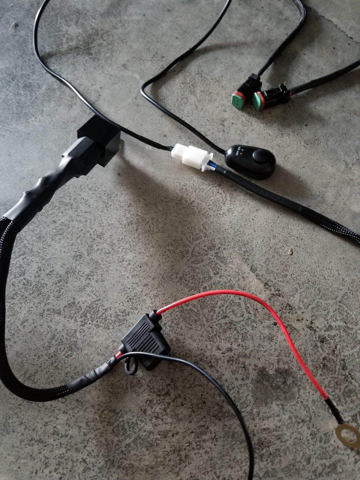

on the JK, I had to use the supplied wiring harness for the ditch lights and light bar when setting it up.
With the factory aux switch setup, would I just clip the ends at the lights (cut the pigtails off) and run both red to the aux # and both black to ground? I won't need all the wiring they send with the kit, right?

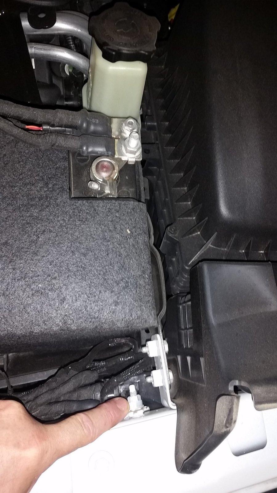

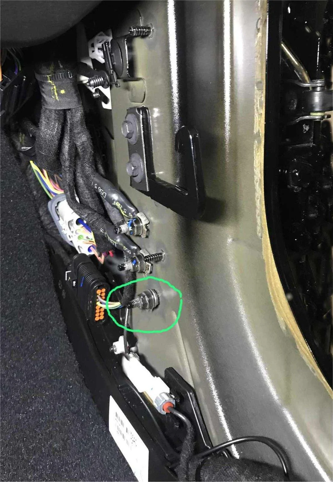

Ryan... In general, if you are using a kit harness that has an inline fuse and an on/off switch you would cut away the switch because the # 1 or 2 or 3 or 4 Aux wire is switched via the console Aux switches. You best bet is to keep the inline fuse, even though the Aux connection is already fused.
SO, with that said ... Your red from the light harness attaches to 1,2,3,4 Aux wire and then your black wire attaches to a ground point. That is it. Remember, in Uconnect settings, go to Aux Switches and set-up the Aux switch you plan to use.
Make sure you have a good ground. Most guys here, that had little glitches when they used the Aux connections were related to them having a poor ground. Be sure to clean paint off where you will be grounding to.
Look here to where the finger is pointing for a ground point by the battery:

Here is a ground point in the passenger foot well:

right...i was going to just cut the switch off, and wire the 3 wires directly to aux 1 or 2 in the engine bay and use the inline fuse and relay provided....but my hold up is there are three wires to the provided switch and one to the aux. I didn't know how that would work. so i "figured" (i can put lifts on and all kinds of stuff, but anything electrical i turn into a monkey) the factory has a relay and fuses somewhere and if I just cut them off before all of the stuff and wired them right to the aux wire and right to ground

They are rough country light cubes. I think if I just cut em off at the end of the cube, each one, I'd connect the two red to the factory aux line and the two black to ground.
I dont think I need any of the harness they provided.
And I should be ok on the 15amp switch.

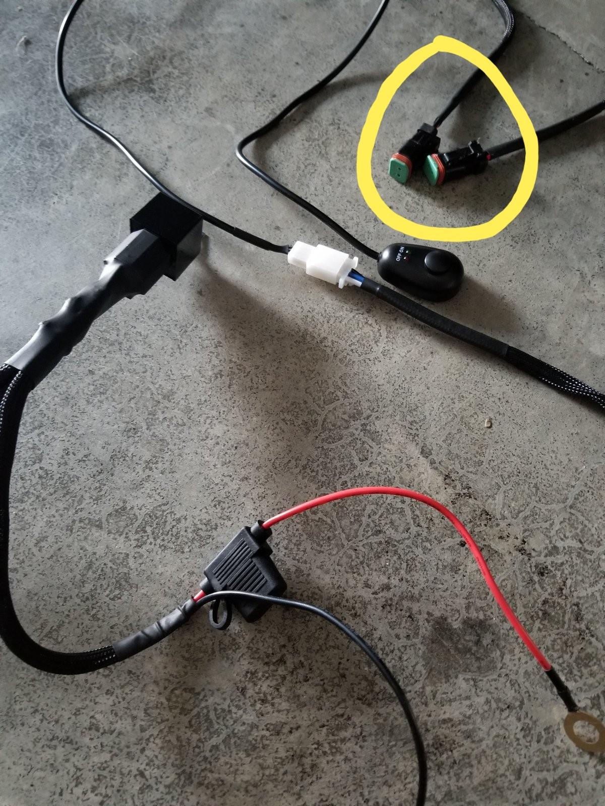

The wiring harness supplied with the relay and fuse was not really needed with the new JL setup with the factory aux switches. With the JK, all this was pretty necessary and I just had to connect it through the firewall and use a different switch. That is where I was overthinking it. After realizing there were two wires (pos and neg), it was much easier.
After installing the lights, I just connected the pigtails to the lights themselves ( the circle in the pic) , left enough length to connect it to the aux line (I used aux 3), cut the lines there. I discarded the fuse, relay and switch. There are just two wires from these lines, a red and black. So much simpler now. I connected the two red wires to the aux 3, and the two black to a ground. I can take more pics later.
It was a clean install, once i simplified things. The wiring kit they sent had braided lines, and they tucked up near the top and rear of the engine bay nicely.
