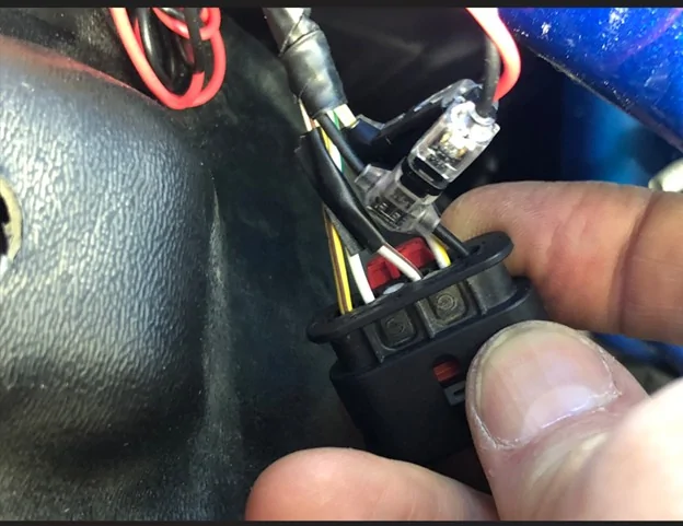

The lights only have 2 wires: one red and one black. The OEM wiring bundle for the turn signals on the Jeep have 5 wires. Per the photograph, you're supposed to tap into 2 of the wires as shown. When I did that, the fender lights were always on and didn't blink when the turn signal was activated.
The order of the wires from left are: black, white/yellow, white/brown, white, and yellow/brown.
Jeep Wrangler JL Fender Vent Lights Wiring - Question Instructions
I kept the black-black connection and re-did the red wire (you can see the electrical tape to repair the damage, the red t-tap was re-used). I connected the red wire to the white/yellow one however the lights didn't work at all.

What the lights do will be a function of how you wire them. If there are only two wires, one is a ground. Connect the other wire to the turn signal wire in the fender, and the light will be a turn signal. Connect it to the "marker" wire, it will be a marker light. (No flashing)
If you only have those two wires, you have to chose how you want the light to function, and wire it accordingly.
