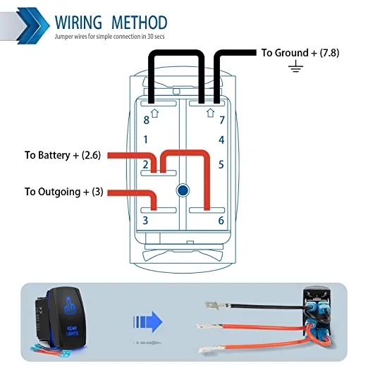

The last end has 4 wires that come out. 2 (green and yellow) are unused for the lockers. Then I have the red and black. I am pretty sure the ARB rocker switch I have coming has 5 pins.
If I follow the image below, is that correct? Meaning if I take the black wire from the ARB harness, and splice it to two wires that go to the 7 & 8 positions in the diagram. Then take the two that come out of 2 & 6 and run those to a single fuse tap that will go into a fuse that is only powered when the jeep is running (like the heated seat fuse), and then finally run the red wire from the harness to the 3 spot.
That is all correct, right? 7 & 8 together being ground, 2 & 6 together being supply, and 3 on its own being load.
Last question, what size fuse should I use? I know it is only powering the relay and not the compressor, so should it it be 5A? 10A?
